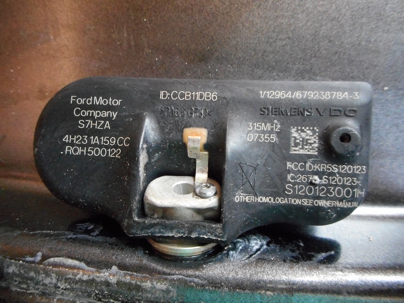

The TPMS for a 2009 Jaguar XKR comes in 2 frequency's.....315 MHZ and 433.92 MHZ
What is the correct frequency for the 2009 Jaguar XKR here in the USA.
Mine are 315 MHZ and I am questioning whether or not I was sold the wrong frequentcy.
Can anyone help. I see the OEM Jaguar Part # is: C2Z15016
Answered my own question: 315 MHZ for the USA.
I went out to my garage and pulled my old Jaguar OEM Selena Wheels out of the wheel boxes and sure enough 315 MHZ.
