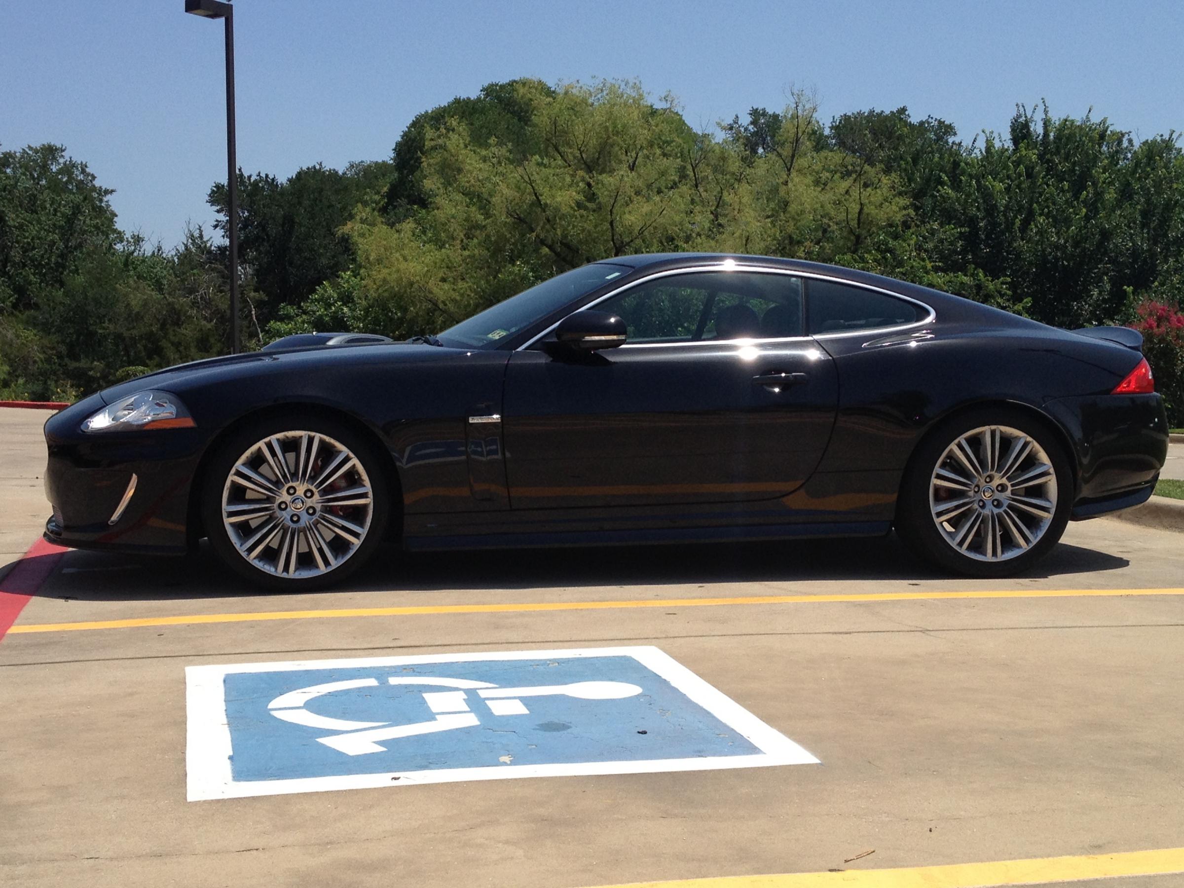

I'm not sure of the name of the wheels but I have the 175 edition. I mounted the 295/35/20 today and I like how it fills out the wheel well.

They're Kasuga rims - 9" front, 10" rear. I believe the standard rears are 285/30/20, so by going to 295/35/20, you've increased the rolling radius by 5% - that means your road speed will be 5% higher than the speedo indicates. If you have a GPS, it would pay to check indicated vs. actual speed, just to be sure you don't start picking up tickets. Also, you will have increased the ride height by 0.7". There's a useful calculator here:
Visual Tyre Size Calculator | Kouki Tech
My guess is that, with the taller sidewalls allowing more tyre flex and the increased ride height, you may find the rear a bit more 'loose' than before, but I don't know how pronounced the effect will be.
Can't help but notice your calipers are not "red". The 175 came with the optioned red calipers. Where the calipers replaced? Would like to see some pictures of how the over sized tires fit. What brand of tire did you go with? Did you check out other brands?
Just zoomed in on the wheels and noticed the red calipers (they look like they have a lot of dust on them). Sorry for the confusion. Pictures of over sized tires would be appreciated.

Thank you for the responses guys and I'm not new to cars and how tires sizes change speedo, performance etc. I just wanted to know if the tire is too tall and would cause issues or rubbing because max tire diameter on our cars is listed by discount tire as 27.3" and the 295/35/20 is roughly 28.2".
So far I haven't had any issues with rubbing and I love the look. I don't want to lower the car and the taller tire closes the fender gap a bit so it looks much better. Plus I can't stand when the front sidewall is thicker then the back even if only by a quarter inch. Ill post close up pics in a few min.

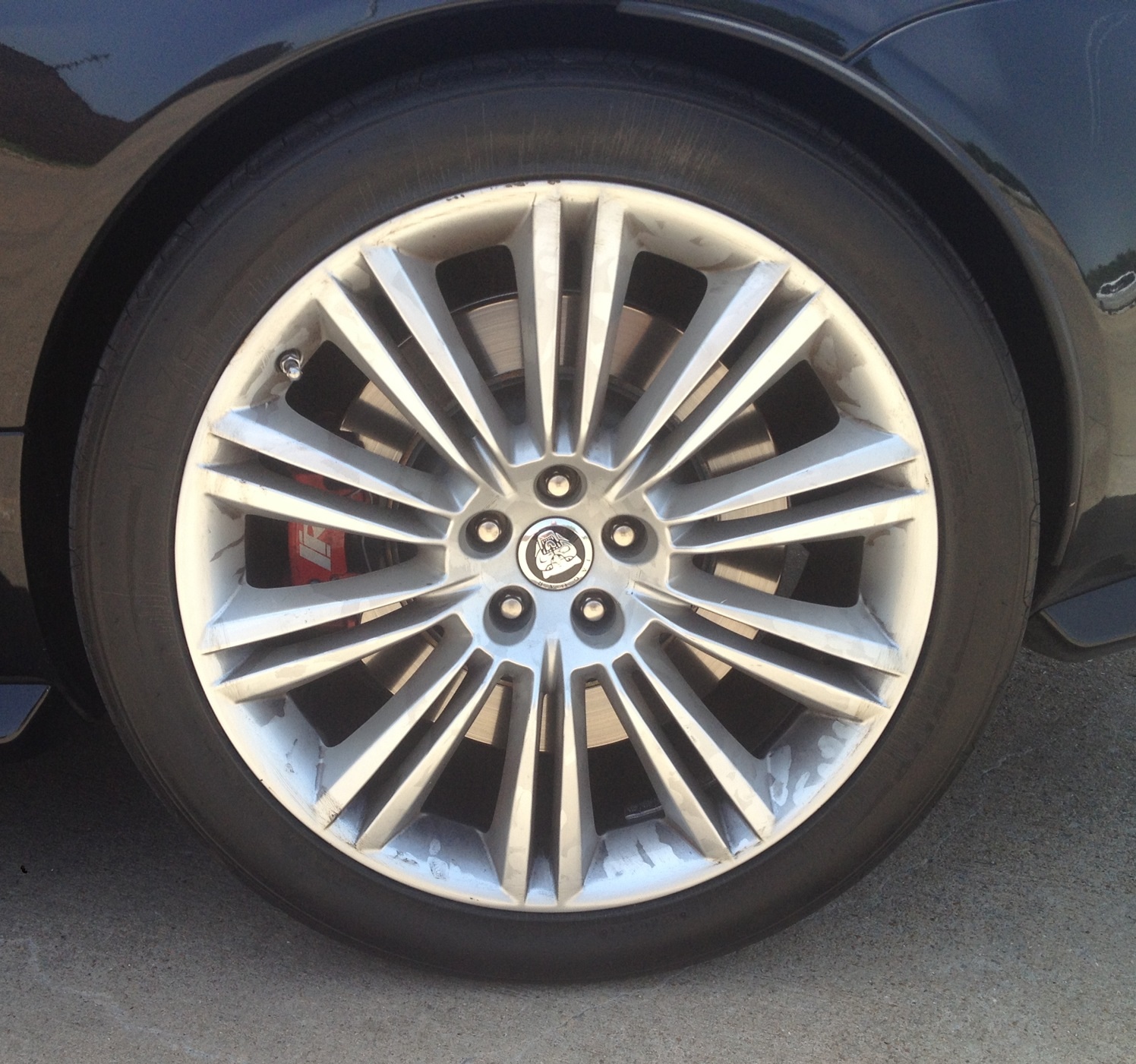

Here's a close up of the rear tire 295/35/20
