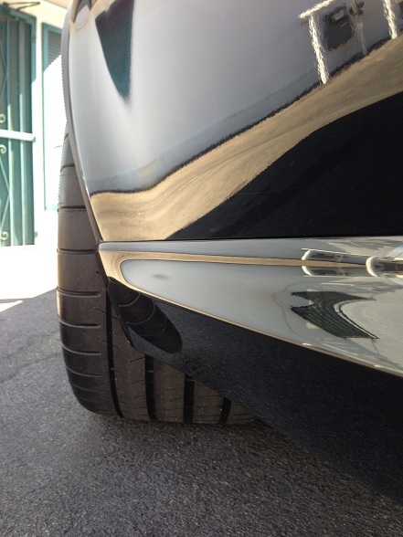

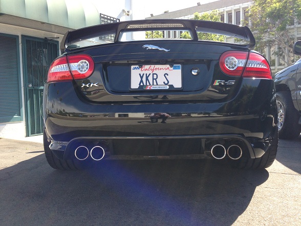

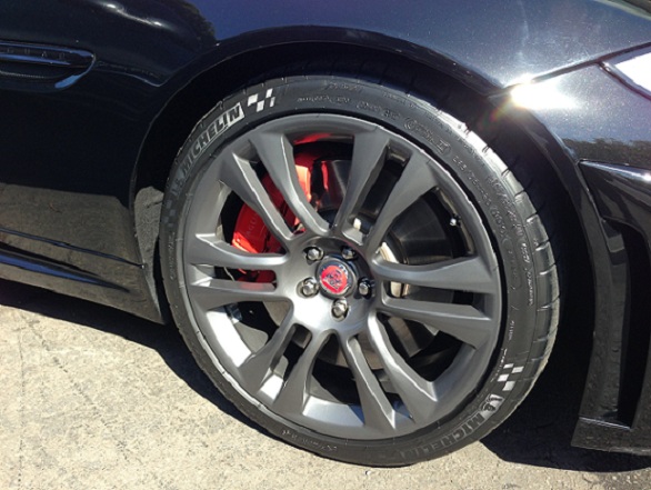

Photos (such as they are) are attached....my driving ability is hopefully more advanced than my photographic ability! I was on vacation last week, driving up the California coast on Highway 1.......but before you become too jealous, I have to admit it was in my wife's SUV (for cargo carrying capacity) vs the XKR-S that that road was made for!
Attached Thumbnails Tire size question..-img_0349.jpg   Tire size question..-img_0350.jpg   Tire size question..-img_0351.jpg   Tire size question..-img_0352.jpg   Tire size question..-img_0353.jpg

Do they project out past the rim a bit more than the P-Zeros? Might help ease my paranoia about kerbing the durn things - we have narrow streets here, so I need to get close, but not too close, to the kerb.

Originally Posted by XKR-S San Diego
I recently had Michelin Pilot Super Sport tires installed on my XKR-S: 265/35/ZR20 and 305/30/ZR20. The 10 mm extra width both front and rear over the stock size not only looks great, but fits without any clearance problems.
The overall diameter of the new tires are only 0.1" greater in front and 0.2" greater at the rear. Because the new tires are between 99.75% (front) and 99.25% (rear) of the stock size, speedometer error should not be a concern.
Tire weight is the same for the front tires and just 1.5 lbs heaver than stock for the rear, so the active suspension and ABS calibrations should not be adversly affected.
As expected from their use on prior vehicles, the Michelin's are both quieter and slightly more responsive then the Pirelli P Zero's that were original equipment.
The front tires now exceed the rim by almost 3/8", and the rear by almost 5/8".....a great improvement!
