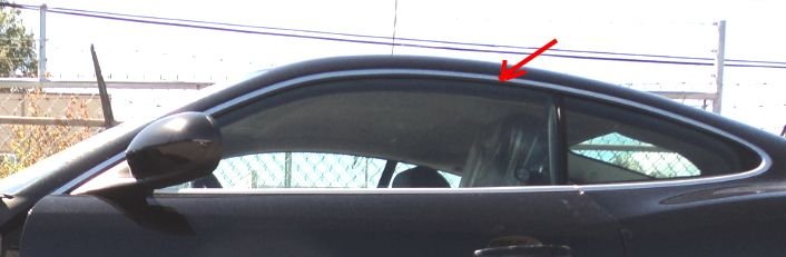

I'm replacing the door aperture seals - does the "silver" trim in the pic pop out easily? Thanks.

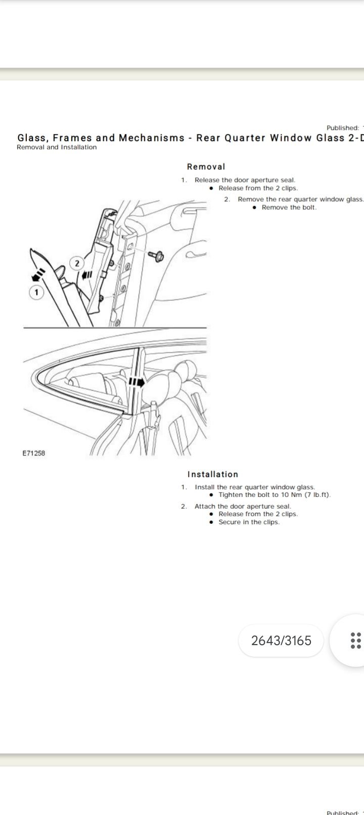

It's held in place by numerous small screws.
If you remove the rear quarter glass and begin removing the seal you will see how to remove the trim.
There's a Life on Cars U Tube episode that shows the glass removal.
I'm guessing the screw fixings continue all the way round the door.

Ya, it looks like the seal pushes into the trim rather than the trim being a push fit into the rubber, so no need to remove it by the looks of things.Screws shown at 11:32 min
