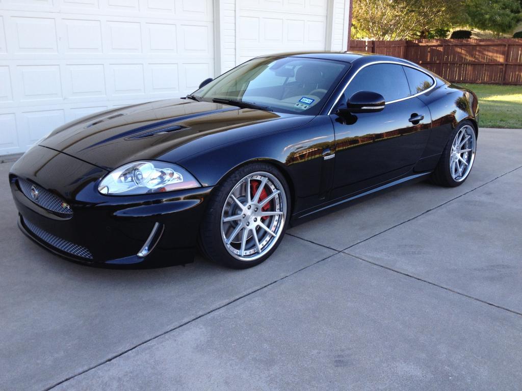

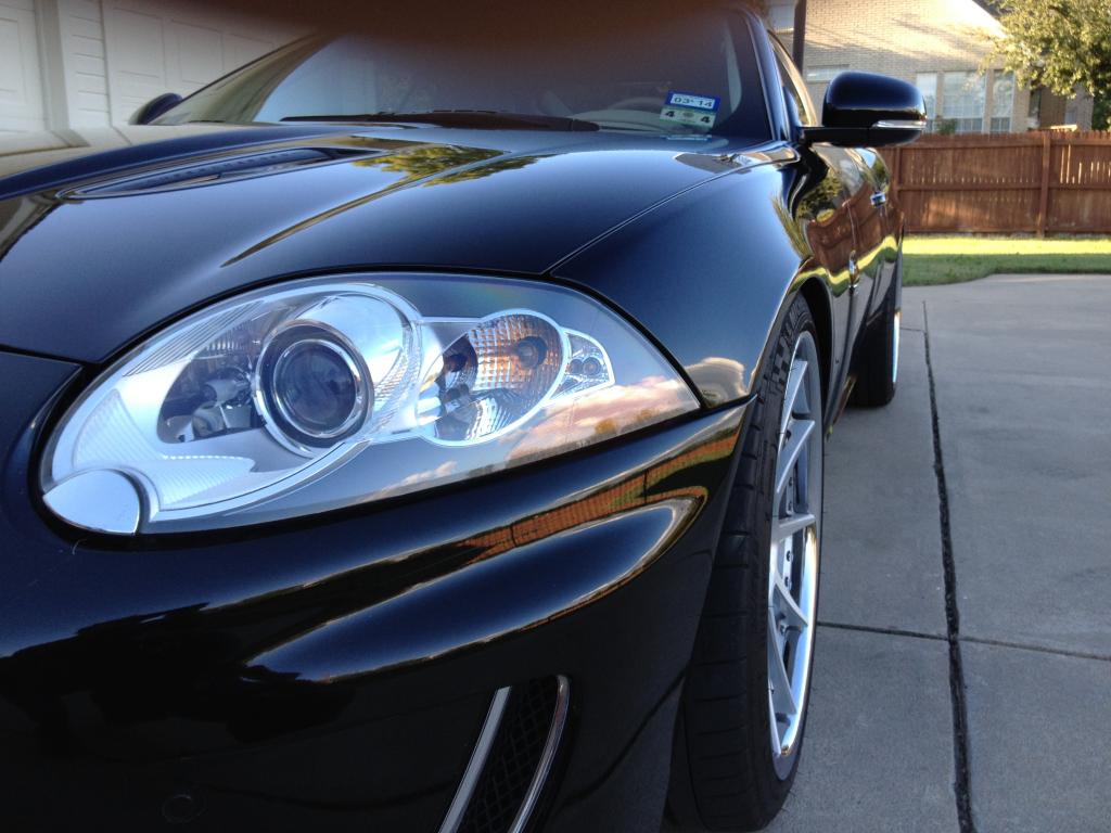

Wow, talk about thread resurrection ;-). This also reminded me that forgot about this thread and never came back to post my lowered pics!
Hopefully it will get full and future owners will have a thread nice and full of pics and info on various kits. Here is my H&R 1.5" drop.

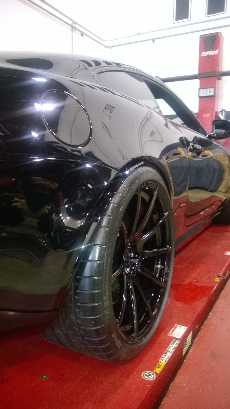

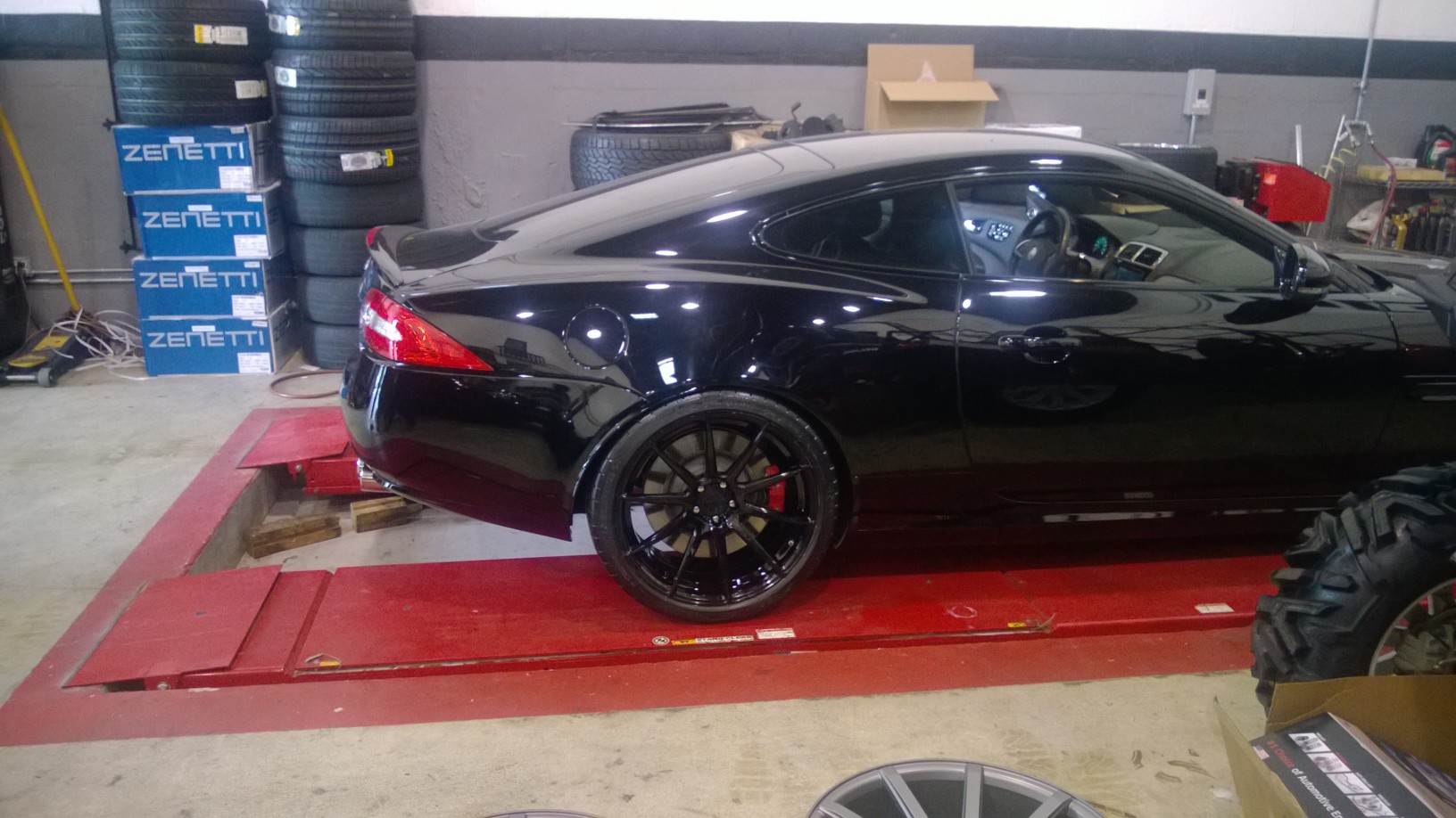

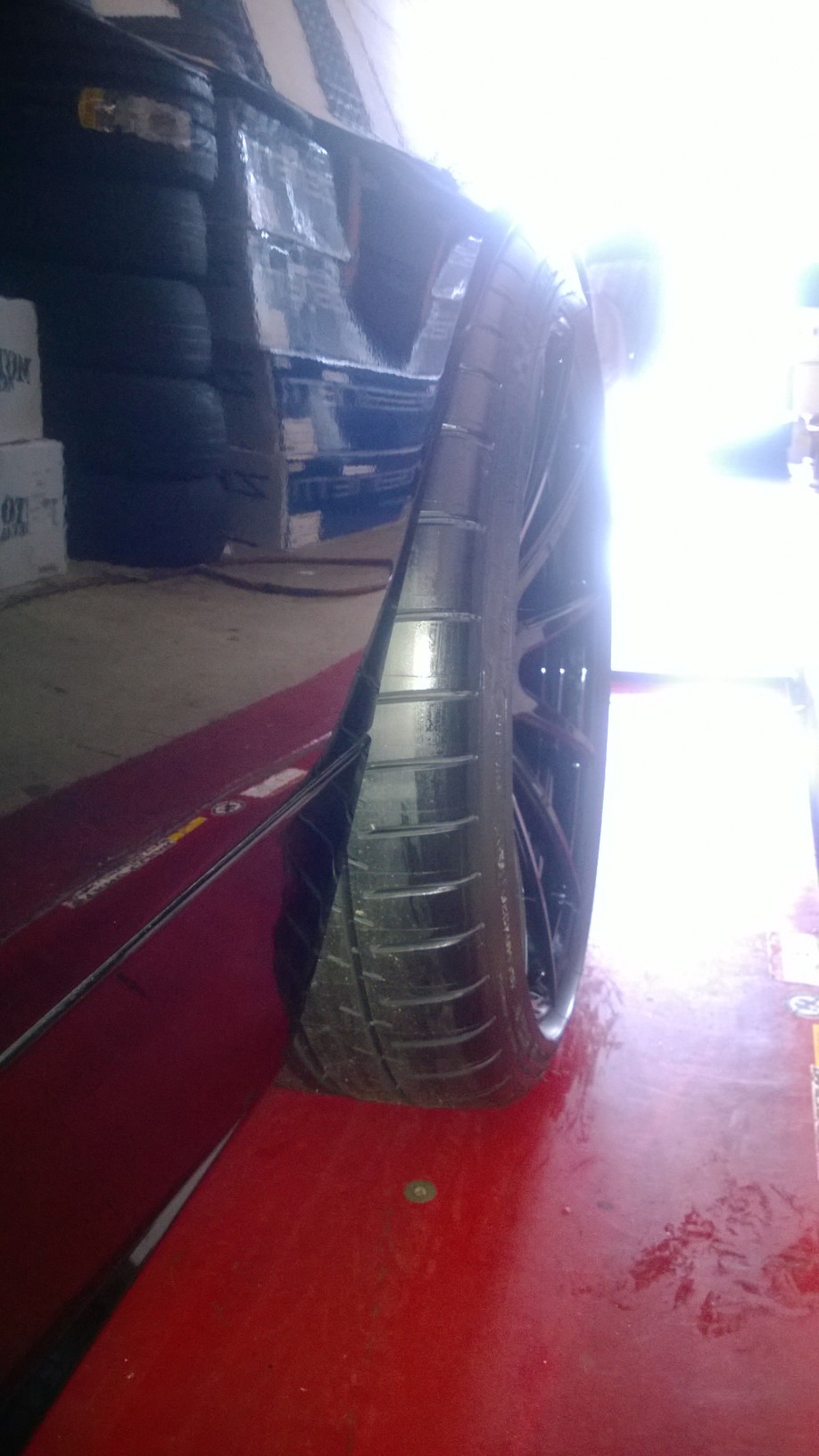

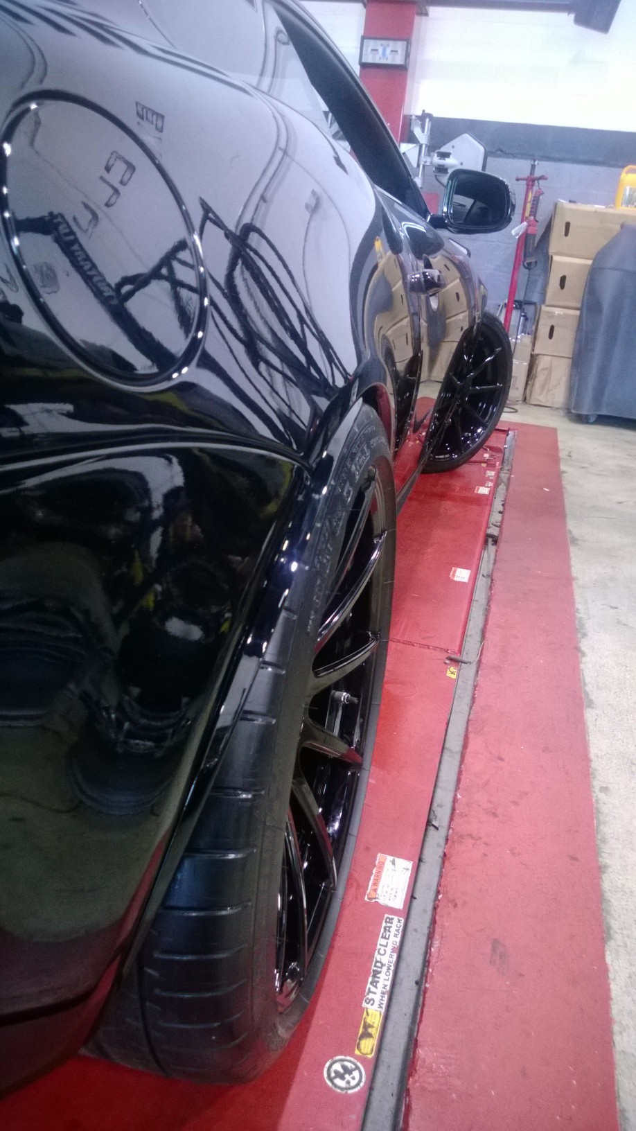

My HRE sizes and offsets are front 20x9.5 offset ET45 and rear 20x11 offset ET40. I put in a rush order so I'll know today the what day they will arrive. HRE took the time to measure a local XKR and have my shop measure my lowered XKR to get the proper fitments. This fitments includes tires to be used not just the wheels fitting. This is very important as the Michelin Pilot Super Sports tend to bulge due to the rim protector and the 305 are almost as wide as 315s.
I have no idea what the offset of the ADV 1 wheels came out to be, but the actual wheels were sticking out past the quarter panels in the rear. ADV refuse to fix this.. Worst customer service of any company I've ever dealt with. They actually had the nerve to say 305's won't fit this car, even though many people are running them. They told me to stretch a 295/25 across the 11" wheel to shoehorn the wheels in. Stay AWAY from ADV 1, I'll post a full thread with emails texts etc once i get a refund of my 6400 wasted dollars. I've attached a picture of the horrible ADV fitment.

Sorry you had to go through that. I hope HRE gets it right. I am very curious about the 305 or 315 fitting because a 295 wouldn't fit on my 20x10.5's. I run the stock 285. Doesn't look bad or stretched but really wanted at least 295 because a car with 510hp/460lb-ft should have something bigger than 285 IMHO.
