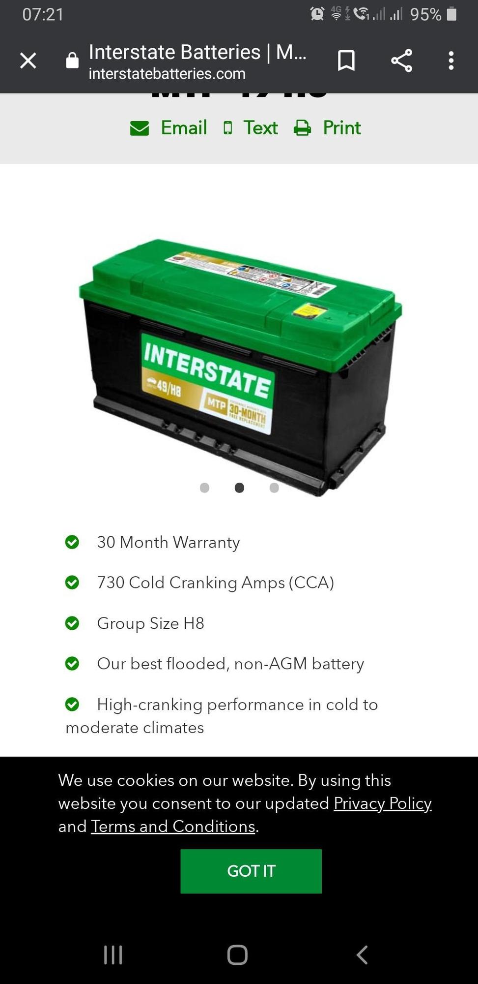

Marc, on your battery query (which seems to have been overlooked) my original battery (in the UK at least) for my 2014 was a 12v 90Ah/800A(EN) Jaguar part number 6W83-10655-CC
What you have fitted may be one of these Type 49 Interstate 730CCA which is 70 less than stock so not what I'd consider a direct replacement.
When my original 4yr old battery failed (the battery turned ut to be fine it was a badly wired up dashcam) I decided to upgrade the battery to one of these Type 019 at 920CCA, purely because I'd added a dashcam and tracker so potentially more drain, no issues since fitting, but did require the battery bracket on the rail to be moved (luckily local Indy did this for free).
https://www.tayna.co.uk/car-batterie...hoCtnkQAvD_BwE
Oh, and the original battery is fine and sits on my spare CTEK MXS 3.8 in my garage...just in case
Old Jun 4, 2020 | 05:50 AM
Marc Voorhees's Avatar
Joined: May 2020
Posts: 155
Likes: 92
From: Michigan
Thanks so much marty, I am going to the battery shop where my buddy works today to have a look and see what other options exist. Interestingly now, interstate recommends an AGM battery as a direct replacement for this car. It can't be this hard to figure out the right battery there are no extra electronics added into my car that I am aware of as a note.
