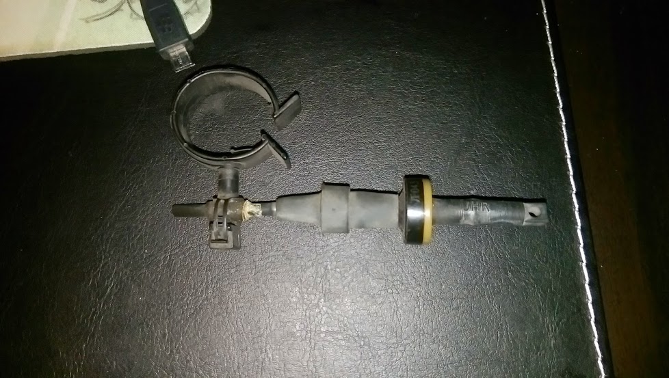

I removed the plastic cover over the supercharger and I found this piece inside
It clearly is broken off a small tube that runs someplace lower down
What is it?
What does it do?
How do I repair it?
Thanks

I would prove very helpful if you provide the MY, engine size and if NA or SC.

Hard to tell but it looks sort of like a diaphragm check valve for a gas tank vent line.

year, make, and model????

It is a 2008 XKR North America

It's a vacuum check valve, that runs between the vacuum control valve and the Active Exhaust valve. Should be mounted fairly near the vacuum reservoir.
