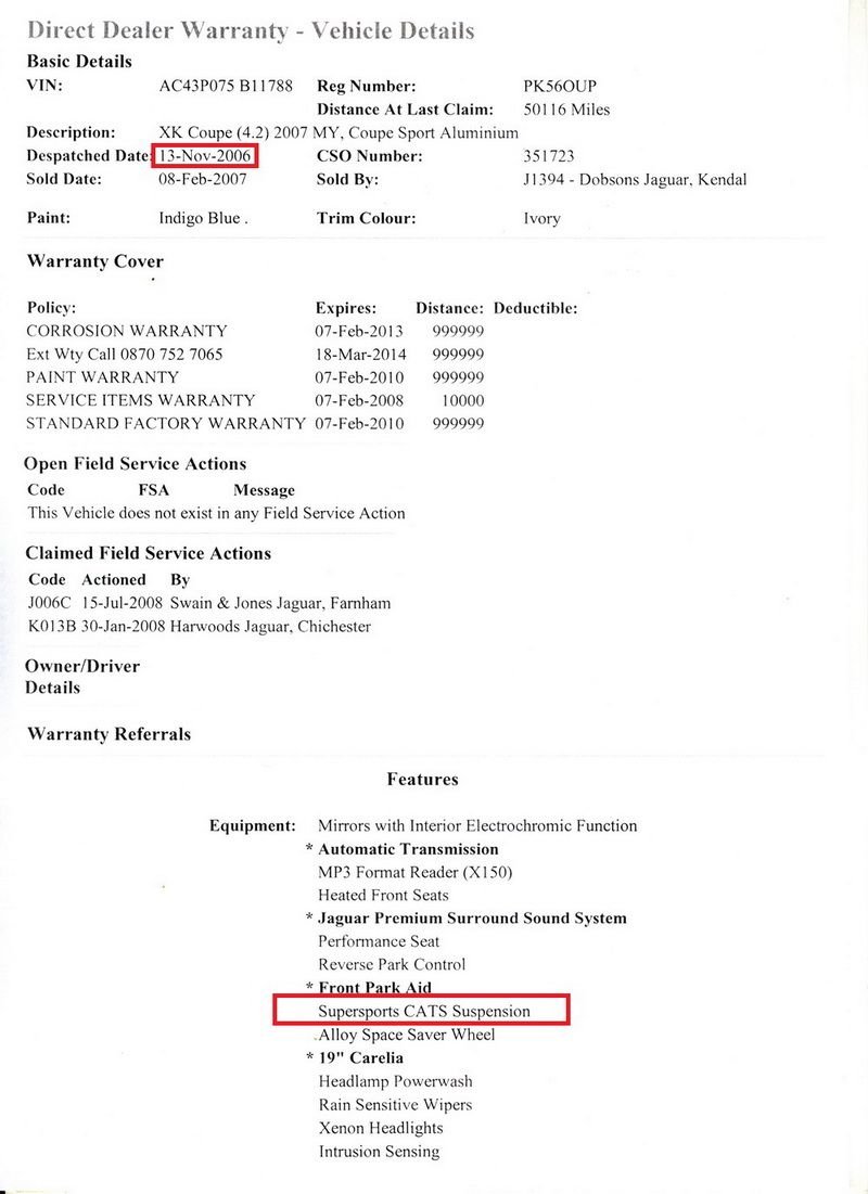

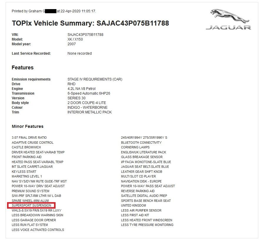

Found a mention of Supersport CATS Suspension in my 2007 MY XK 4.2 Direct Dealer Warranty specification:
Vehicle was an early example which came off the line in November 2006 but not registered until 2007.
The same vehicle specification when viewed in TOPIx lists the suspension as SUPERSPORT SUSPENSION so the terms are clearly interchangeable as far as the factory is concerned.
