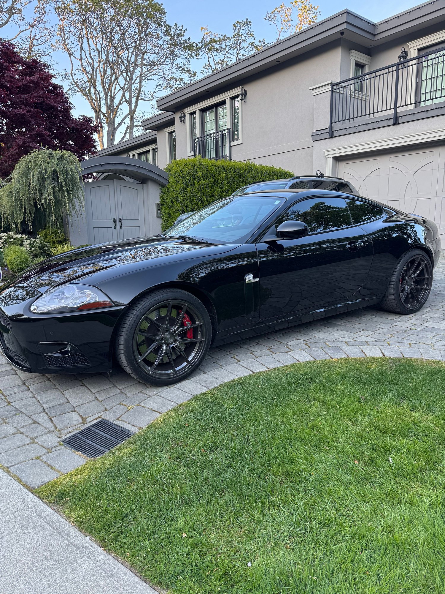

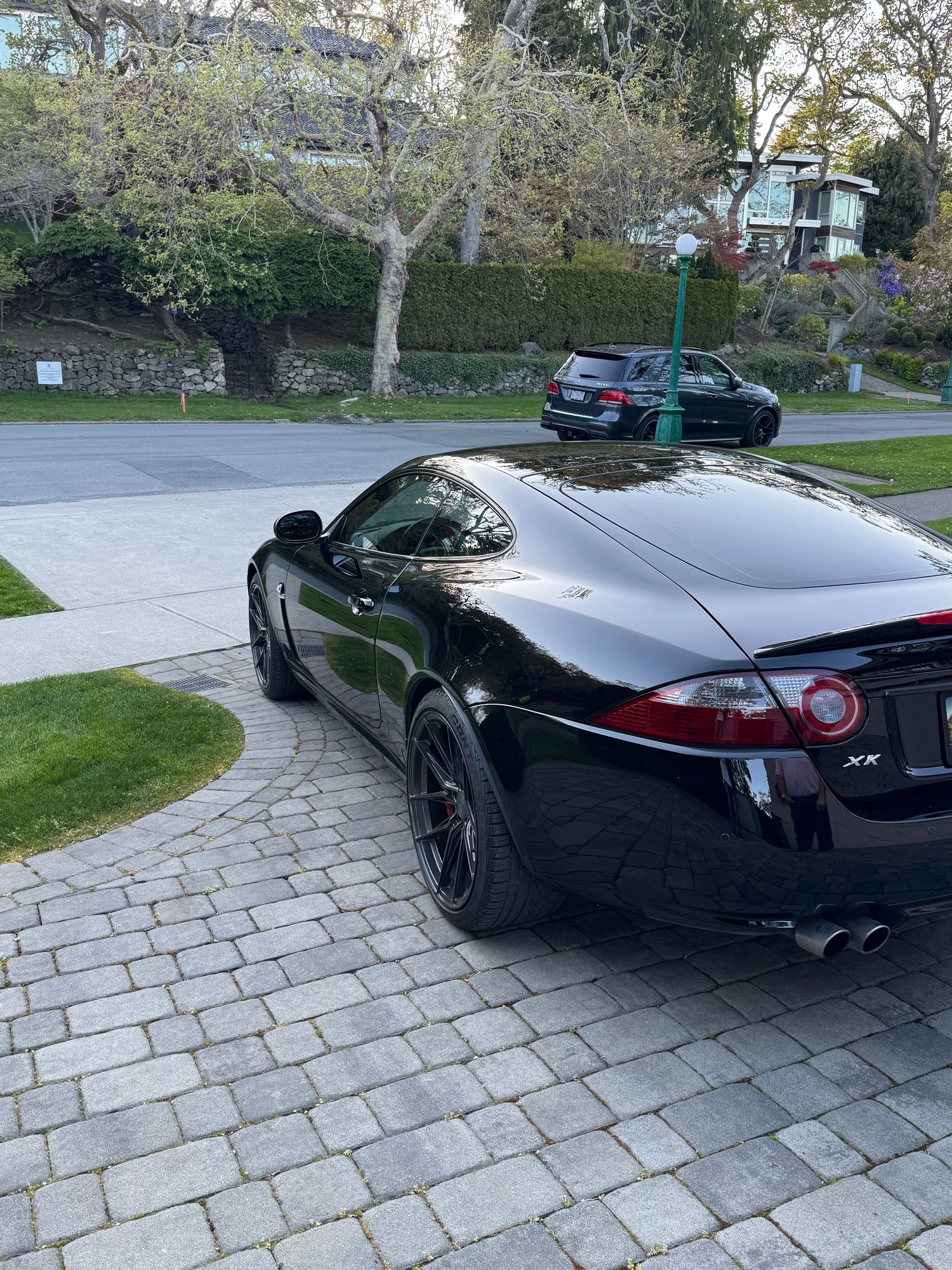

I decided to put HnR spacers on my stock sentas pics below. I have 20m Fr and 15M rear. That like previously mentioned makes the stock wheels essentially front wheel offset of 29M and the rears 11M
each number is just a millimetre, each time you want to poke out more lower the offset number. the number you lower it by means essentially the wheel will stick out in millimetres that much more,
So when I ordered my custom wheels I wanted the same aggressive look as the stock senates with the spacers on.. now here's where it can get a little confusing, when you change width of the wheel that has to be taken into account. so I went from a Stock Fr Senta 20x8.5 et 49 to a custom 20x9 et 34. ( 20x8.5 et49 with 20m spacer is et 29 but then I have a 9 inch wide rim vs the stock 8.5 so need to add 5m to the offset to make it equal. My rears stock senta 20x9.5 Et26 ( w spacer 15m makes it et11 ) so new wheel is 20x10 et17 , same poke as stock( actually 1m more ) 20x9.5 et11 with the 15m spacer. hope that helps, pics show seats spacers in and my new wheels no spacers. Just an fyi you will need your tire shop to make the hole deeper or wider cant remember for the studs in the sentas to make them work.
