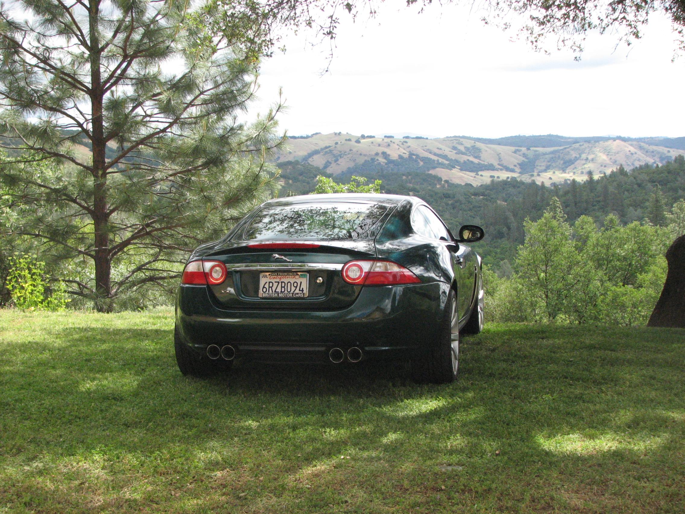

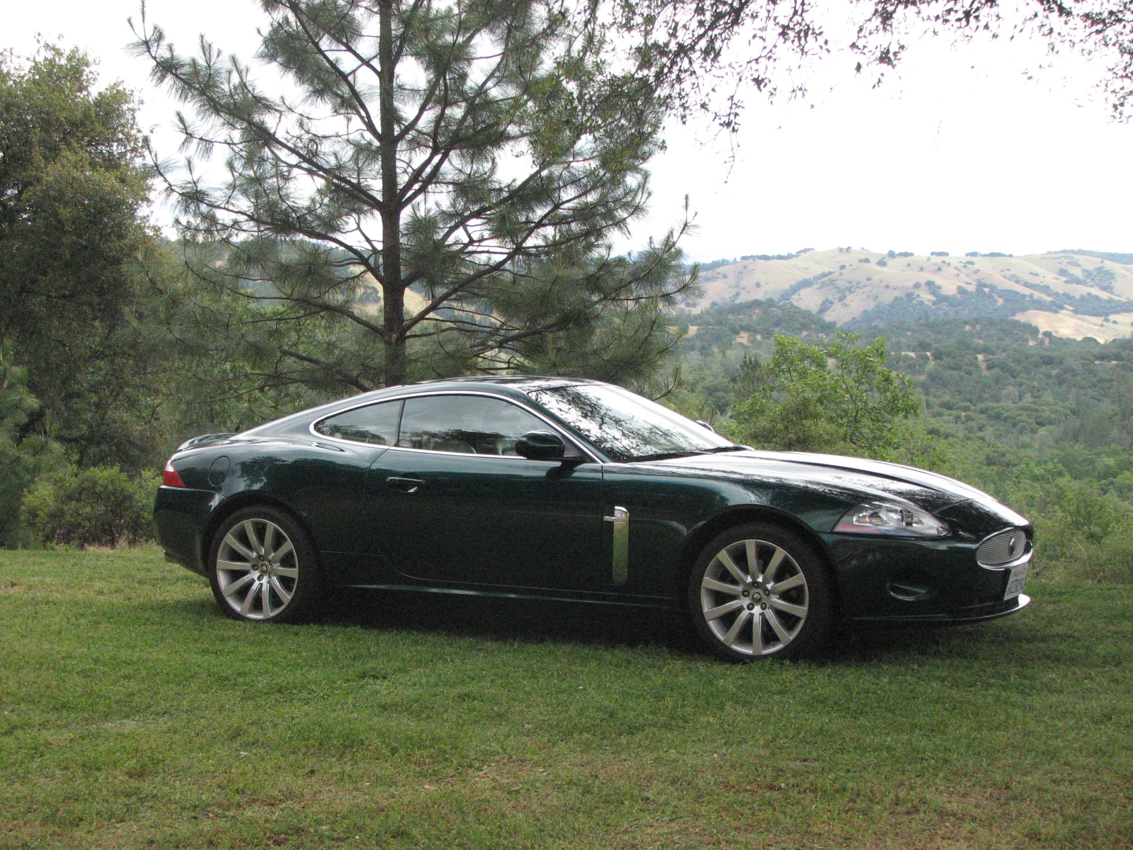

Alberts pictures he sent. I have reduced them down Albert they may be to large. Thanks for sending them. Has anyone put 20mm front and rear. Why just 20mm front and 15 rear? I have seen paramount with some advertised 20mm front and rear.
Attached Thumbnails Wheel Spacers-img_6494.jpg   Wheel Spacers-img_6498.jpg   Wheel Spacers-img_6506.jpg
