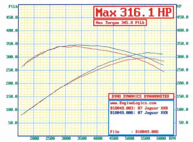

GhostriderXKR08,
Yes, 20hp.
Even more impressive when you realize it is not 20hp on top of the advertised 420 brake hp but a real 20hp on top of the measured 296 rear wheel hp. And while I didn't pick up much torque, notice how the torque band is extended over a broader range of rpm, .
I took the car to EngineLogics here in Houston. Brad did before and after dyno runs and installed the cats in about 2.5 hours. Even he was surprised how much hp it picked up.
When I took it in I had taken out fuse F19 which puts the active exhaust into always open mode. Before the cats it was a nice grumbling sound, after the cats it was loud and had kind of a crackle to it, not deep enough. Put F19 back in and it is a nice compromise. You can really tell when you edge over the rpm/throttle position and the exhaust opens.
Here is some data.
Before
After
Combined before & after

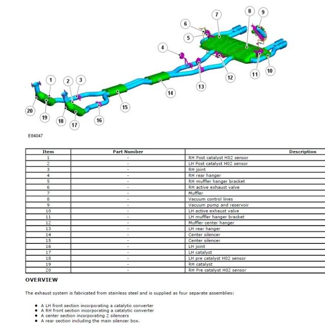

Active Exhaust Information

Very nice....I like the broad curve instead of the peak and dropoff. Not only that but it looks like the increase is in the fat portion of the power band. Thanks for sharing your dyno numbers and thanks to Jason at Nameless Performance.
As an off topic.....looks like we are below the 420HP advertise? 296.5 RWHP equates to approx. 355.8 HP to the flywheel which is about 64 HP below manufacturer's claim using a generous 20% (automatic tranny) parasitic loss to the drivetrain.
For comparison......
4.2L Supercharge: 296.5 RWHP.....approximately 356 HP to the fly.
5.0L Supercharge: 460 RWHP (taken from the dyno test from the XFR guys).....that means the 5.0L SC is in reality 552HP to the fly and not the 510HP manufacturer's claim.
I think I might have to dyno my XKR this summer just to see what it does.
If anyone knows the exact drivetrain loss for Jags...please let us know. Thanks.

The dynodynamics has 2 small drums per wheel causing more drag, and will thus give lower rwhp numbers. In the UK they even don’t test in 4th gear because of this, and only use 3rd, whereas on the road 4th gear gives more power than 3rd as it is more close to a 1 to 1 ratio (so less friction losses).
I have only limited experience with these units, so can't say what drivetrain losses could be in this setup, which are obvioulsy higher as you need to calculate the tire firctoin losses into it. I realy dislike these units because of the fact that the rwhp is also further from the actual power your wheels are putting down. Therefor I always try to use dynos that use 1 large drum per wheel, en preferably also that are able to generate a load via an eddy current). There are many things that can influence the results (i.e. low tire pressure, especially on the dynodynamics dynos), so without knowing all the environment parameters, correction factor used heat soak etc, it will be hard to compare figures.
As long as everything was about the same between the runs (so also not having the battery during the Cat swap), you could at least compare the results.

Avos,
All good points. I don't worry too much about the overall dyno hp number itself as there are so many variables. I'm just interested in the difference between before and after as an objective measure of improvement.

Avos.....thanks for the explanation of the dynodynamics dyno. Was alittle concern as the stock numbers wasn't that close to manufacturer's claim but now it makes sense that dynodynamics dynos less than others.
GN4HIR.....You're right....the gains is what matters...... BTW....do you know if these numbers are SAE corrected? Just curious......
