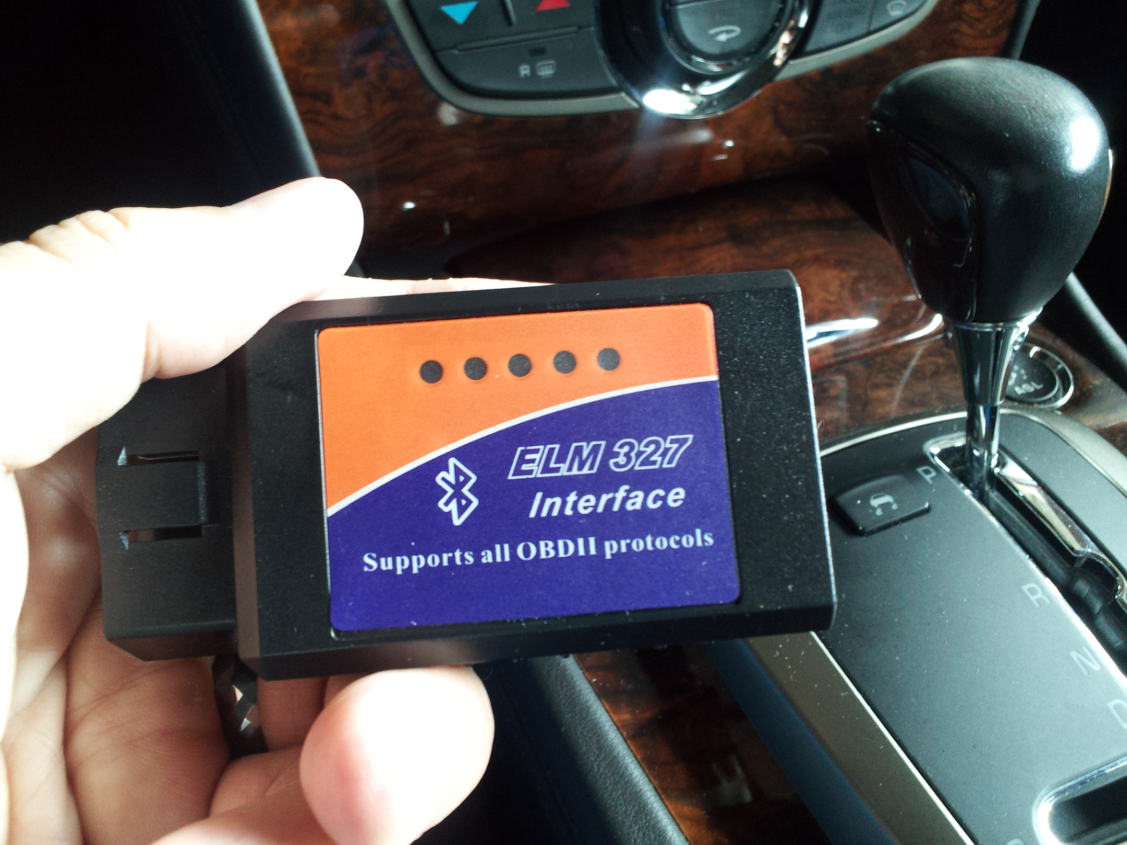

I use the ELM327 bluetooth OBDII reader with the Torque Pro app loaded on smart phone or tablet. You can set up the display to show multiple sensors including STFT and LTFT
Still learning all the tricks but think it would suffice - all for under $20
Exactly! An ELM327 and a smart phone with Torque Pro. Done!

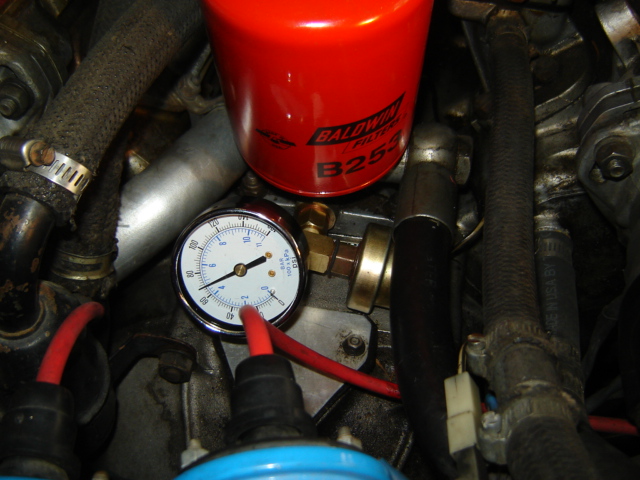

After having the OP issue with my old Ferrari I had to make a tee fitting to install a gauge at the sending unit so if I had to I would bet I could put something together.

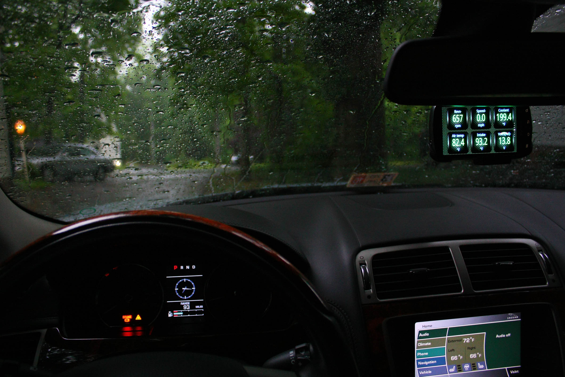

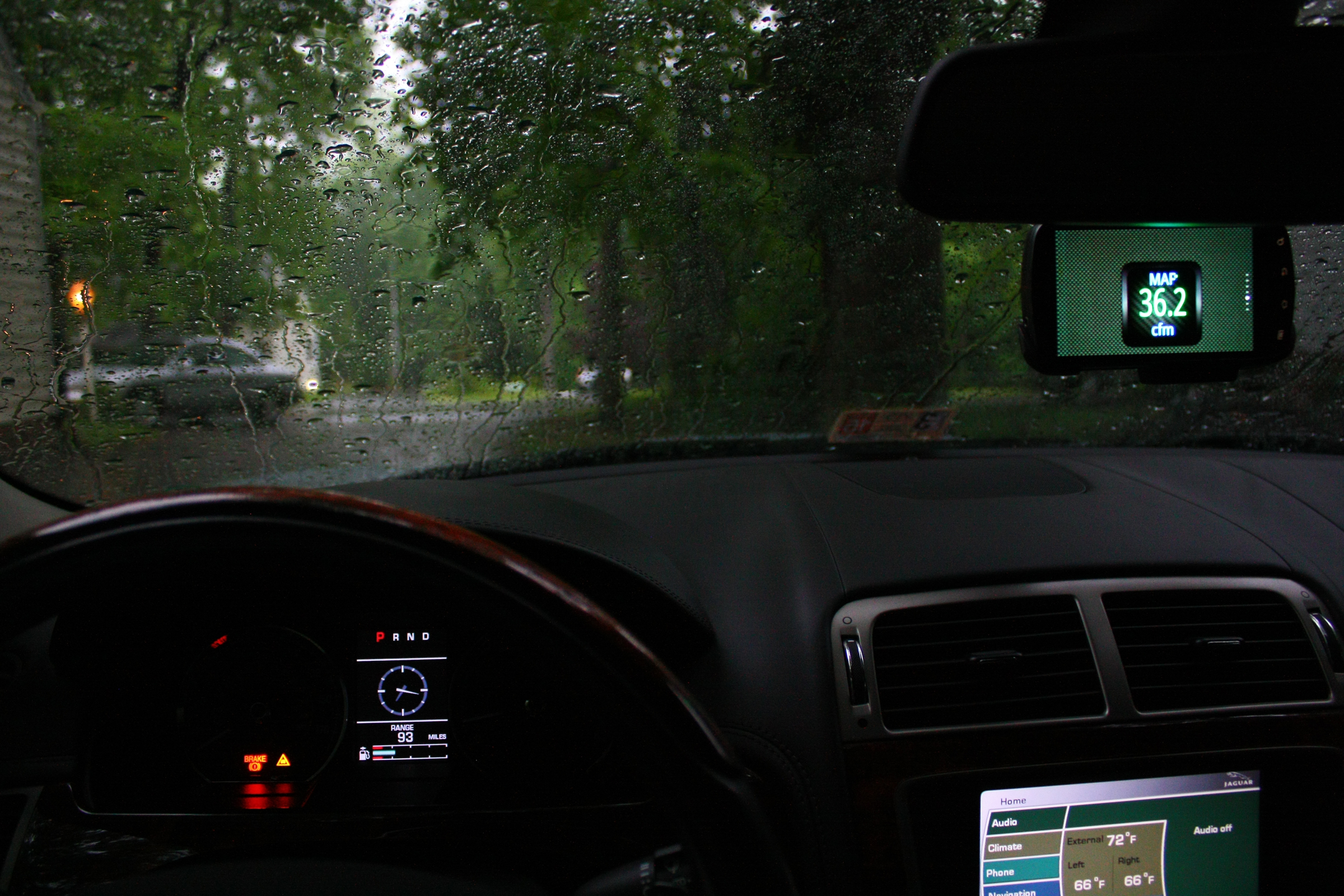

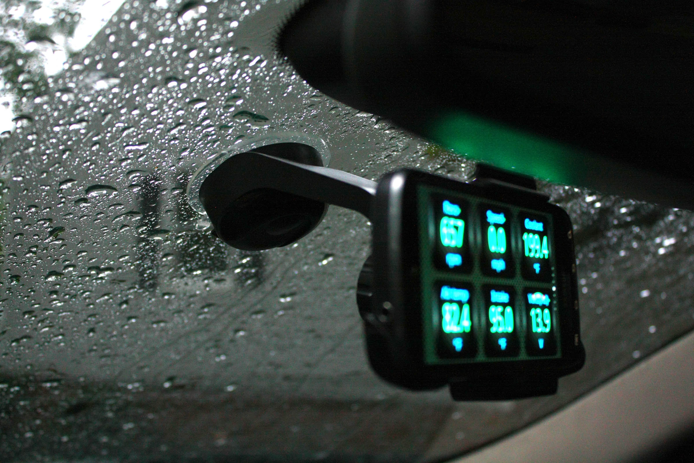

Here is a real-world example of what the ELM327 OBDII adapter + Torque Pro smartphone app looks like from the driver's seat.
In this example, revs, speed, coolant temp, air temp, intake temp and volts can be seen. There are many other sensors that can be monitored. You can even see any fault codes that are issued and clear them if you wish. You can have many sensors displayed, or just one big one. You can vary the colors via "themes."
My Samsung Charge uses the Android OS and the mount is made for it. There is probably a dedicated phone mount for your phone too.
The ELM327 is <$10 and the app is too, if I recall correctly.
Please let me know if you have any questions.
