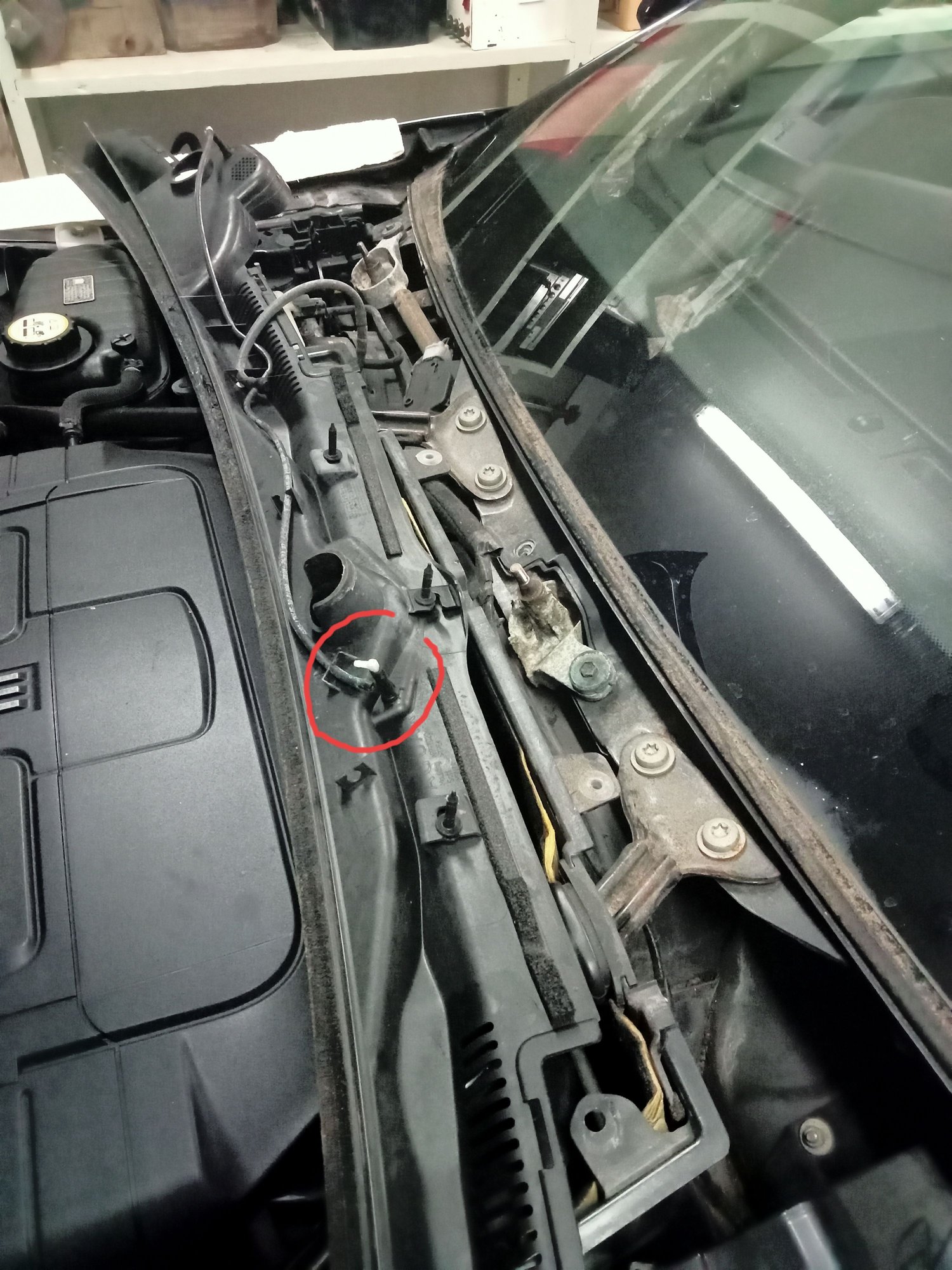

Left hand windscreen washer didn't work, right side ok.
Removed the rubber pipe from its elbow on the cowl at the base of the wiper, tried the washer but no water from the elbow. Attaching a length of pipe and blowing/sucking demonstrated it wasn't blocked and probably leaking somewhere between the two wipers, under the cowl. This was verified when I noticed water dripping on the ground beneath.
Getting the cowl off.

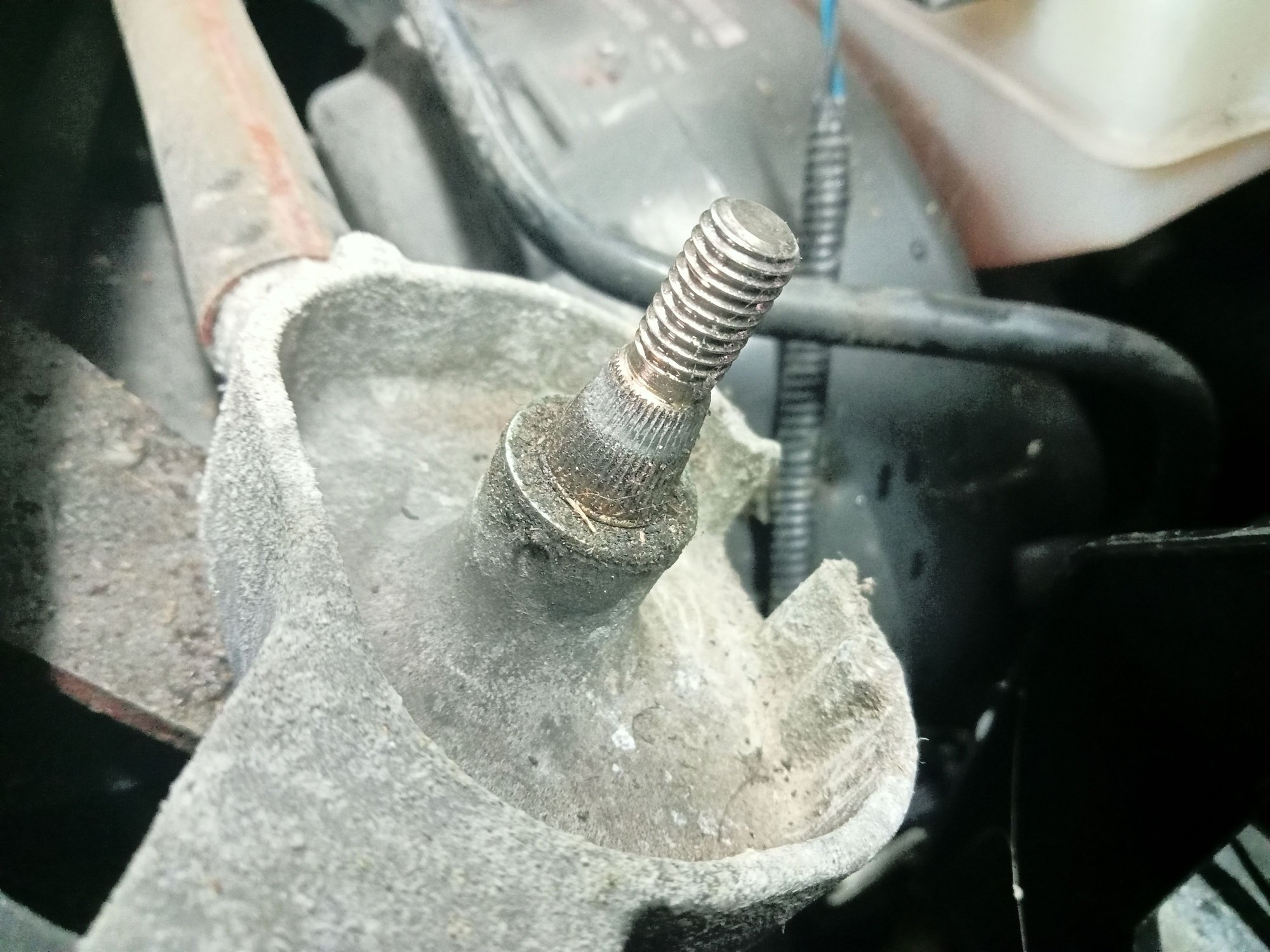

First remove the wipers: disconnected washer pipes at the cowl elbows, prised off the plastic covers and undone nuts at the pivots. A straight pull on the wiper pivot point didn't budge them so thought I must invest in a puller. Applied penetrating oil and ordered a universal one to pickup. Next day tried to use the new tool, it's arms are too short. Meantime I had researched and the pivot is a splined taper, like a cone, others say a bit of leverage on the arms can free it. Yes, pushing gently down the blade end broke the bond and away they came.

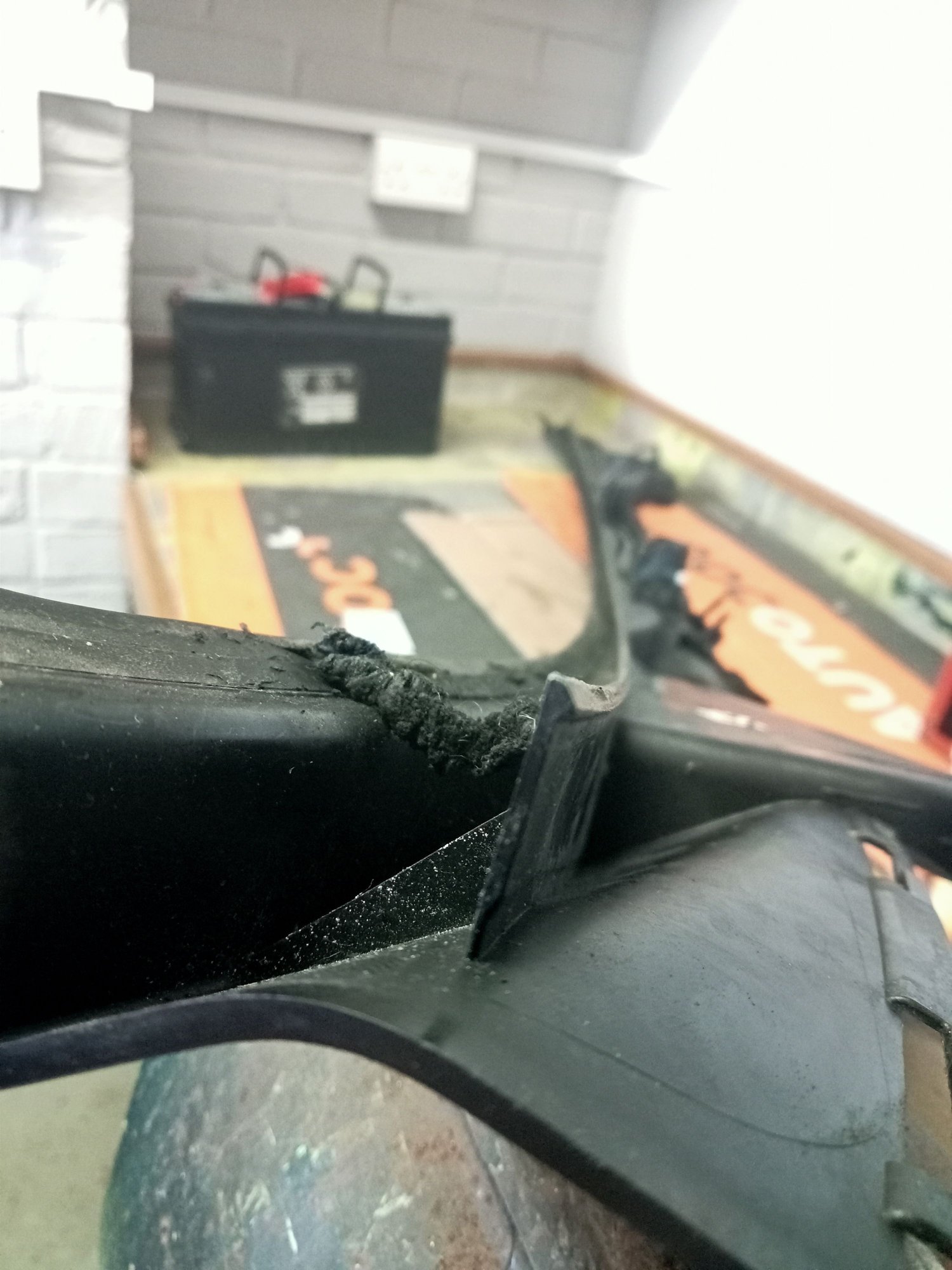

Now for the cowl, held on along it's length by being clipped to a groove in an aluminium extrusion fixed to the bottom of the windscreen. It's also stuck to the glass with a soft sticky strip which is easily unstuck after 14 years. Removal was simply a case of carefully lifting the cowl at one end and working the long clip out along it's length. There are three peg type plastic clips near the centre which came out easily. Washer pipes and a T valve are clipped beneath the cowl, disconnected the feed pipe at a straight connection leading to the cowl.

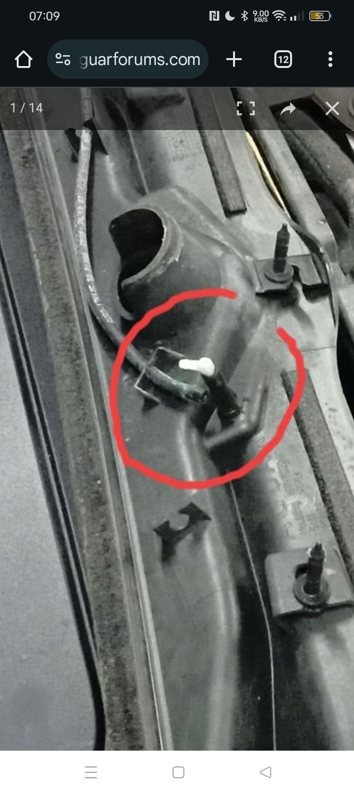

Obvious fault - washer pipe was not connected to elbow, maybe caused by frost/thaw action if the last owner had not added winter screenwash. It refitted tightly and I pulled a little slack through for luck.

Wiper pivot
Long clip on cowl
Groove below the windscreen

when you say not connected to the elbow you meant the passengeer side hose was not joined to the T valve? The washer bottle has a main entry hose that is split into 2 with the T valve to both wiper blades.
It parted from the elbow fitted just before the pipe passes through the cowl.
