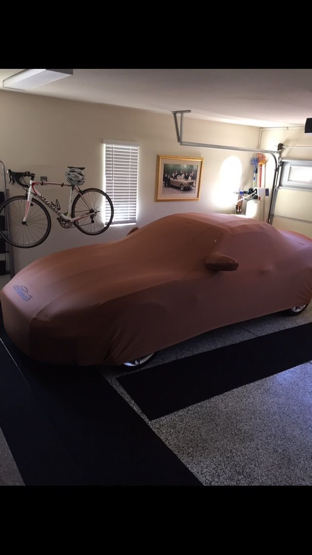

My storage months are exactly opposite as we reside in the Desert Southwest and our Jaguar hibernation is in the summer. My routine is a simple one. I give it a detail (wash, ceramic coat of wax, 303 fabric care on the convertible top, condition the leather and tires, etc.). I slightly over inflate the tires. I fill the tank with fuel and add a brand name stabilizer. I attach a CTEK maintainer. I lock the car and place the key fobs a good distance away from the car. Lastly I cover the car with a soft indoor car cover. My XKR “sleeps” untouched, started or moved for usually about 5 - 6 months
XKR Convertible in summer hibernation.
. It fires right up with the only issue being slight flat spots on the tires which smooth after just a couple uses / drives.
