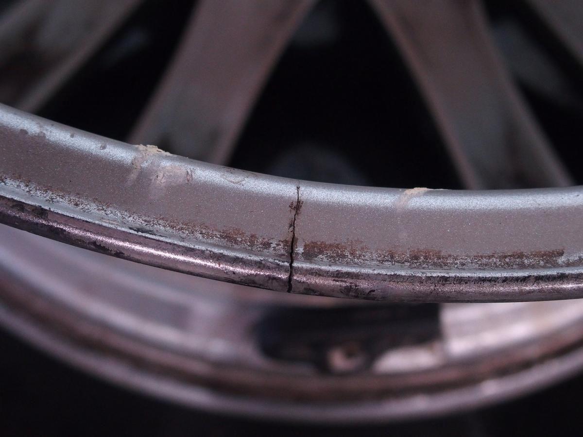

My instinct when looking at it is: get rid and replace, but maybe these kind of cracks are repaired safely every day and last for years? If I have time this week I might take it to a wheel shop to see what they say. It's a hairline crack.
Tire started losing 7-10 PSI a day and this ended up being the culprit.

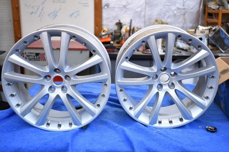

I just got a couple weeks ago a very similar crack in my front Nevis wheel, and the only one I can find in the country is $800 for one used. Dang right I'll have the cracked one repaired before I spend that much for a wheel that'll probably crack similarly in a few years.
I am now somewhat actively looking for a full set of aftermarket wheels in the actual sizes I want, but those will have to be semi-custom as nobody has in-stock wheels in the desired sizes and specs. That'll be a few grand, I'm sure, but then I'll get what I want.

In the event you were not aware, a proper wheel refurbishment shop can repair that crack with a welding job. And if welded properly, just as strong as the original state if the wheel.
I had one wheel “fixed” on the xjr.. if memory serves it was about $300 for the rounding, welding, balancing and painting.

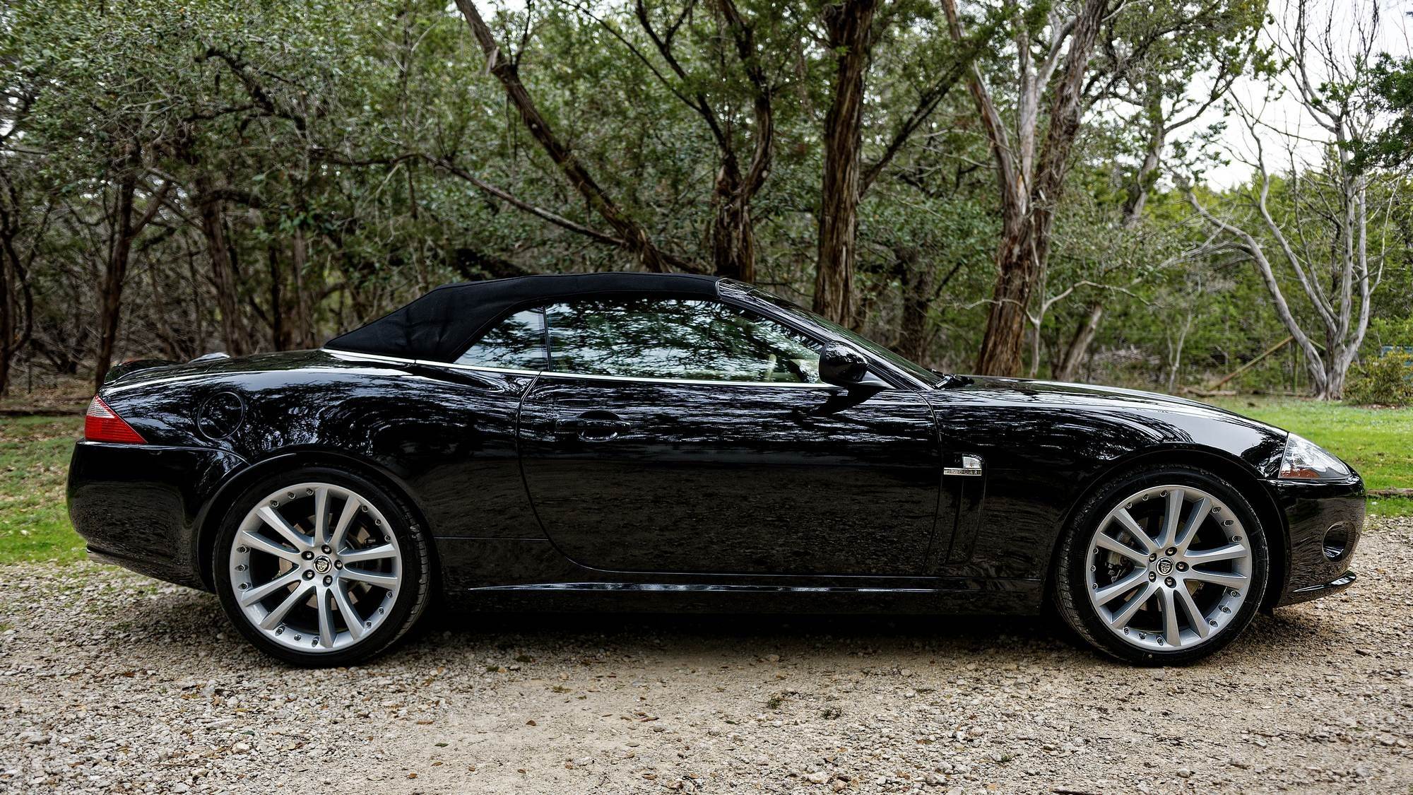

Originally Posted by wymjym
I cracked a Selena wheel and had it repaired...also sent a front wheel at same time to have a 'matched' color. The repaired wheel looks perfect from the front. Both wheels were straightened and powder coated. Cost was $200 @. That was one year and 10k miles ago. No issues so far.
wj

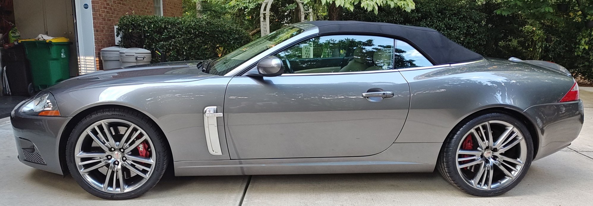

The wheels in the above photo are Senta, not Selena. Selena wheels were exclusive to the 4.2L 2009 Jaguar XKR Portfolio models and became optional on the 5.0L models. The 5.0L Selena wheels don't fit the 4.2L models because the rear offsets are different due to the e-Diff on 5.0L models.
These wheels are Selena:

Cosmetic alloy rim repairs (curb rash) usually do not affect structural integrity and are safe, unless the bead is affected. But any wheel repair that requires welding will eventually fail again at or near the weld since welding reduces structural integrity. Google it and ask a metallurgist.
Don't put your life or the lives of your passengers at risk. Tell your insurance company in writing that they are putting you in harm's way with a remanufactured wheel and that you will hold them liable for any property damage or personal injury when that wheel fails. They'll give you a brand-new OEM wheel faster than you can whistle "Dixie".
Bottom Line: You can't tell if a repaired wheel is safe to drive on simply by looking at it, since welded areas can be made to look like new after they've been sanded and repainted. The final point is that a weld will never, ever be quite as strong as the original material. So why risk it? Better to be safe than sorry. Read this: Are Welded Wheels Safe
Because you might not be able to see the weld or know anything about the skill of the welder, I won't risk my life to save a few hundred bucks.
