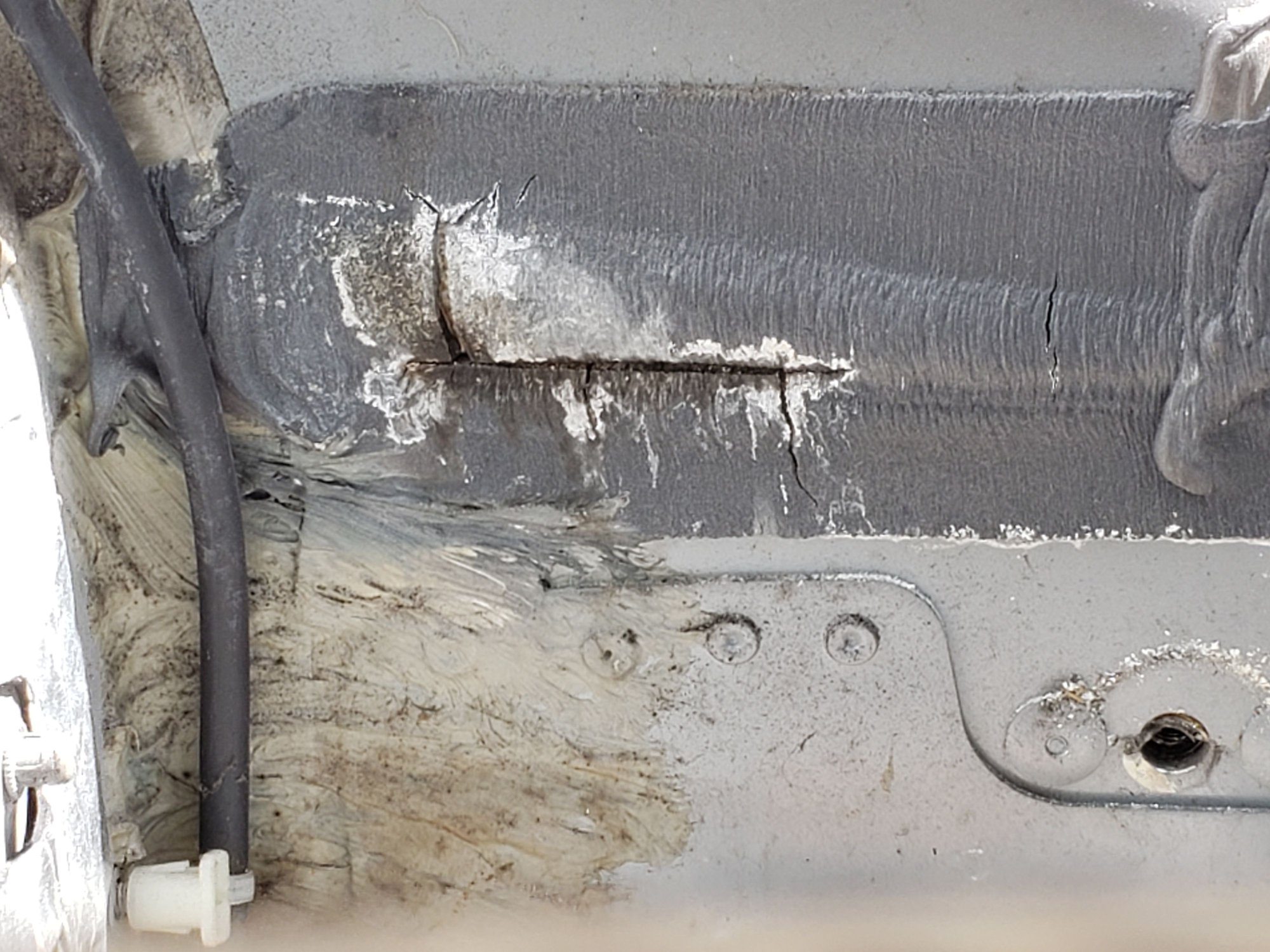

Pleased with a replacement convertible hood (top), I thoroughly washed and dried the carpets (not mats) outside of the car.
A check for mildew prior to reinstallation of the carpet revealed a minor problem. Do you see it?
The 2010 XK in this photo is 15 years old at the time of this writing. This is an obvious case. However, I have checked two other 2010-11 XKs and both have vertical cracks in the hard mastic sufficient to allow rain ingress.
This issue was previously noted by @RichardS in Post #3 Wet carpet, driver's side "back seat" footwell - source? - Jaguar Forums - Jaguar Enthusiasts Forum
also see:
(see 5:00 min)
Andy Maunder, the You-Tuber detective, has also found a similar mastic failure leak at the firewall.
This looks to be a "coming attraction" for die-hard XK fans.
