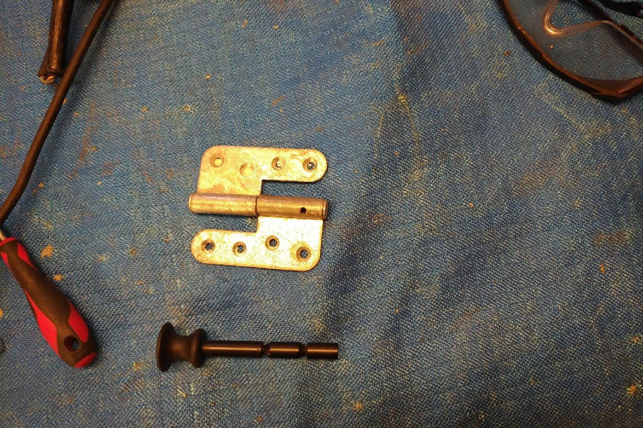

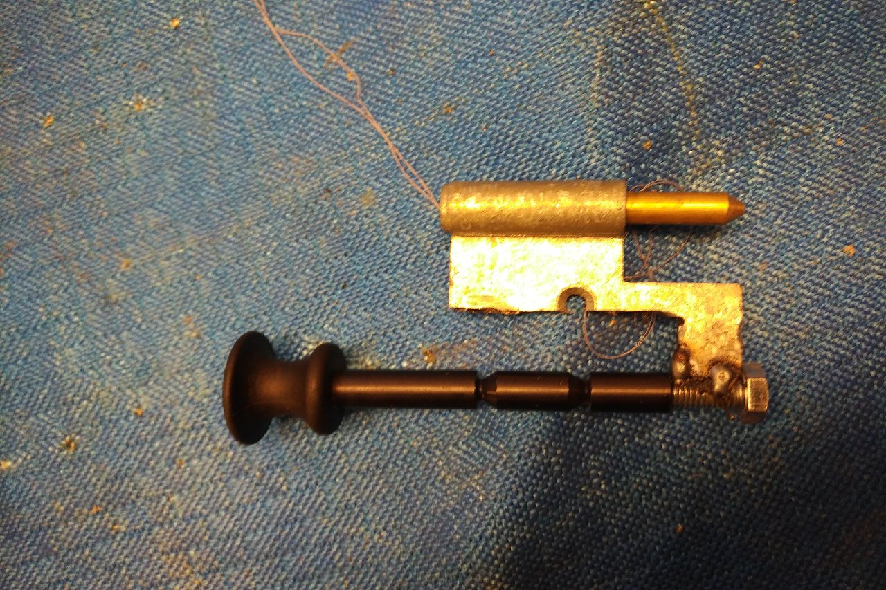

Talked to Adamesh, had some more questions, also wanted to buy a cover, but he never called back as requested, so I thought I'd test my current wind deflector. It's not in great shape, so if I ruined it, wouldn't be a big disaster, and it's better to modify the wind deflector than the car inner panels, they're harder to fix.
So I wanted to make a Q&D raising the deflector about 1½". I used two door hinges and cut and welded. (If you've read about me cutting and welding the accelerator pedal as well and are worried that I'll cut and well the whole car, don't worry, I think I'm done now )
The result was good.
1) Less wind in the cabin
2) Full view through rear window
3) Room enough to raise the top, doesn't hit
In other words, this is the height OEM should have been from the start.
Pictures, not for the faint of heart, but the brackets I made are just screwed into the threaded rods, so it can be reversed at any time
Attached Thumbnails XK Wind Deflector-img_20170810_1418548.jpg   XK Wind Deflector-img_20170810_1424045.jpg   XK Wind Deflector-img_20170810_1515030.jpg   XK Wind Deflector-img_20170810_1519373.jpg

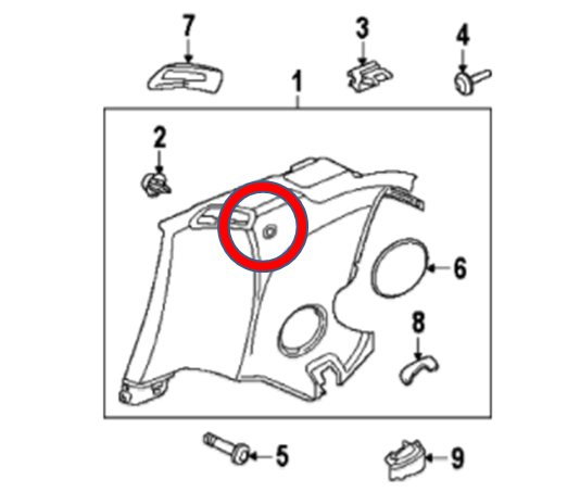

Does anyone know where I can buy these grommets, not an individual item in a parts catalogue apparently?
Old Aug 18, 2017 | 05:46 AM
JonWat's Avatar
Joined: Dec 2012
Posts: 402
Likes: 99
From: Swansea, Wales
Should be able to find something suitable here.
