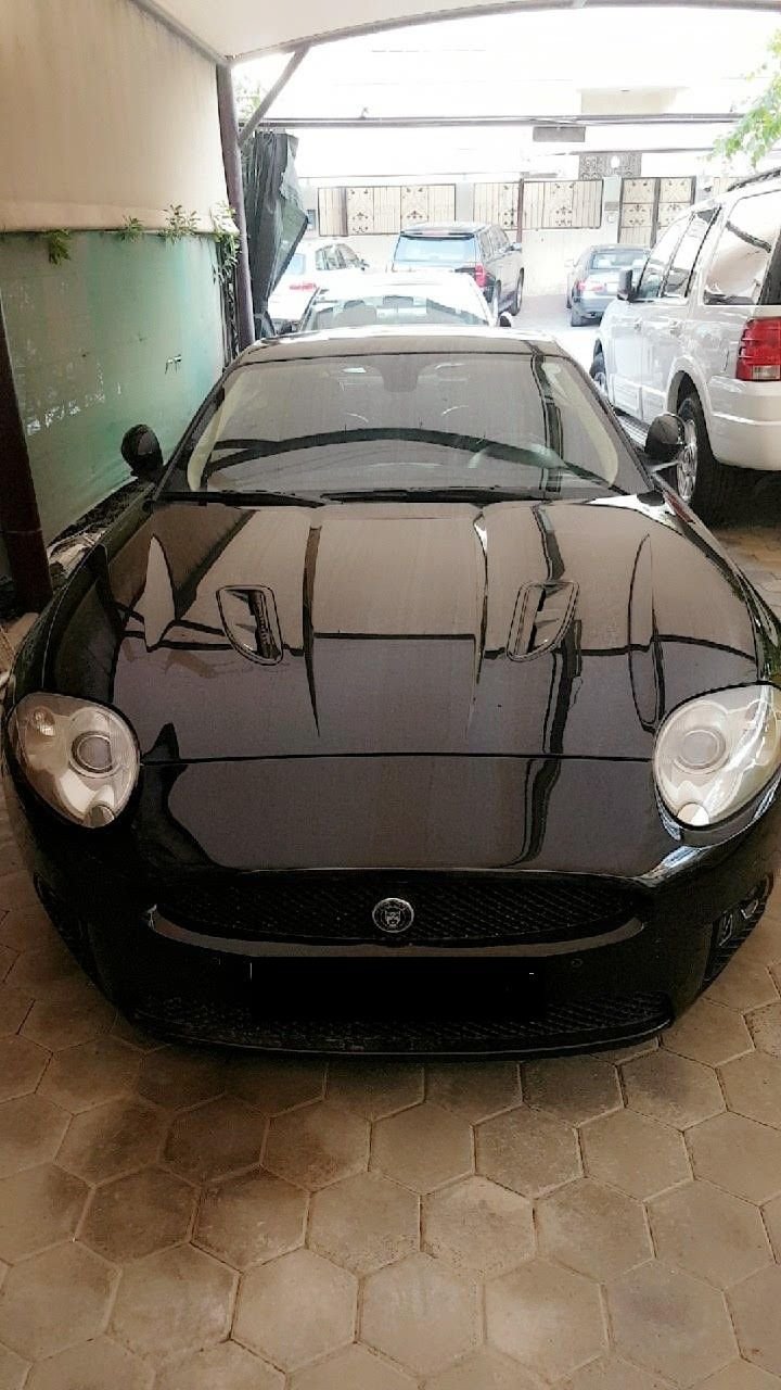

Hello guys,
Am new here, and i would like to take your opinion on that issue am having.
I found an XKR 2007 with 56K miles as it was stored for years (they are very rare where i live, probably 5 cars only in the entire country, however, the XK is popular).
As i was finalizing the purchase, the owner called me saying that when he tried starting the car in the morning, there was no response. He took it to the Garage and they found that water is mixing with motor oil.
Preliminary inspection is that the head-gasket is leaking and it need to be replaced.
My questions on that matter are:
1- Is this an easy fix? and if done properly, will that problem vanish for good or it will keep having this issue every now and then?
2- Since XKR is a rare car here, will the XK head-gasket fit into the XKR? - or should i order it from the UK?
3- Can the cylinder head be affected by that and will it need replacing as well? and if it did, will the XK fit?
4- Shall i proceed with the purchase and drop the price down / or this will be a headache and unnecessary risk? I really like the car but am not sure what is the full scale of the damage and the owner is unwilling to fix it and will sell it as is without fully inspecting the issue.
I found couple of garages that are willing to fix it, but they always work on XK, but never an XKR.
I would really appreciate your feedback and expertise on this.
Thank you.
