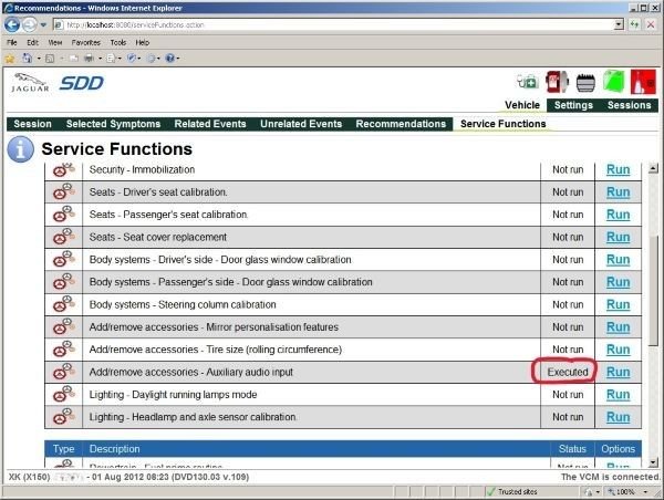

@LoganW and @Circumnavigator , I will try to resolve some of the confusion. As my 2009 XKR came equipped with the USB/iPod accessory, ‘Portable audio’ was already a button below the CD button on my touchscreen. When I enabled AUX using SDD, an ‘AUX ‘button appeared next to the ‘USB’ and ‘iPod’ buttons under the ‘Portable audio’ selection. Logan, if you enabled AUX before the USB/iPod accessory, then your ‘AUX’ button may be appearing on the left-hand side below the ‘CD’ button. I believe I’ve seen some pictures in some threads here showing this alternate location of the AUX button. If so, I don’t know how to resolve that, but I’d try disabling AUX, then enabling the ‘Accessory USB unit’ first to get the ‘Portable audio’ button appearing as in my OEM location. Then, secondly enabling AUX might make all the buttons appear as on my screen. Another item I do not know is if the ‘Accessory USB unit’ will actually become enabled without a physical USB/iPod module to detect. It may need that as part of the configuration process; although, I kind of doubt this as I previously enabled the ‘Heated steering’ option on my touchscreen and it would turn red when pressed, but nothing happened since I don’t have that type of steering wheel fitted.
Logan, as to the ‘Accessory USB unit’ parameter options in SDD, SeanW was correct in relaying that I had made an Excel (XML) file of all the available parameters in SDD v130. It is much quicker to scroll through Excel to find parameters and their settings than in SDD. My list is available in both Excel and PDF formats at Car Configuration Personalization Parameters in SDD v130.
To more fully answer your question, I went in to SDD today so I could show you how my OEM ‘Accessory USB unit’ parameter is set. The first picture below shows the last six of seven options available and the one in blue is how the factory has it set. The second picture shows the full name of the factory-set option when the mouse is hovered over it.
And SeanW correctly point out that you do not need Engineering Mode to enable AUX. It’s an option in the Service Functions as shown below. But you do need to go into Engineering Mode and then the Service Function called, ‘Car Configuration Management – Current Vehicle Car Configuration Modification’, to enable the ‘Accessory USB unit’ as shown in the pictures above.
Hope this helps answer some of your questions.

@KurtC Thanks for the pics and explanation. Perfect for future use.

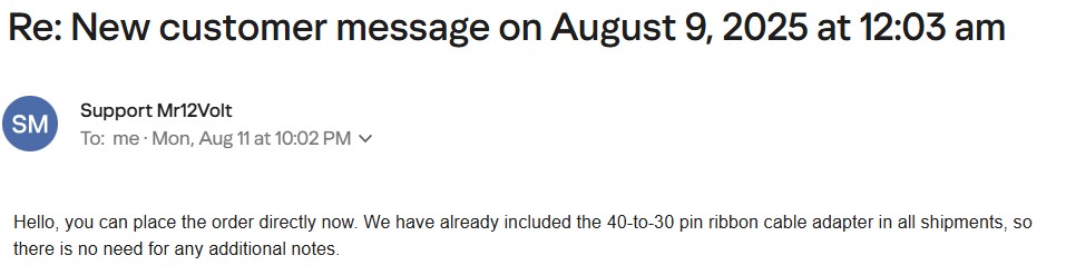

Just to put this to rest, here is the response from Mr12Volt. Took them a few days...
The X150 unit now comes with the 40 to 30 pin ribbon adapter.
( SDD mods of course are still required )

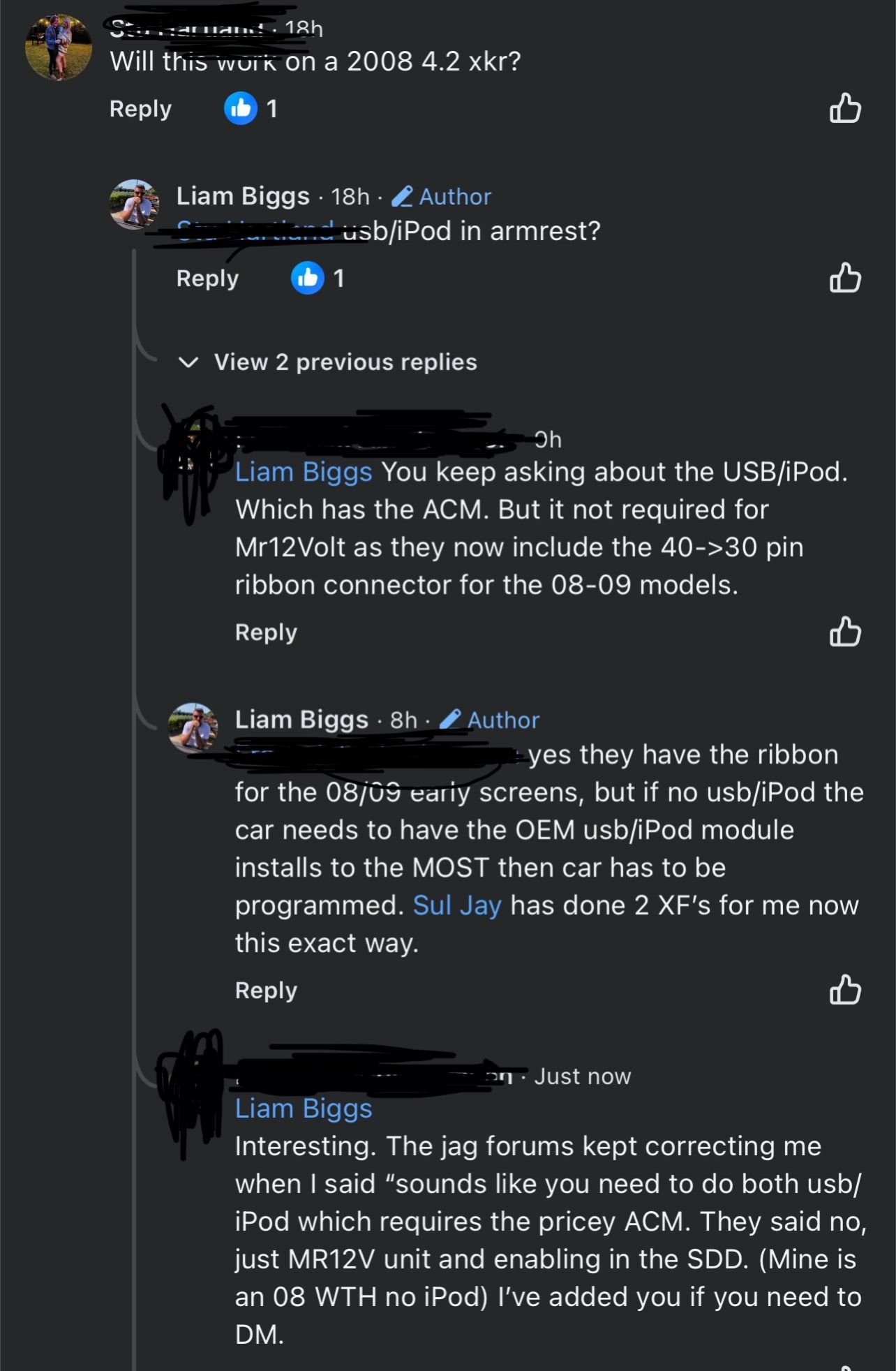

I know the thread is for 07 and up thought we had it all sorted out, 07 and 08-09.
Until last night, my understanding was that installing the ACM and usb/iPod add on was not necessary as the Mr12v unit bypasses this (per @Sean W I think).
So all I needed was the $500 unit from Mr12v with the 40->30 pin ribbon cable and SDD engineering mode to enable AUX.
But then in a FB Jag group, I see a post from Liam Biggs who does mobile installs in England.
He says the usb/iPod addin (which means a pricey used ACM) is required.
I’m going to get to the bottom of this and post what will hopefully be the be all end all Sticky on this subject for 07 and 08-09 MYs.
Here is the convo with Liam:

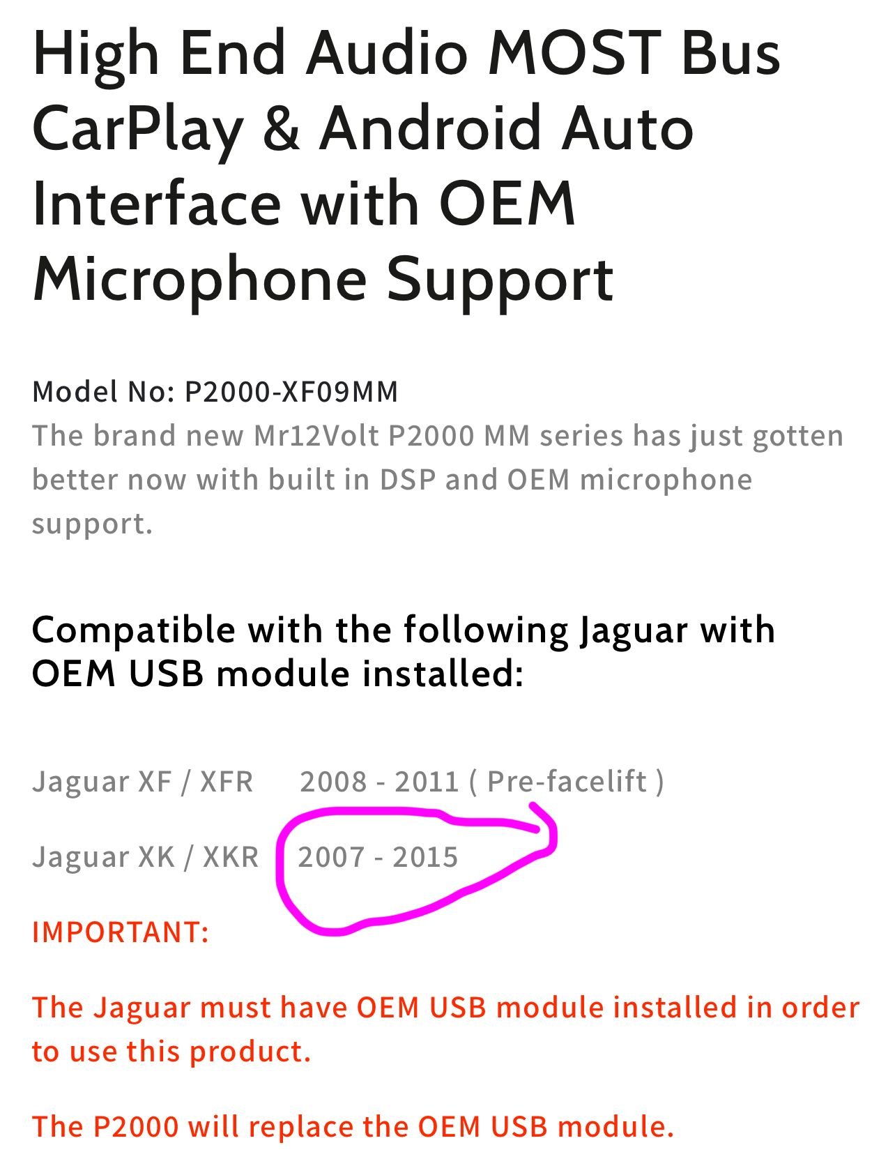

@Circumnavigator , maybe Mr12Volt's documentation will help you put things to rest. Attached at the bottom of this post is their 'Mr12Volt P2000-XF09MM User Guide' and on page 2 it states the following:
Factory USB module under the passenger seat must be disabled with bypass connector supplied in the package.
Then watch the first 1 minute of their installation video at (https://www.mr12volt.com/collections...s/p2000-xf09mm) and you will see how they bypass the USB module.
Then at about 7:30 minutes, they show how to connect their fiber optic cable to your infotainment head unit. So, I’d check to see if your head unit has all the connectors they connect to.
It may be the reason they state the USB module must be installed is to ensure the USB/iPod accessory has been enabled for your infotainment system (which may be done independently using SDD). That same User Guide states, ‘Mr12volt is selected through Portable Audio > USB features of the head unit’, and their website shows the following picture.
Since Mr12Volt is very good with technical support, contact them and tell them that your 2008 does not have the physical USB module installed. And then ask if it will work to simply enable the USB accessory using SDD or do you need to install and enable a USB module only to later bypass it per their instructions. It may be best to contact Mr12Volt directly with your questions.

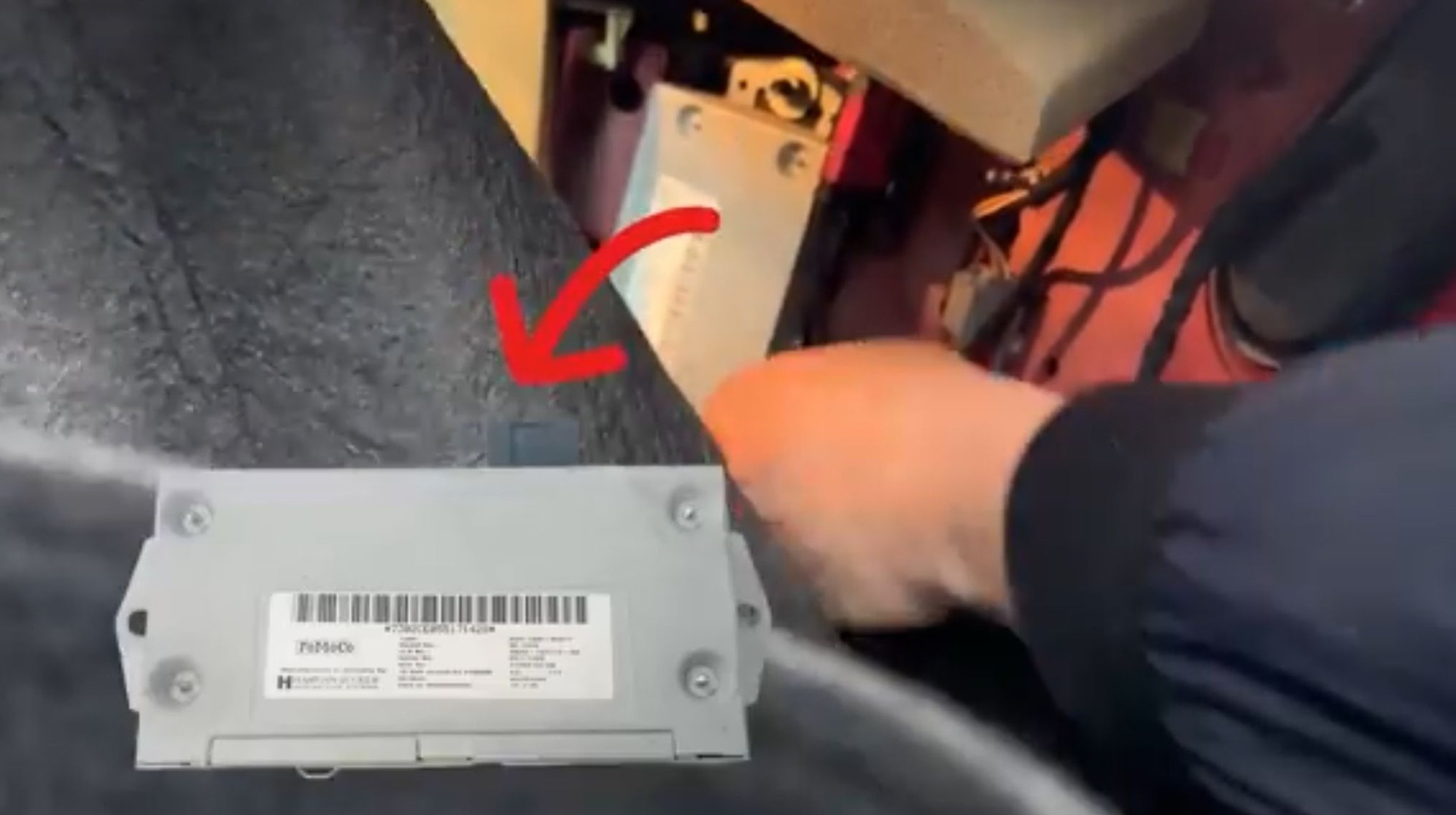

So I watched the first minute of the Mr12Volt installation video and stuck half of my huge *** into the trunk, looking for this:
Which AI identifies as the USB module? So you can use the loop back bypass in the kit.

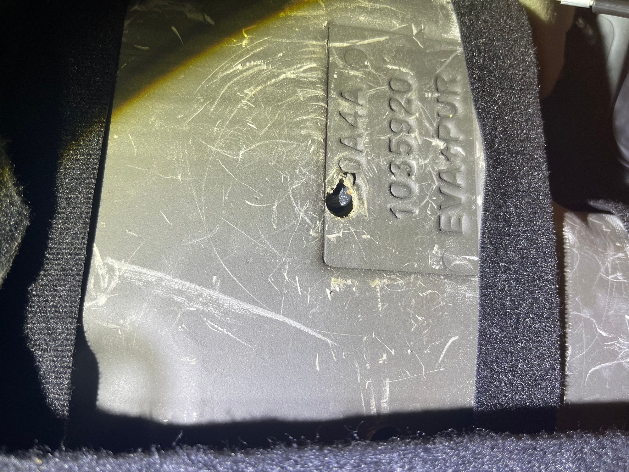

So with flashlight and phone in hand, I open the access panel (remember I have a vert, the video is def a coupe).
And all I see is this, with three straps around it. Strangely the straps are not removable!?!?
I felt around 2 of them and there was no edge.
Ill assume this is the top hydraulic pump covered in some foam protection or noise insulation.
Could the box in the vid be behind that? Umm not probable if it is the pump. Wouldn’t be room.
But before I can find out, I need to know how to get the straps and then that cover off.
....... Could the box in the vid be behind that? Umm not probable if it is the pump. Wouldn’t be room.
Thing is, your car doesn't HAVE the USB module. They are only in the 5.0 cars.
