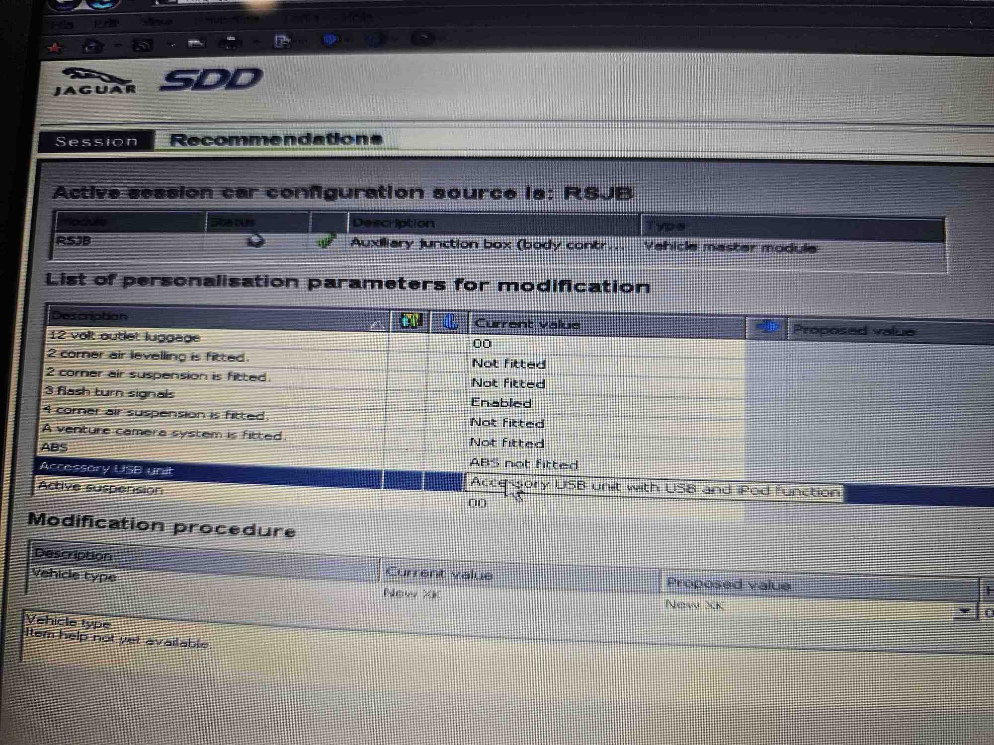

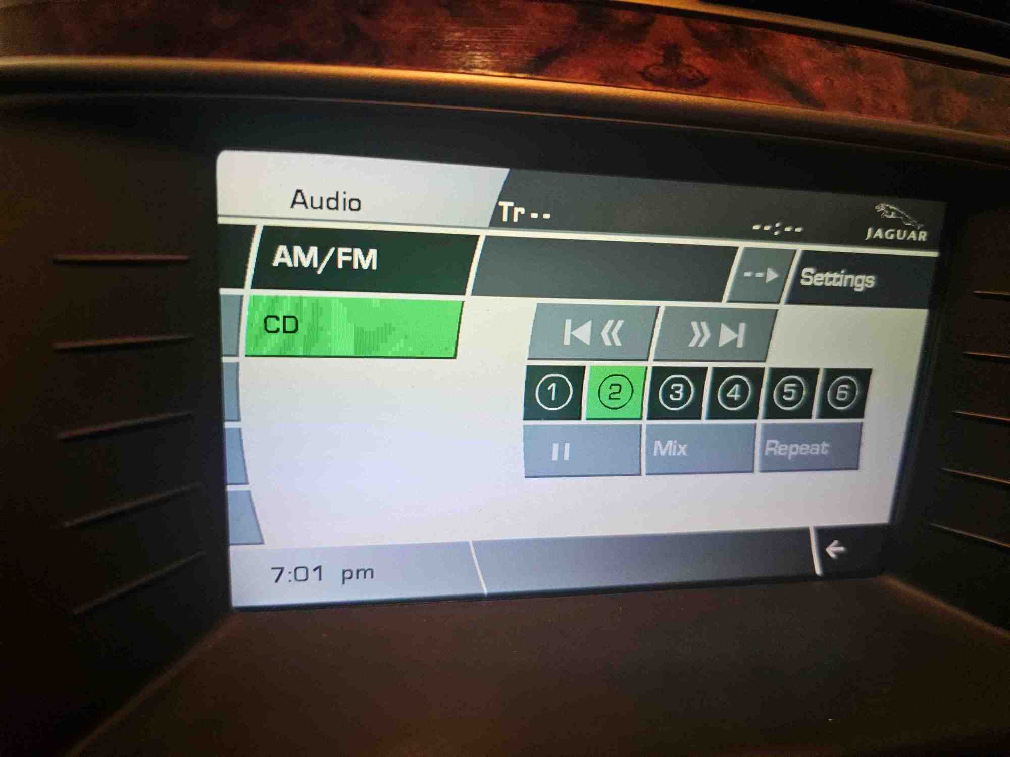

Managed to download and install a v130 on a VM, have engineering access and so on.
I've successfully disabled the AUX input, as it was showing up below CD on my Audio screen.
With it now showing:
AM/FM
CD

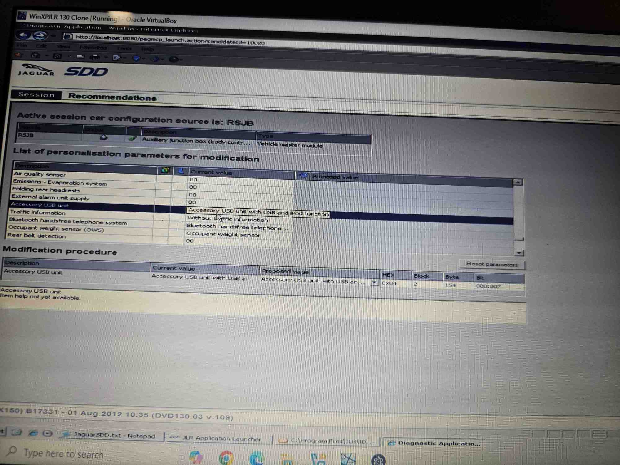

Entered engineering mode successfully (all options in Car configuration management - Current vehicle car configuration modification accessible to adjustment)
At this point my Accessory USB Unit has still been set to "Accessory USB Unit with USB and iPod function"
So I went ahead and set it to "Without accessory USB Unit" as to do a 'fresh' setup.
Proceeded through the wizard to save the new settings.
I re-run the "Car configuration management - Current vehicle car configuration modification" programm
Head down to "Accessory USB Unit"
Enabled "Accessory USB Unit with USB and iPod function"
Green tick to save those settings.

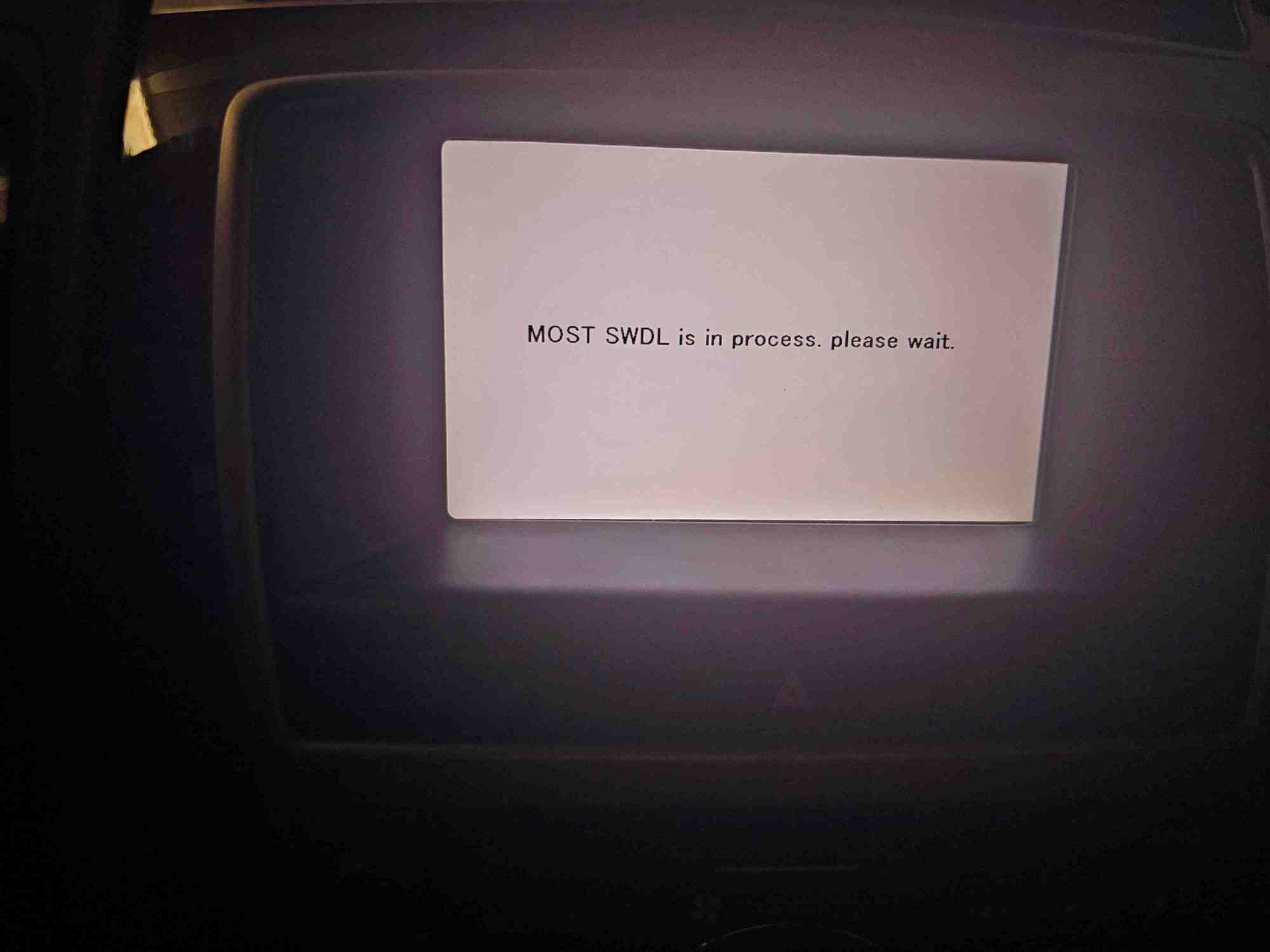

File gets downloaded to car. White screen on infotainment with MOST download screen displaying.
Sequence finished.
Turned ignition back on, Audio still only shows
AM/FM
CD
No sign of Portable Audio...
Are there any other options that I maybe need to turn on?
One thing I'm not sure I have are these extra configuration/as-built files. Would anyone happen to know where I could source them?
As always, help very much appreciated

Successfully downloading new config
Still only AM/FM & CD...
Verified the changes have been made in comparison to As-Built

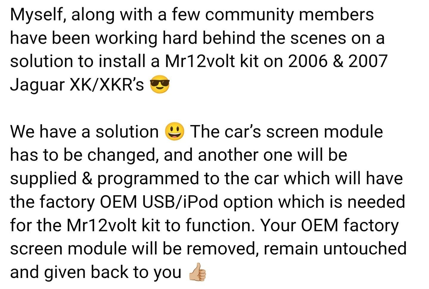

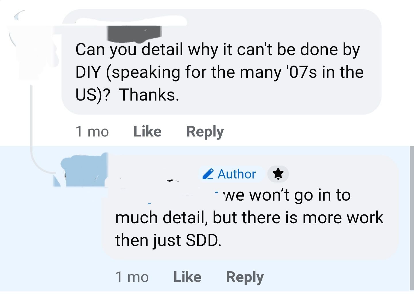

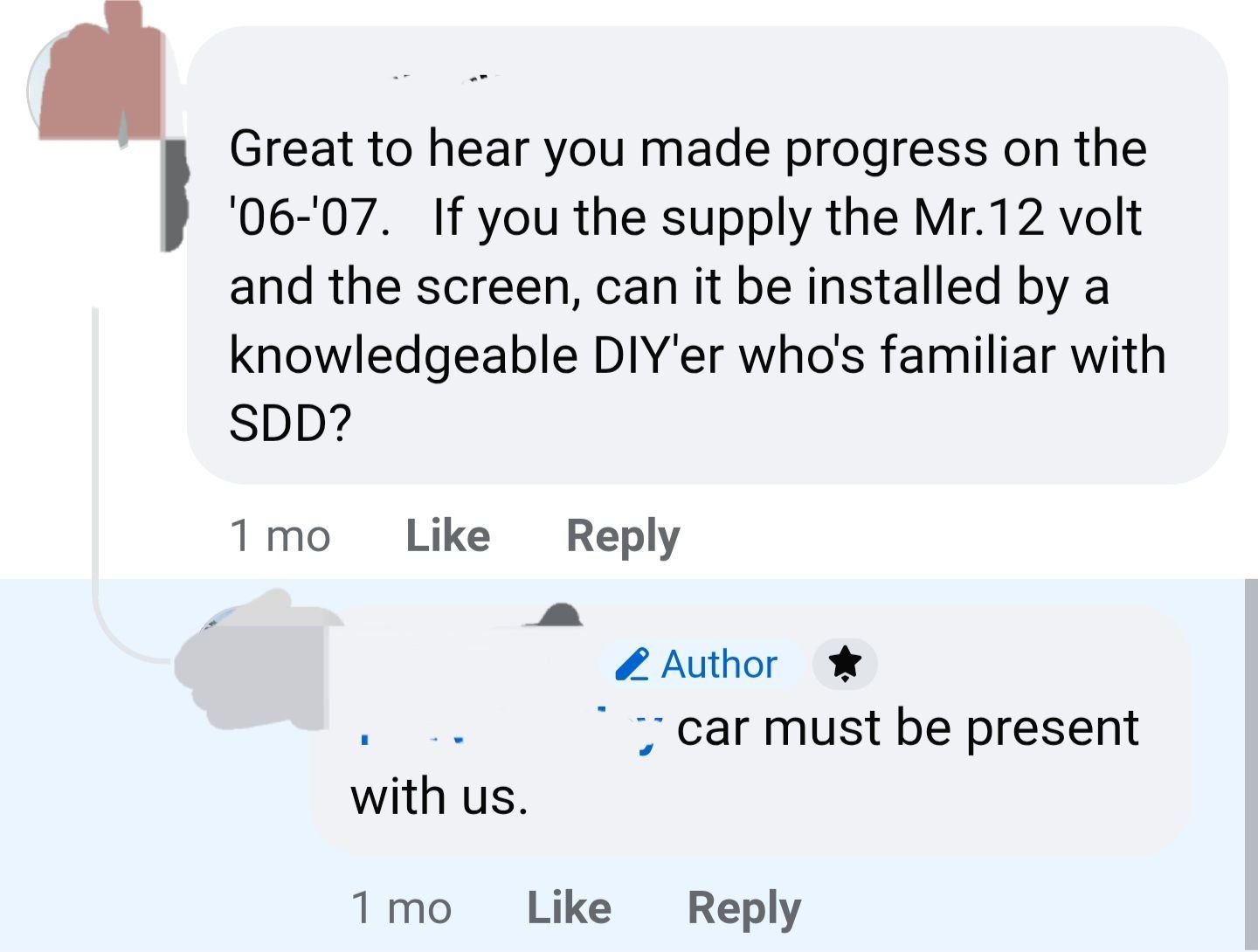

I've been doing more research and have come across a Facebook post saying Mr12Volt have made advancements towards 06/07 models that haven't got USB/iPod functionality.
Apparently it isn't able to be done with just SDD alone, and the company representative will require the car in their possession in order to make changes to the current screen module.
Is there anyone that has an 06/07 XKR, without OEM USB functionality, that has successfully enabled these options on their infotainment system?
Dropping the car off and having someone else do the work isn't really a solution.

The lack of the technical description for the changes has my warning bells going off.

Yes this is Liam Biggs. He sells these upgrades, in England I believe.
Because the screen software (and maybe hardware) of the first year x150s did not have the USB/iPod as even an option, they either replace the screen or flash the software so that it does.
The second year x150 ‘08 in US, ‘07 in UK seems to have it because it was able to add the dealer kit option for USB/iPod.
From what I’ve seen on FB, Liam charges a few hundred bucks premium to flash/replace the head unit (they won’t say which publicly yet) on top of the $470US for the Mr12V unit and all install.
Honestly not a bad option if it works and that’s what you want.
If you are in the US, I had heard here and there that he had contacts at one point on the east coast somewhere that could also do it. But since I have an ‘08 I didn’t track it.
