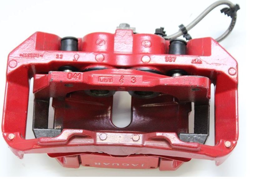

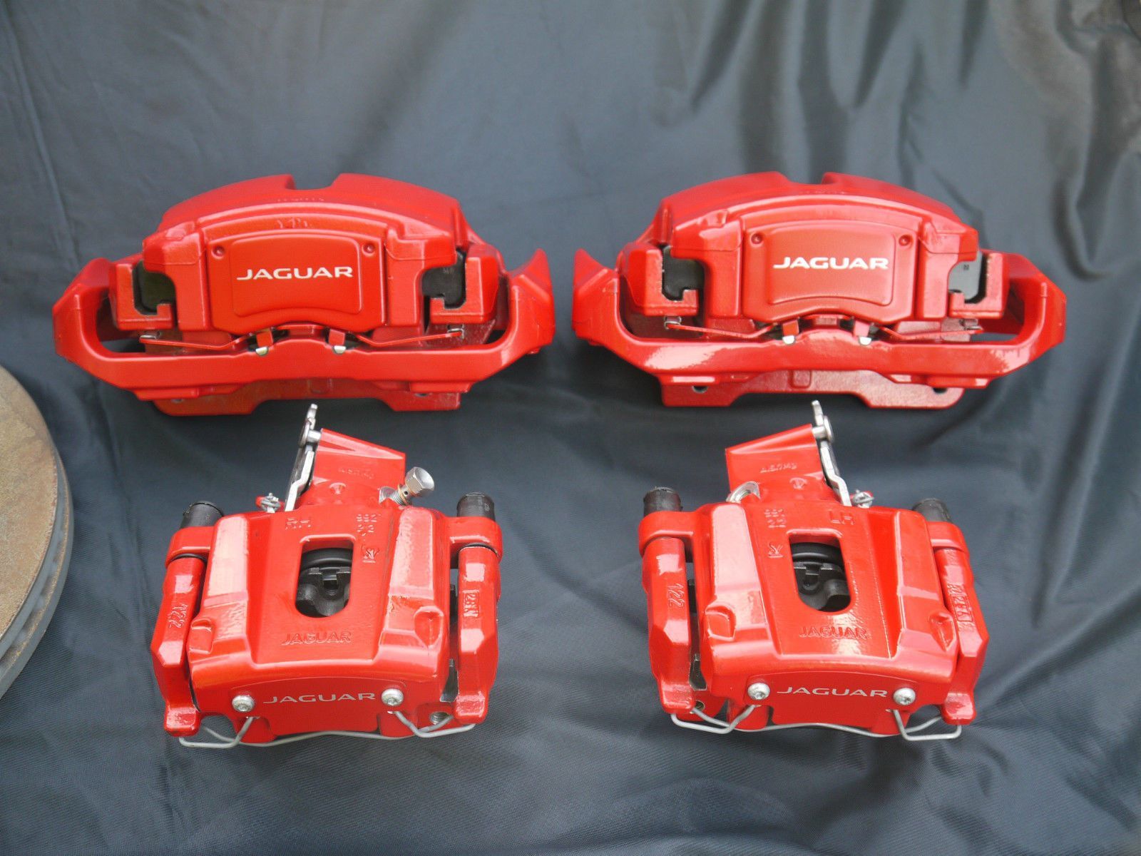

I'm interested in this as well. Looking at the photos, apart from being red I'd say those calipers may well be the same as the 4.2 XKR items. If they are then maybe the only change needed would be to get the different caliper-to-hub brackets and the larger discs. As far as I'm aware, that's the only difference between 5.0 cars with 355mm discs and ones with the 380mm discs.
Anyone able to shed any light on this?

The non-Alcon systems on both the 4.2 and 5.0 cars are different, but they're both made by Continental Teves. So they may have similar mountings - sorry, don't have any definitive answer.

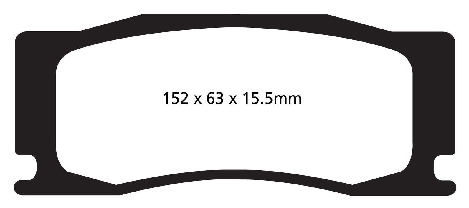

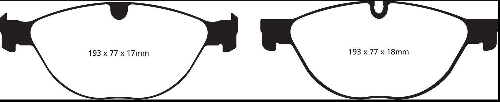

But to answer your question about fitting the 4.2L calipers in the 5.0L carrier to fit the bigger disc, I have some bad news,
4.2L Front
5.0L Front
Alcon Front
I've attached the above pictures which look to put that idea to bed, due to the wider pad mounting lugs - which are located in the carrier for both the 4.2 & 5.0L cars.
But I think it should be possible on the rear. Possibly best trying an up-rated brake fluid and some up-rated pads, to begin with. When I fitted Yellowstuff pads to my Mondeo ( which uses the same brakes as the X-type ) I was really impressed by the difference the pads and better brake fluid made, with the caveat being I did not know how old the fluid was already in the system.

Thanks for that Simon, I never thought to check pads. I guess then to upgrade to 380mm fronts it would be necessary to change the calipers as well as the carriers, plus stone-guards and discs (and maybe other stuff besides).
