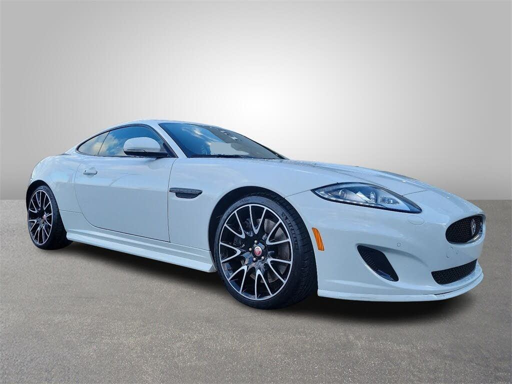

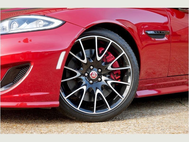

'Dynamic mode' (the button with the checkered flag on) is different from the "Dynamic Pack" that was a factory option on later XKRs. This was a superset of the "Speed Pack" option and comprised engine management and transmission recalibration to allow a top speed of 174mph; larger rear spoiler, side sills and rear diffuser; suspension revisions similar to the XKR-S including stiffer knuckle, revised spring and damper settings etc.; 10mm lower ride height; gloss black 20in. Vortex alloys and black painted brake callipers.

Its just I have never seen a Black callipered car in my hunt for one, Only red! Anyone seen a Black set up?

I purchased this 2014 XKR last December with both Dynamic and Black Pack. It has black calipers.

Does look nice, never seen one with black callipers. Hence the query.
