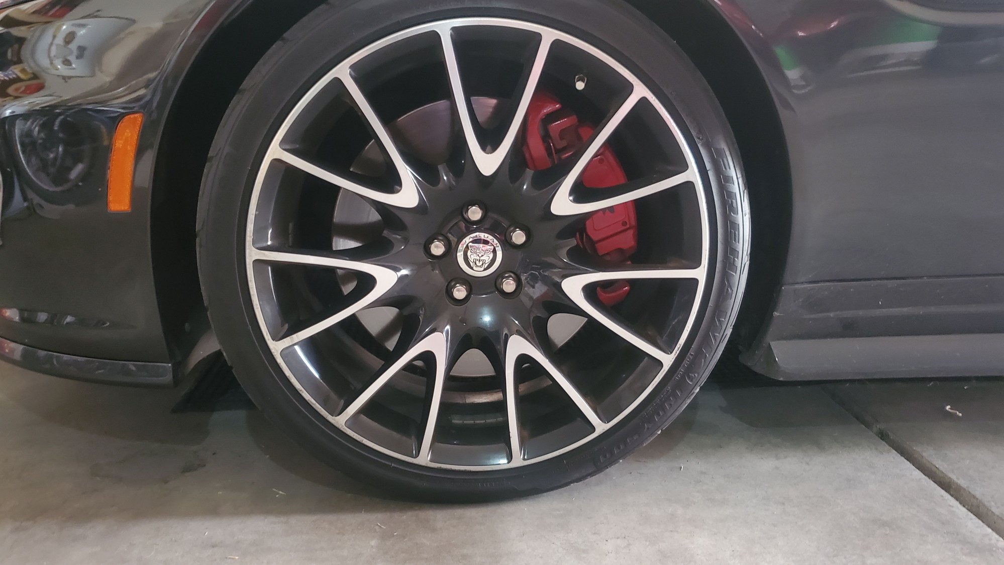

Vistacom1's Avatar
Joined: May 2018
Posts: 88
Likes: 29
From: in my car (WA, USA)
Mine are red also, I wish they were black.
