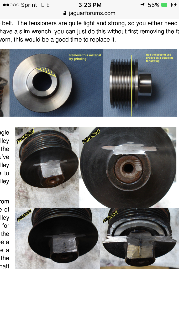

Old Feb 20, 2018 | 06:00 AM
jahummer's Avatar
Joined: Dec 2008
Posts: 6,460
Likes: 2,587
Attached Thumbnails XKR/RS 5.0 TVS Supercharge pulley headaches!-1e9a2f13-aa82-426c-844a-11394884cc01.png
Old Feb 20, 2018 | 09:49 AM
FrickenJag's Avatar
Former Sponsor
Joined: Sep 2014
Posts: 847
Likes: 185
From: Charlotte
This would work on the 4.2 pulley, but not the 5.0 pulley, as the shaft is hidden by the pulley itself.

That was Mandrake who did that cross-hack in the front, he just used a normal 3-jaw.
Old Feb 20, 2018 | 12:25 PM
Mandrake's Avatar
Joined: May 2017
Posts: 463
Likes: 313
From: South Ogden, UT
lol... you have to remove the plastic cap that covers the end of the snout shaft first.
I used an Autozone three jaw puller and it came off no problem once I made those cuts.
