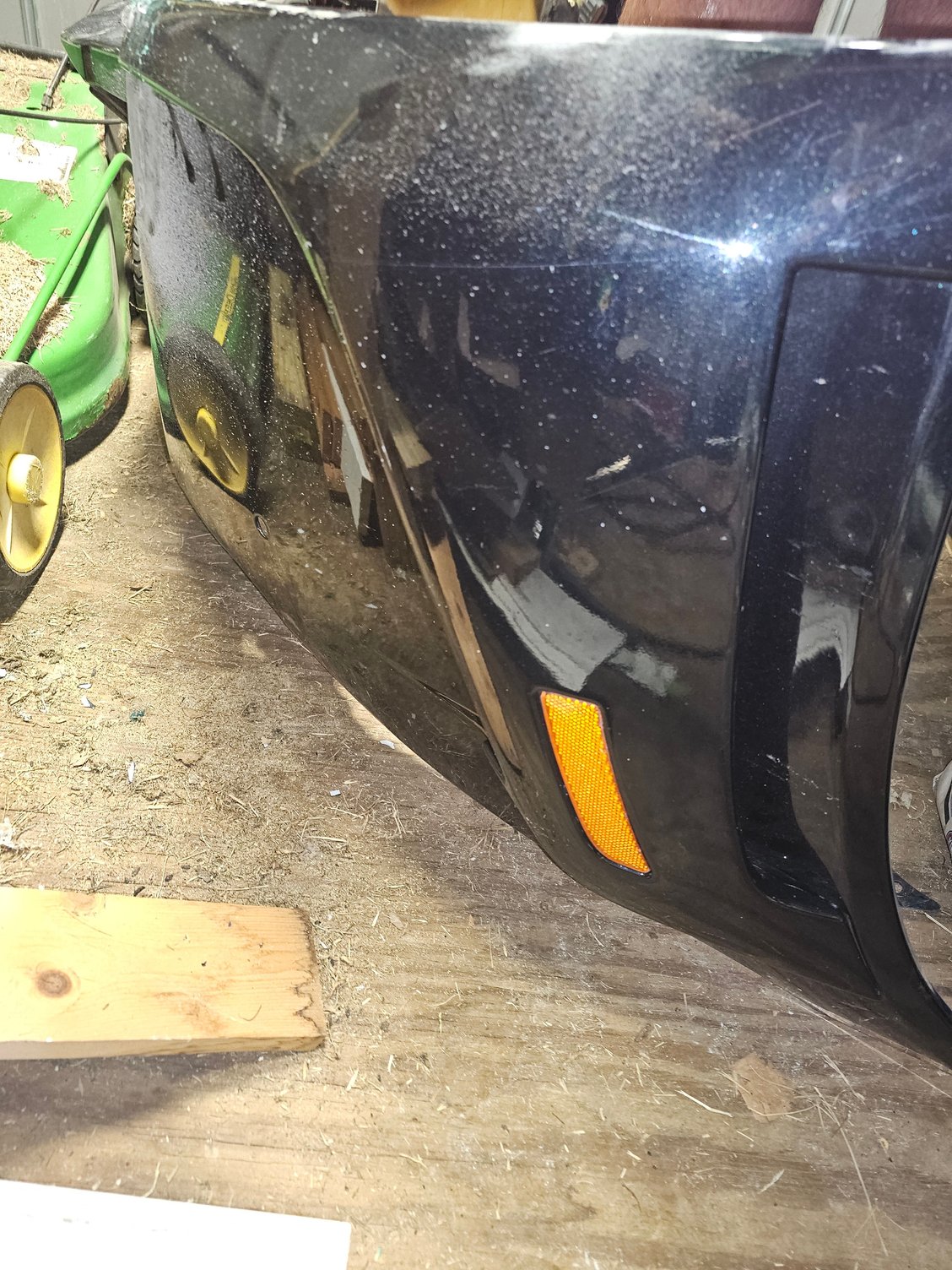

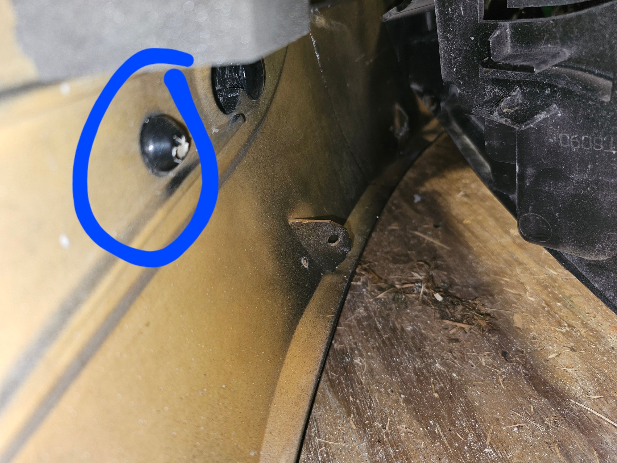

Follow up question.
How do I get the side trim pieces off? I got the cover off and it looks like they're held in with two attachments (not counting the screws at the bottom), one is a click in and slide, the other one looks like a weird plastic piece that snaps or screws in, but I can't see any way to unscrew it. Is that some sort of clip I can just pull out on the outside?

Follow up question.
Pics below
