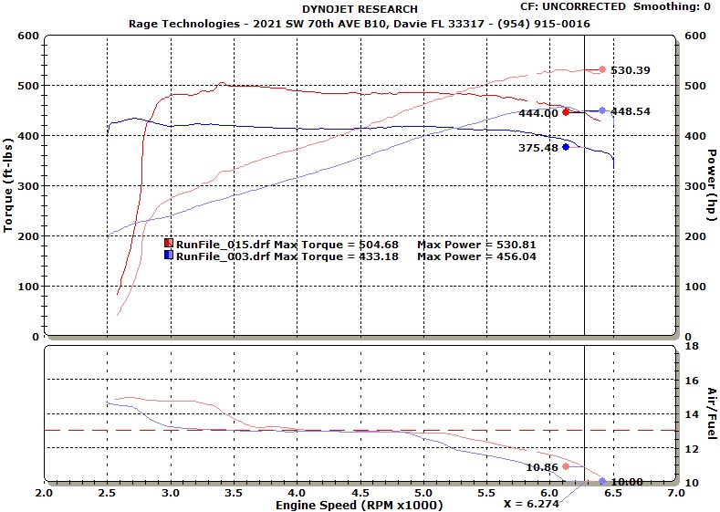

Here is my Dyno which was done on a Dyno Jet.
The environmental conditions were 82.24 F 30.26 in-Hg, 16% Humidity.
Keep in mind I had a pulley on the base run but that really does noting as it just spools to the max 9 PLBS a bit quicker then is cutoff by the ECM. I actually think it hurts it in the upper range.
I also have a RSC Exhaust with a bad baffle, which is causing some added back pressure. Not sure if that made a difference or not my car just sounds like a 747 under heavy load.
I'm really interested to see the before and after Delta as that is the real difference and those cats should help quite a bit. I may be ordering a full Miltek system after these results.
Good luck with the tune I look forward to seeing the numbers!

Nice charts and much appreciated. Can someone, who knows what they're doing, chime in to correct the charts so we may compare them. None the less, Max's uncorrected chart shows significant gains. I hope Russduka achieves similar gains or better. After the tunes the only other test will be track performance numbers. I know Max is waiting for his ECM to come back from Eurocharged after the dealer messed it up.
