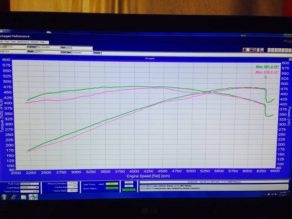

My car put down 481 rwhp in stock form with a "corrected" dyno. This number is very close to Avos's estimate. You can see the correction in the boxes in the lower left of the screen.
I suspect a corrected dyno number for Russduka would be in similar territory, considering both of our cars come with a rated 550hp from the factory. But of course it could also be off a bit because of the difference between dynos. Mine was done on a Dyno Dynamics and his is on a Dyno Jet.
Hopefully his end results will be in the "corrected" 550-560 rwhp range considering the sport cats.

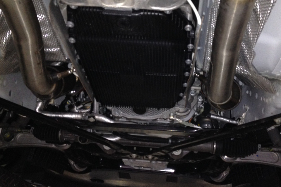

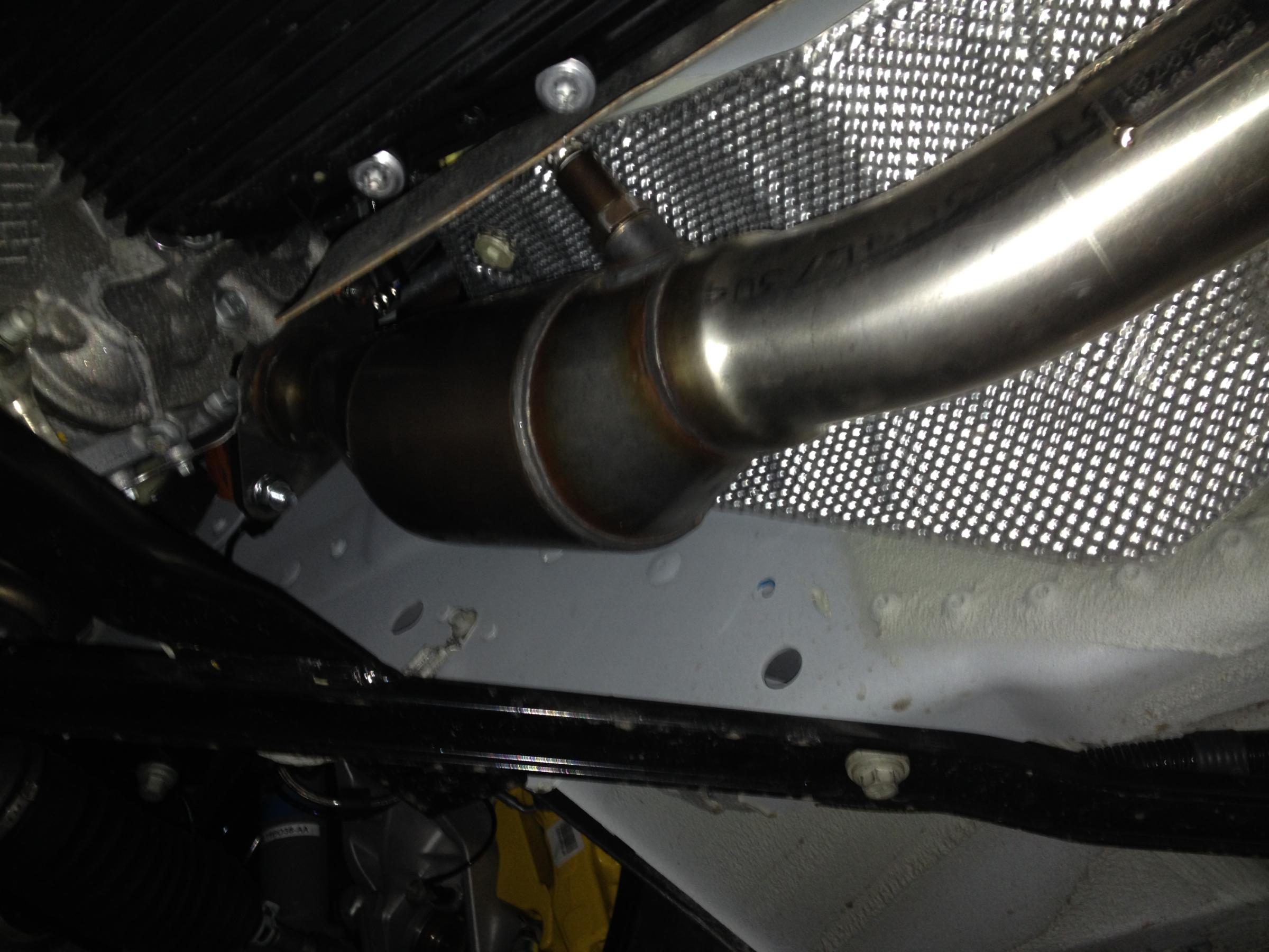

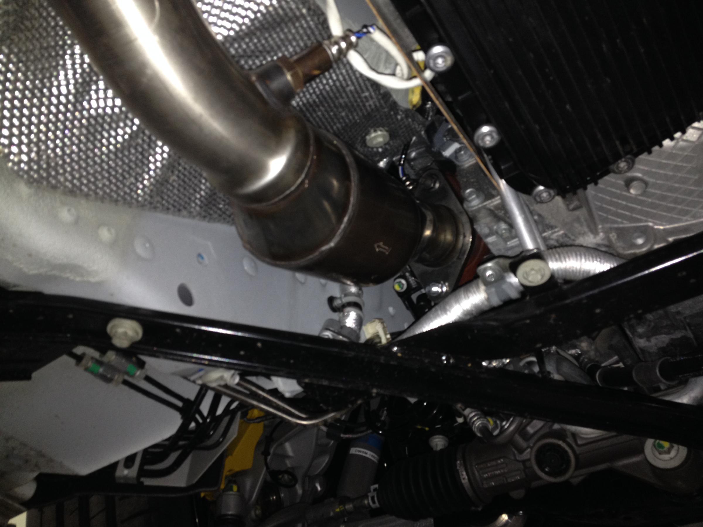

not sure if they did anything for power but with stock exhaust and these hfc's they are worth the money based on sound difference alone
