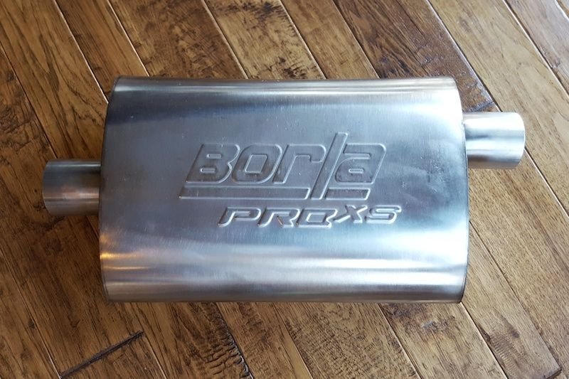

Minor update: I've purchased two
Borla 40357 Mufflers from the Amazon Evil Empire Borla 40357 Mufflers from the Amazon Evil Empire
, which will be installed by my local guy tomorrow. These are 4 x 9" oval mufflers, 14" long. They're also available in 19" long, but I wasn't sure that would fit well under the existing heat shield. I love the noise with no mufflers, but it is excessive. I'm hoping this will be just enough quieter. If they're too quiet I might have cutouts added later. If too loud I could try another type or possibly add resonators between the x-pipe and rear axle.
Borla 40357

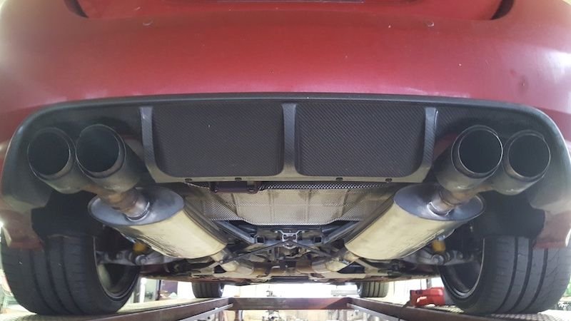

Default Installed!
We cut out the straight pipes and installed the Borla 40357s today, re-using the existing tips. My local guy did a nice job, aligning everything perfectly. Using the offset-in, center-out mufflers, the exhaust is actually a straighter shot from the rear axle back than before. The car is dirty now, I've been driving in the rain and kicking up a lot of pine needles and junk from our forest service roads.
These are straight-through mufflers and I was concerned that they would still be too loud, but I was very surprised how much quieter the car is from inside. I'd say it's about 1/3 as loud inside on startup, and while driving you barely hear the exhaust over the tire noise, which is now much more obvious. Unfortunately, I did lose a lot of the pop and gurgle on overrun, but it's much less tiresome to drive around town or on the highway. With all of the discussion about drone, I was also concerned about this, but it's really undetectable. At low speeds on a slight hill at about 1,500 RPM there is a bit, but it was much, much worse before. If anything, the car seems to pull harder, but I suspect that I'm using more throttle and higher revs because I'm expecting more noise. Cost of the system was $188 for the two mufflers, $240 for installation.
