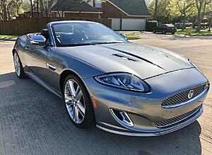

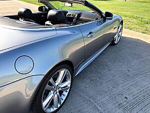

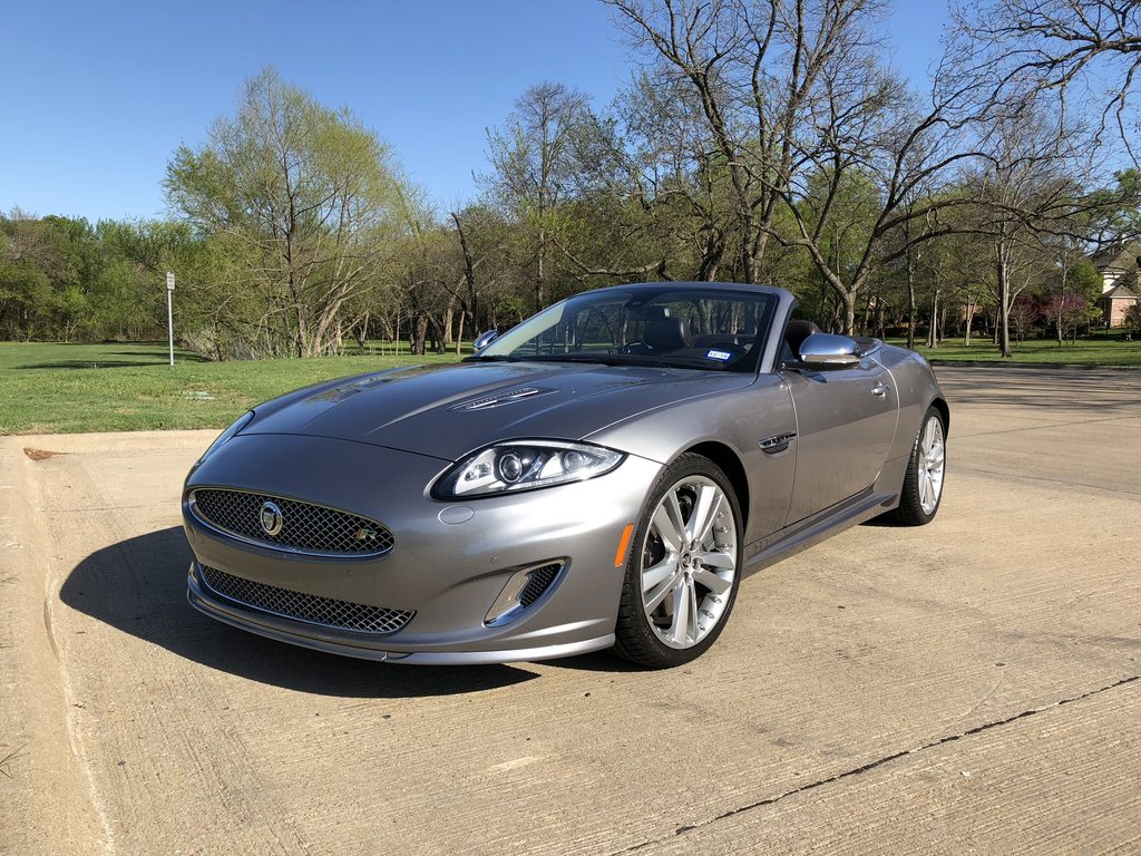

Old Mar 30, 2018 | 08:08 PM
Simon Tan's Avatar
Joined: Nov 2016
Posts: 503
Likes: 291
From: Plano, TX
Smile I did mine!
Big thanks to Jahummer for even coming up with this idea!
I would've thought it to be prohibitively expensive, but in some bizarre twist of Jaguar pricing logic, XKR-S rocker moldings are surprisingly reasonable (less than half the price of standard XK moldings, go figure ) and bolt right on. It's a little hard to capture in photos, but in person the effect is pretty dramatic. My car didn't have the aero kit, so I added the front splitter from it in conjunction with the RS rockers, which I think look cleaner and more integrated than the side skirts from the actual aero kit. Very pleased with the end result!

Old Mar 30, 2018 | 09:00 PM
  #28
TexasTraveler's Avatar
Joined: Jan 2018
Posts: 1,219
Likes: 691
From: Rockwall/Heath TX
Looks Great!!! Well Done!!!
Old Mar 30, 2018 | 09:12 PM
  #29
10XKR's Avatar
Joined: Feb 2018
Posts: 422
Likes: 232
From: Tampa, Florida
Simon,
Looking good!! My Speed Pack Rear Spoiler arrived from the UK yesterday, my RS Rockers are on the slow boat from Jaguar in the UK and are 3-4 weeks out, and my Speed Pack Front Splitter should be here next week! Then the agonizing wait for paint begins....so maybe in 5-6 weeks I will be able to post my own Speed Pack with RS Skirts pics too!!
Thanks to everyone for the pics that inspired me to take the plunge!
Have a great weekend,
Dave

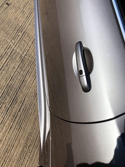

Old Sep 9, 2019 | 11:38 AM
  #35
TraxtarXKR's Avatar
Joined: Apr 2019
Posts: 391
Likes: 151
From: Dallas, TX
Got the XKR-S side skirts in last week. Took a few pictures to compare to the standard skirts.
Material is high-quality unpainted ABS molded plastic. These do not come primed.
You can see how the splash shields (wheel well liners) are the same part, regardless of the skirt... the XKR-S skirts have a deeper lip to cover the extension.
The lip that goes along the skirt is about 25mm lower than the standard skirt., and sticks out about 12mm further.
