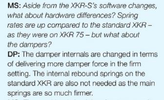

Hi, I am considering a set of used XKRS springs for my 2010 XKR. As the XKRS springs are stiffer, I am concerned about the stock XKR shocks not being able to properly control the added spring rate, and resulting in a compromised ride.
I know that the XKRS shocks are a different part # to mine, so I assume that they are either different internally, or just have different programming. Does anyone know for sure?
The attached is from an interview in the August 2011 Jaguar World with Dave Pooks, JLR Technical Specialist, Vehicle Dynamics.
