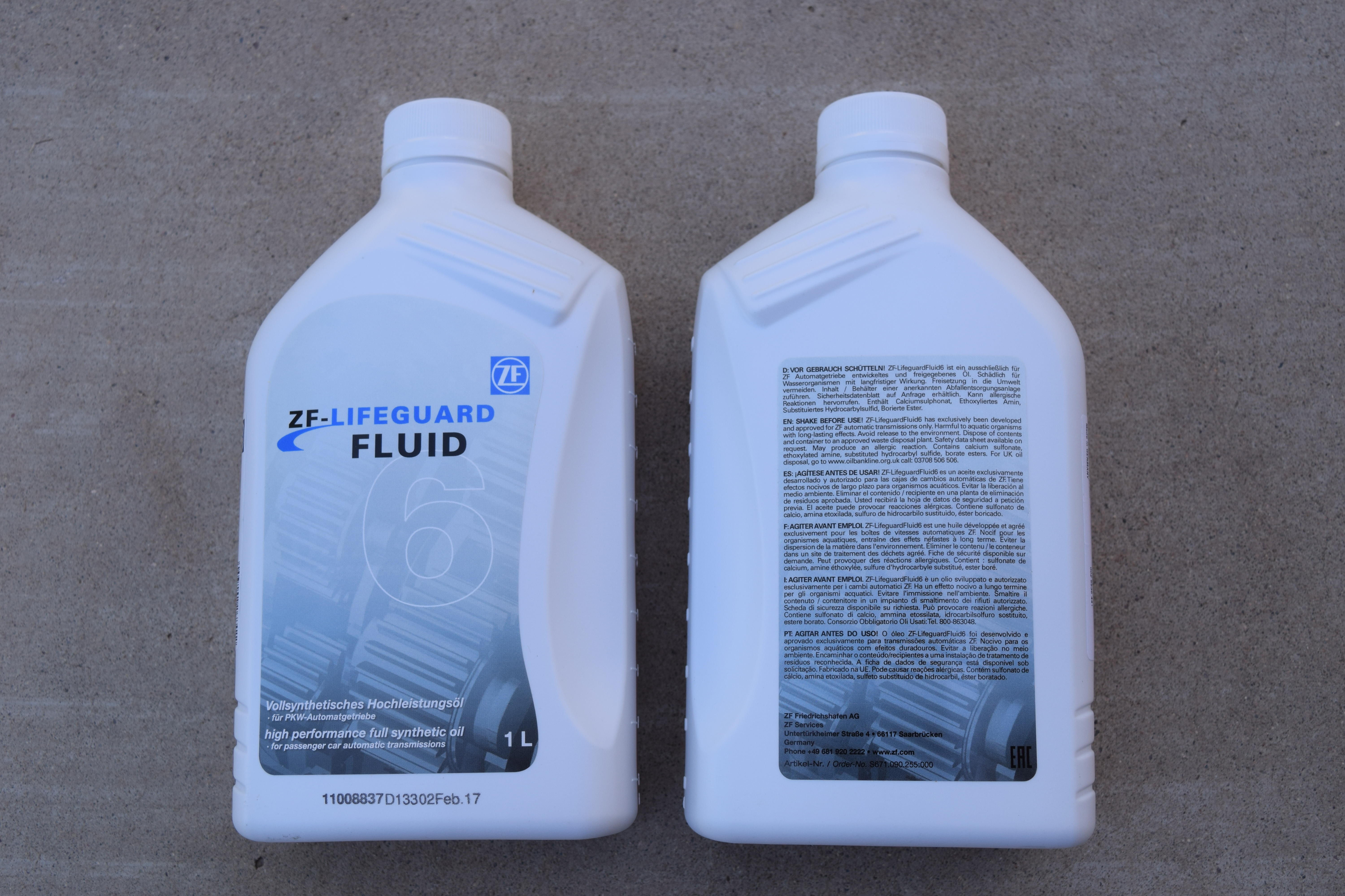

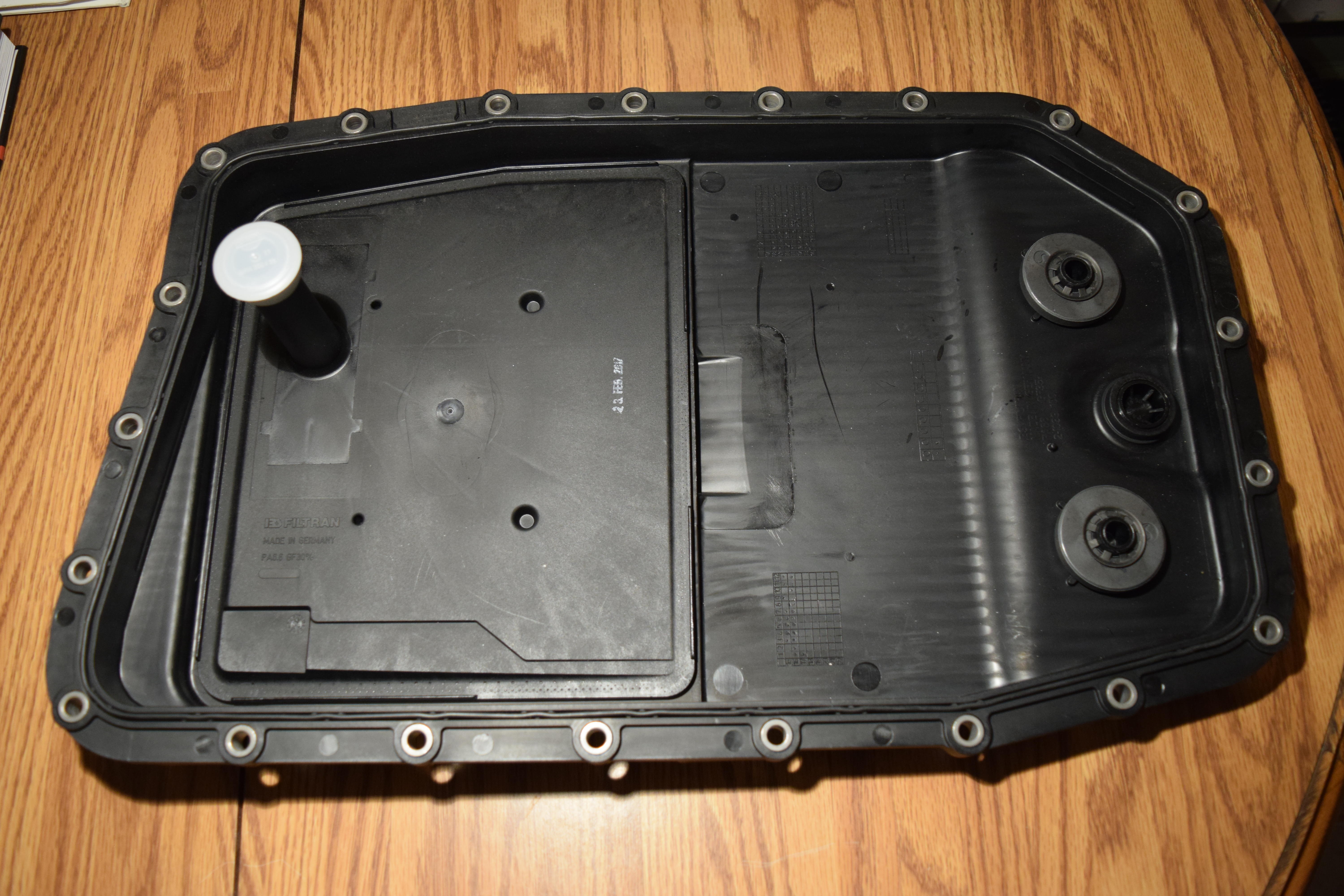

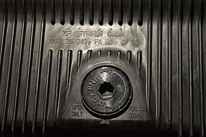

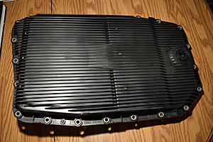

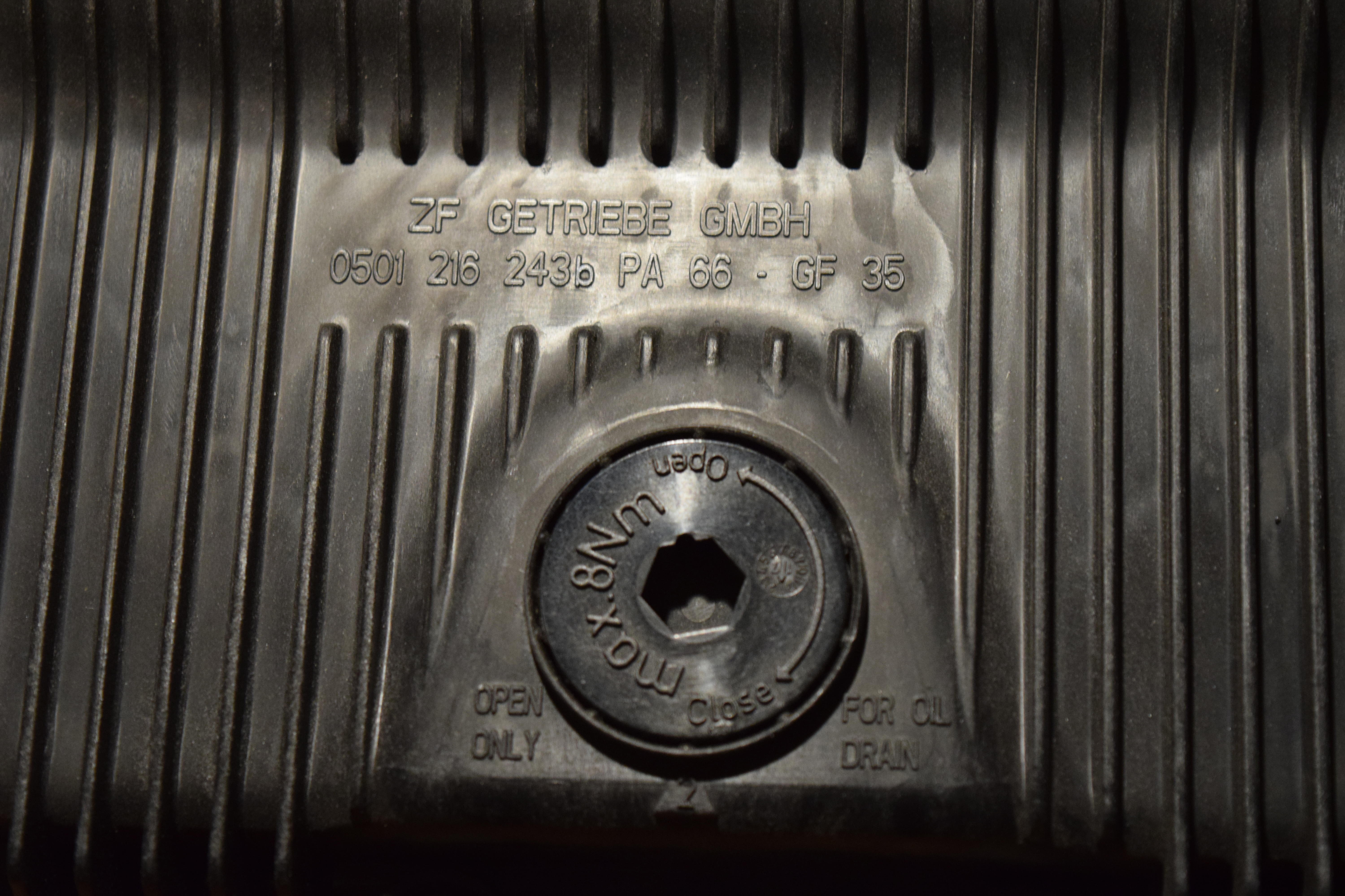

I bought the transmission pan and the 6 liters of ZF-Lifeguard fluid from the eBay vendor recommended by David Christensen in post #6 above. I am happy to recommend that vendor as the order was promptly fulfilled and the price was certainly reasonable (compared to the Jaguar dealer price just for the pan). Each ZF fluid container was separately packaged in a plastic bag to reduce the likelihood of leakage.
Here are a few photos of those items. The fluid and the pan both have date codes in February 2017. Notice the direction to shake the transmission fluid before use...I had not seen that notice on other ATF, in the past.
Tucson Transmission gave me a price of $85 for the pan replacement and fluid fill, so I will have that done in the near future.

My 2007 has logged 81K miles. I had the transmission pan and fluid replaced yesterday at Tucson Transmission. The old pan was original based upon a September 2005 date code. There was very little debris in the pan or the two magnets. I did not have the mechatronic sleeve replaced.
As David C said previously, that repair outlet is very basic with regards to customer amenities, and that is fine. Their pricing is very fair and they did good work.
