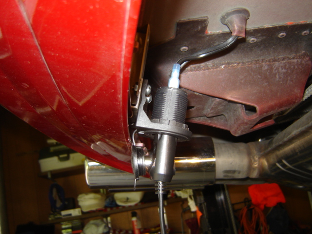

I use it on my hook up.
Have you had any concern about that area on top getting dirty/wet and shorting out between those spade connections?
No as the receptacle is a marine socket and the spade connectors are sealed with RTV when installed. I have been through rain and it has not been an issue. There is also a rubber seal plug that you put in the socket when not in use.
