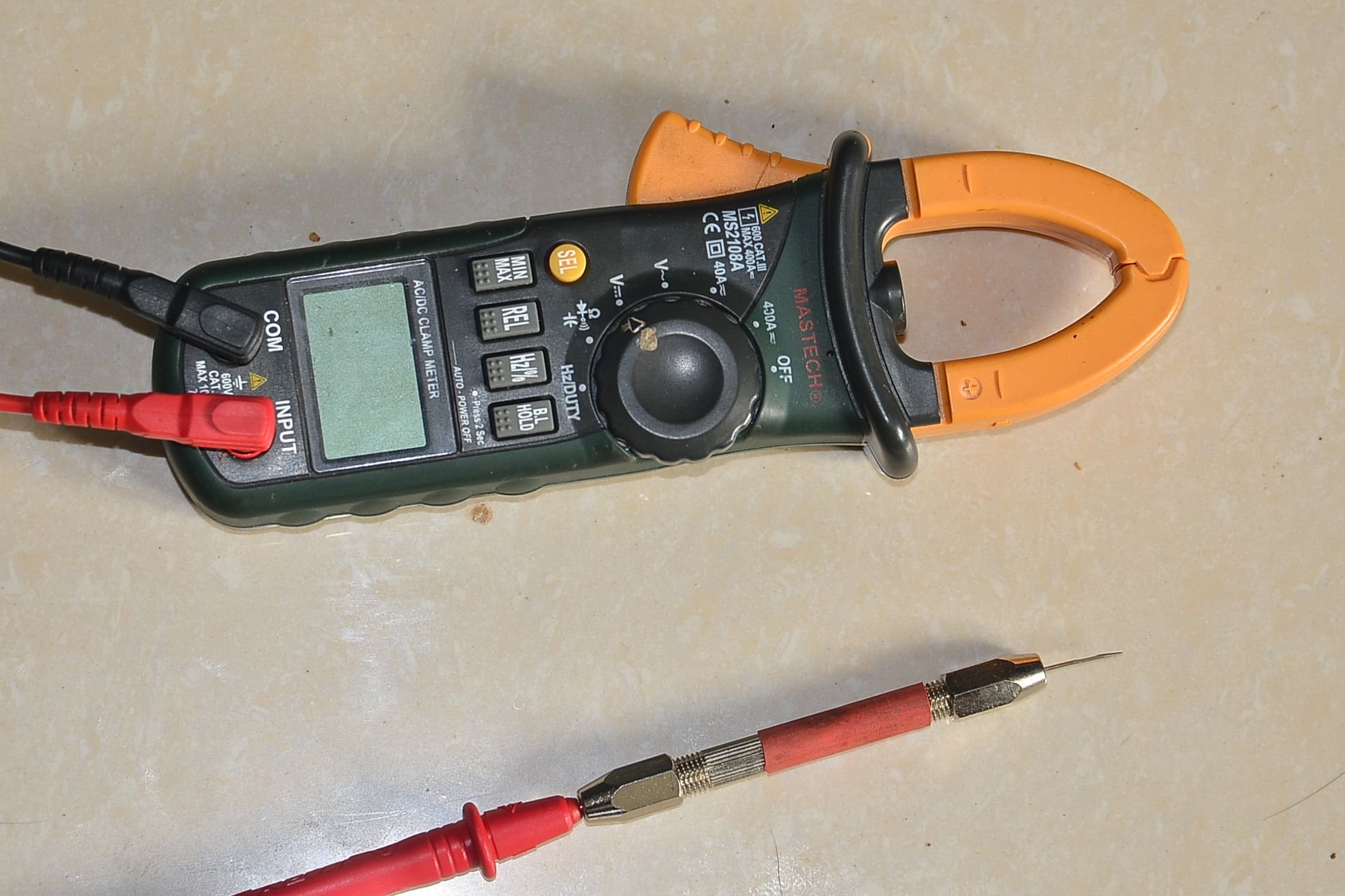

Sounds like an earth fault . You need your voltmeter with a very long neg lead ( 20 ft) attached to the battery neg . Put the positive probe on what should be earthed and you shuould get almost zero ( less than 0.6v) ..if it reads a few volts that earth is faulty. Have the system you are testing turned ON. A pin probe is useful ..A pin chuck with a needle in it to push into those black wires .
Pin chuck available on ebay cheap
