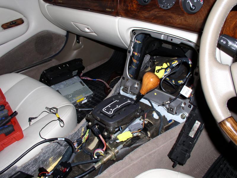

Old Jul 23, 2012 | 09:36 AM
Likes: 17,016
Only the radio affected?
The harness connector is the yellow multiplug visible at the top of the gear lever in this pic:
Not unknown for the black lever lock on this multiplug to come loose. You may just need to pull the radio out and make sure it's properly locked on.
