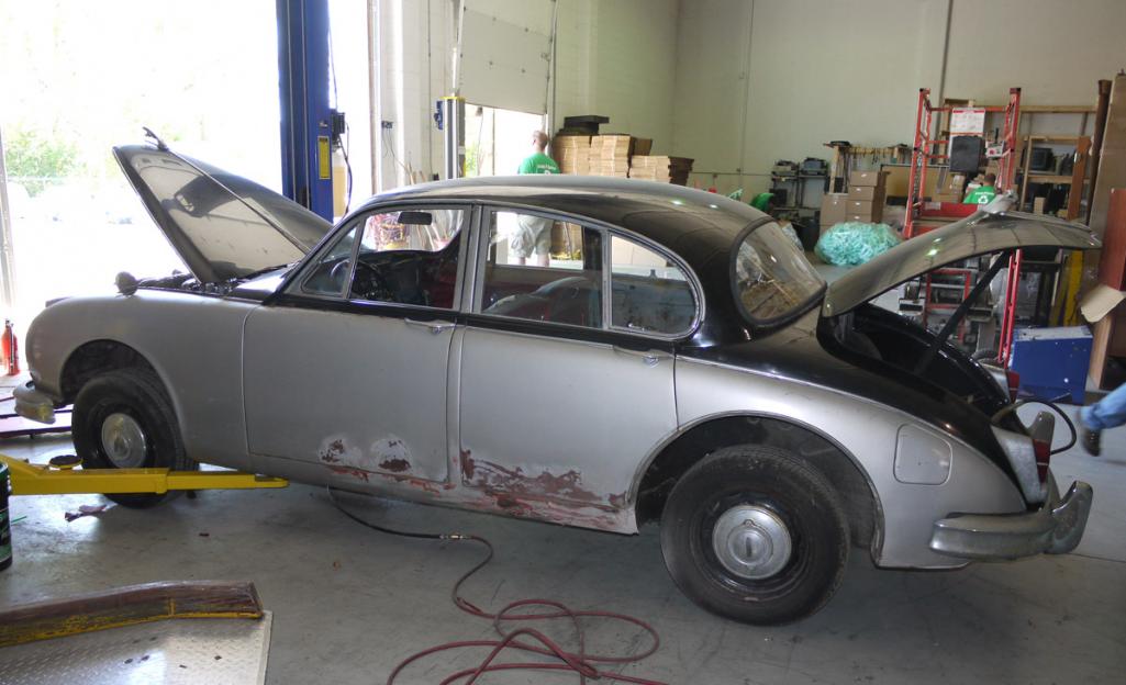

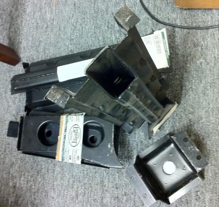

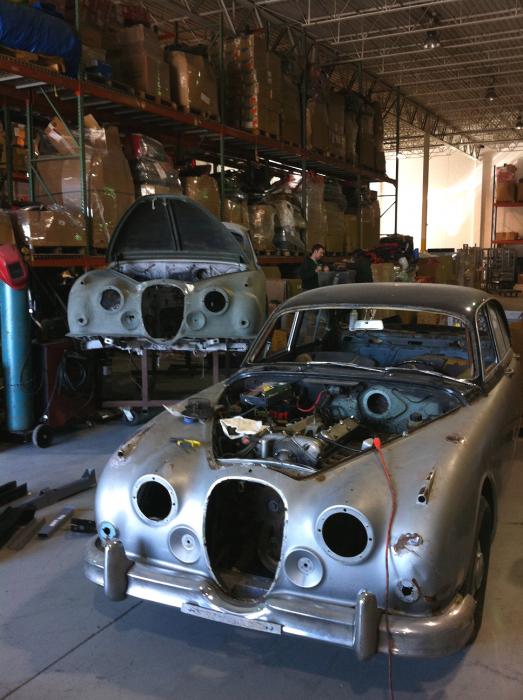

Well, she is on the truck now, will see her before weekend, I hope.
Ofcourse my ultimate goal would be to get into 07+ aluminum version, but one has to start somewhere.
For now, please enjoy my 62 Mark2 project

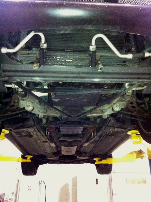

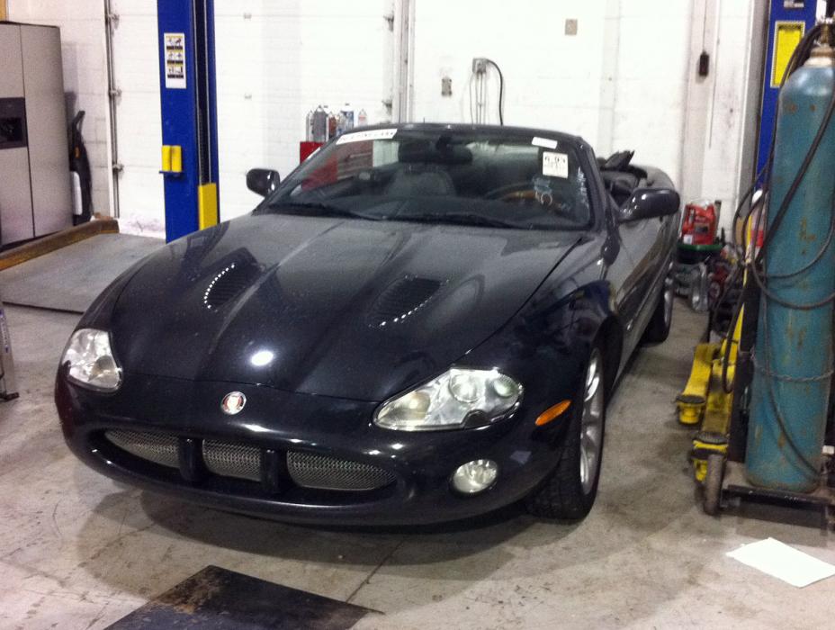

She is here, my beautiful black butterfly!
Here are some pictures.
So far I am happy with my blind purchase, however as expected she has few flaws.
1. steering wheel shakes a little, I suppose this is not that big of a deal
2. convertible top works, but makes hydraulic noise, similar of what Ford Taurus, with low power steering fluid level
3. Power antenna needs lubrication, last segment gets stuck.
4. some redneck mechanics bent rocker panel seems with poor lifting attempt, not too bad, will take me half hour to straighten and re-coat.
5. front bumper cover was never redone, so it has rock chips and one fading clear spot.
6. some wetness on transmission pan, I suppose pan gasket is giving up, perfect time to do transmission tuneup, with filter, gasket and fluid?
7. Ashtray cover does not stay closed, however looks perfectly intact, will research further.
8. traction control button did not want to disengage first time, but later did turn traction off.
9. I FOUND NO LIMITED SLIP DIFFERENTIAL!!! Both, my 62 MK2 and 82 XJS have it, yet $90K new XKR does not?
10. Front wheels have rather agressive negative camber, I suppose it is meant to be?
11. it sat on car transport under some leaky Civic and got transmission fluid all over itself, I cleaned most of it off, but it will take a lot longer to make black car shine, which is the least of my troubles.
On the bright side, underbelly is perfect, not a single bottom scrape. No signs of accidental damage, or repaint. Engine purrs like a kitten, transmission shifts like silk...

Congrats...a beautiful specimen !
Here are a few suggestions:
1. Steering wheel shakes a little, I suppose this is not that big of a deal
Check the inside rims really carefully for dents. If all is good, and tires are OK, try a Roadforce balance before moving on to any more radical fix.
Normal sound
Get Mercedes Benz filter, gasket and fluid and you will save a bunch.
Sometimes regular use is all it needs.
