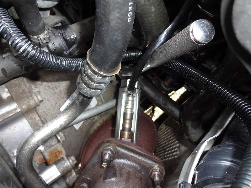

I don't see how the hell getting that one out. I almost can get a wrench on it. Sure I could cut the wires and get a socket on it then, but how would I get the new one tightened in then?
I tried the open ended wrench head on a socket but saw no way to get the wrench head on it.
Good lord expect for the water pump nothing is EASY on this car to repair.
Any suggestions?

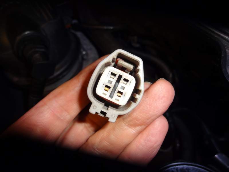

Pull out the connector for the sensor and check the resistance for the heater, it should be around 1ohm when cold. If it is higher then the sensor is incompatible. This part works "Denso DOX-0430".
Measure between the silver pins.

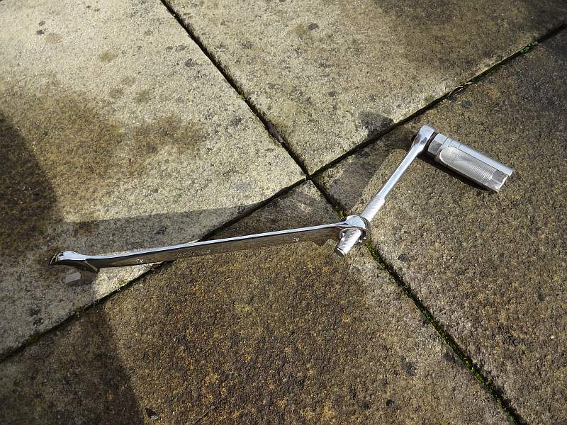

I had a bit of trouble getting mine out. I needed a bit of extra torque.
First I tried fitting a breaker bar, it would not fit in the space available.
Next a 25mm spanner on the end of the lambda socket, but there was no access to turn it.
Then I used a 3/8 socket ratchet but I could not get any purchase on it.
Finally I used the spanner on the end of the ratchet and it easily freed off the sensor.
