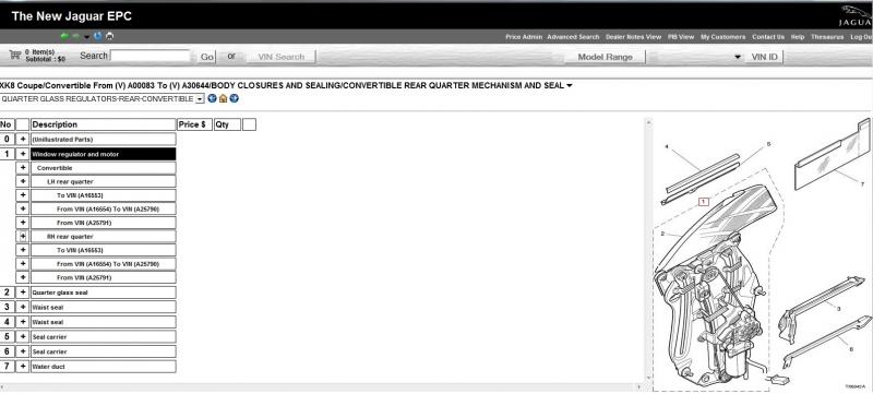

New member and my first post. I have a 01 XK8 I am fixing the rear 1/4 window regulator on. I am looking for some help on replacing the regulator. I have followed some instructions I found here and I have successfully removed the regulator. What parts come on a new regulator? I basically just need the cables and center pull, but I do not think they are available or sold separately.

From the Parts Manual, it looks like your suspicions about the regulator only being available from Jaguar as a unit are correct.
Hopefully someone who has gone through this before can come up with an alternative source for the cables and centre pull.
