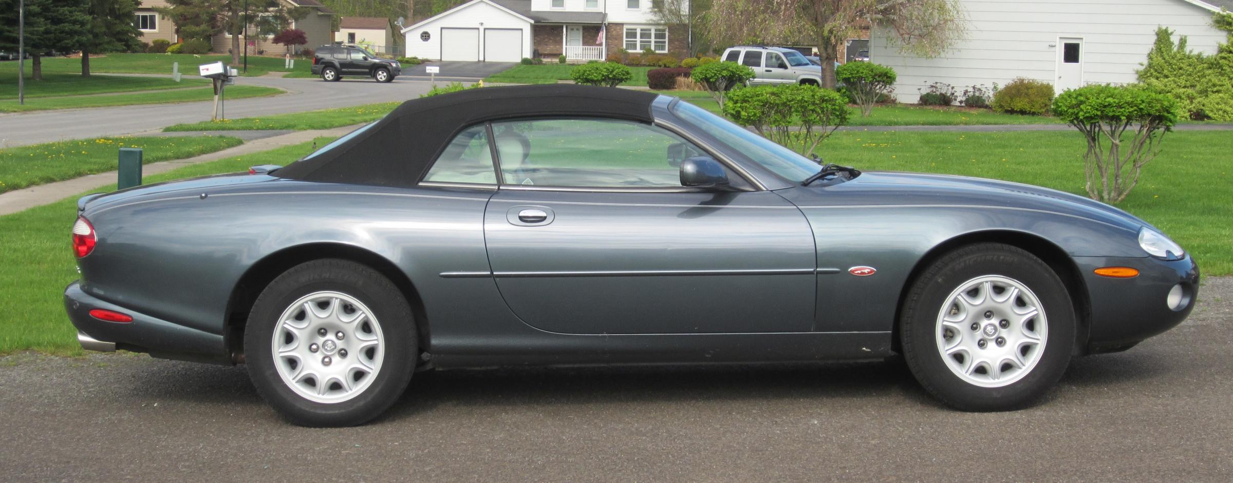

The 18 inch wheel and tire assemblies weighed in at 54 pounds each, the 16 inch wheels with tires are 40 pounds each. It is like removing large moments of inertia, reducing the rotating mass of 4 heavy flywheels. No longer need to spend $250 a tire.
Still have the 13 inch front brake rotors. Might be able to fit some seriously light weight 15 inch racing tires and wheels if I down size to 12 inch diameter rotors, but real spoke wire wheels might look pretty sharp someday.
Attached Thumbnails 16 inch rims-18-17-16.jpg   16 inch rims-sweet-sixteen.jpg

And a much smoother ride as well. I love 16-inch wheels for their ride, their greater number of tire choices, their significant decrease in tire prices, and their longer treadlife. Most folks will frown on the appearance but who cares what they think. Enjoy your practicality....

Not bad. While I wouldn't do it, the color and the wheel type, gives it a late 80's Aston Martin Vantage feel.

I'll bite. What car are those rims from? I wouldn't do anything soon (new tires), but I'm going for a XKE vibe on my XKR, and the larger diameter wheels detract from that. Just saying.

I think the look really suits the XKR. The wheel well arch proportion/fit is very good. The XKR body lends itself very well to many different types of wheel styles. Good job.
