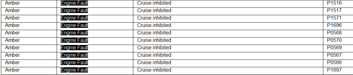

Here's the listing from the JTIS for a 97 give you a starting point but it does sound like a brake switch issue.
Attached Thumbnails 1997 XK8 Engine Fault alarm.  A Head scratcher.-engfault97.png

HAH SCORE! The information from Jamdmyers and Gus did the trick. There are two sets of failure codes that deal with the brake switch and the cruise control switch that are consistent with the display of the amber light, giving a message, but without tripping the check engine light. Tried a test this morning by shutting off the cruise control and then did a drive. No lights and no alarms. I now expect something odd about the cruise control perhaps more than the brake switch (but not 100% sure yet).
BUT with the warning lights out and the cruise control disabled, now I can confidently get this beastie in for service and verification of which codes are displayed without worrying about doing any damage.

According to the DTC Summaries that Gus furnished, the codes for the brake switch failure (P1571) and the codes for the cruise control issues (P0566-P0570) do not generate OBDII codes so I guess it is not surprising to find nothing on the code reader. I'll have time to deal with it in a month or so, but I'll let the Forum know what I find.
