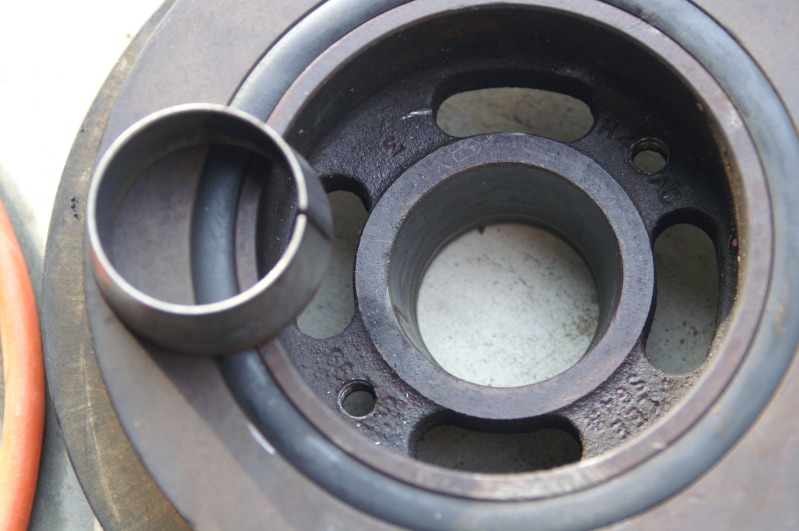

If you can get all the gaskets you need for less than $240, there is a guy that has all the tensioners, chains, and guides for $444 with free shipping... I'm not sure if I can post a link to his auction, so just do a search for cr051948... It might be the same guy but I'm not sure...
Additionally, if your harmonic balancer is like mine, it might be worth an attempt to get the center ring moving before the balancer... Here is mine... I had to use one of those HD puller from Advance...

I think if you soak it with Pblaster or WD40, then tap on just the balancer, it will free up the center ring that locks everything together... Just my 2 cents...
