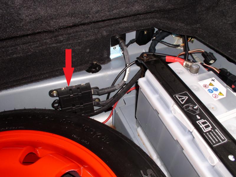

Check the battery main terminal junction box (arrowed in red) in the luggage compartment :
The cable connections are known to work loose. The battery cable to junction box can also deteriorate.

You need to look at the voltage on the battery posts during cranking. If that's OK, as Graham says, you've got a bad contact somewhere. Feel the crimp connectors to the main battery leads. If they get hot that's the problem.
