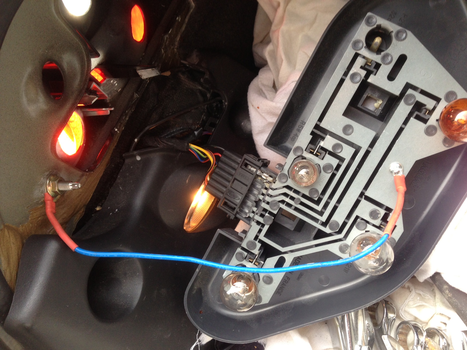

hacker-pschorr I take it that extra wire you put on is a ground?
If so are you connecting other end to body of car?
My female plug just burnt out the same way except terminal 1 in line on both sides burnt out I think I may need a new plug as particular burnt out one the metal crumbled or can I solder a wire direct?
Here are the answers:
1: Yes.
2: Yes
3: If you are adding the bypass wire to ground terminal 1 is no longer used so you do not need a new connector.

Just to verify when I say terminal 1 I am talking about the first hole in the female plug that burnt out that would attach itself normally to first male prong on left I am going to attach an earth lead to that one direct to bodywork; correct ?
Old Mar 5, 2013 | 05:37 AM
steveinfrance's Avatar
Posts: 6,278
Likes: 690
From: Limousin, France
You should ignore the extreme right hand contact in this pic
and take an earth from anywhere on the ground part of the light to car body ground.
The light ground is the large bit of metal that goes around the outside of all the bulbs.

Default Seems to have fixed my light problem
This fix actually seems to have fixed the problem; shoot me down anyone if you think this is a mistake.. Thanks for the solution

Update:
I implemented the GND wire connection from the light assembly to the mounting bolt, checked for continuity to GND to ensure a good connection.
Unfortunately, that did not solve the problem. Directional indicator on dash still flashes at twice the normal rate.
A good thing to do anyway, thanks for the tip.

I had this problem and tried this ground wire fix but it didn't work for me.
So, I switched every bulb from the right side with the bulbs on the left side and the problem stopped! Weird, but as long as it works...

I had the same problem. The addition of the aux. ground wire (example below) solved the problem.
Old Sep 12, 2018 | 01:59 PM
  #37
magnum454's Avatar
Posts: 257
Likes: 14
From: So. Oregon
By the way, I lifted the carpet near the tail light, scraped the paint off, drilled a hole in the metal and screwed the wire to the floor.

It was finally my turn.I got the "Bulb failure" message if I used the right turn signal while braking, or any time the rear fog lamps were on.
British electrical connections at their finest.
I riveted a wire to the ground plate, scraped some paint away from one of the bolts that hold the rear light lens assembly in place, and all is well. I'll do the left side soon.
