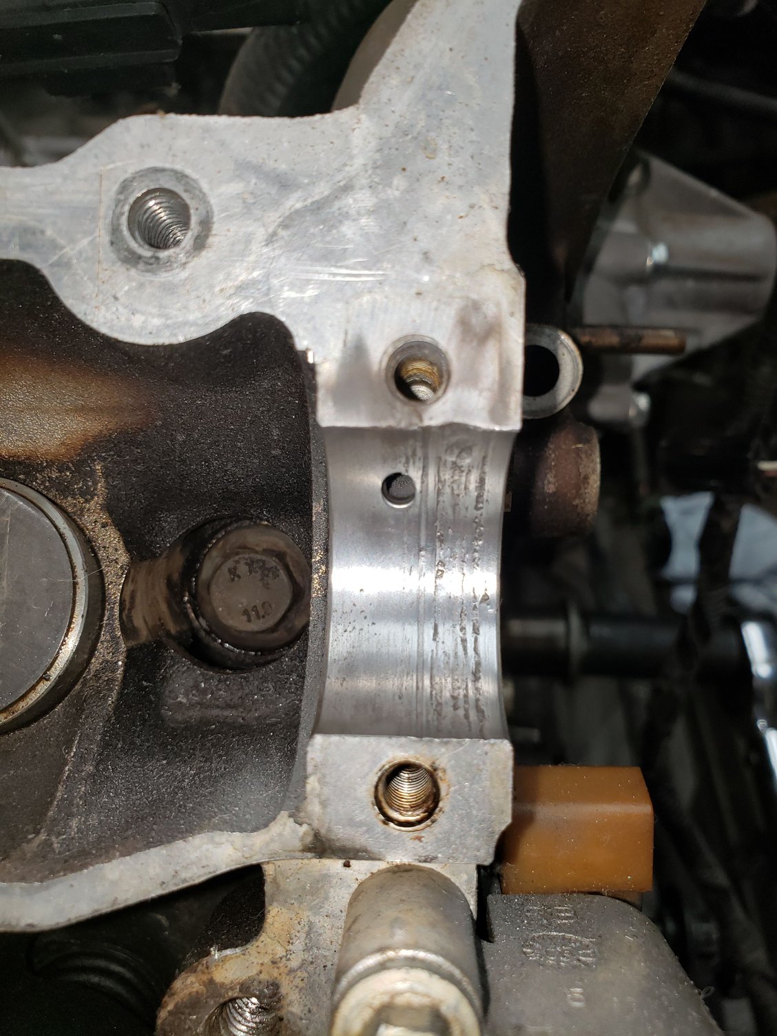

Update!!
Quote: Good luck, but it’s oil starvation that you need to worry about. Scores in mating bearing surfaces will block lubrication. Any lack of contact area will also lead to higher friction temperatures.
If you’re happy with using a Dremel.... why not. It’s your car.
Also have you looked inside to see if you’ve damaged something else. Plus how to set timing from the zero start point where you are now.
I once rebuilt a leaking Turbo, using a kit, long before but still took it to a specialist shop for checking and testing trueness.
Advise you to do the same .....
The oil starvation came from a time when I rebuilt the engine and failed to apply ep-90 (essentially modern day diff fluid) to the matting surfaces of the camshaft and cylinder head and camshaft caps. I contemplated using an aluminum based epoxy but came to the conclusion that an epoxy would break down after 300 degrees Fahrenheit. I have heard about people welding aluminum on the damaged surfaces then boring it (and working it) back to spec. I do appreciate your comments and hope you stay In tune with the progress of this rebuild. No I have at this point not gone deeper (if you will) into the engine.
This is an image of the (RH) cylinder head matting surface ( improper camshaft install-Failure to lube camshaft matting surface) after repair.
Timing: the triangle has been located and the setting peg (non-existant) has been analyzed as waste of currency. Failure to comply with the proper install guide will result in failure. Proper application will not. Or as reference to Rui EV ( fines are a tax for bad people taxes are a fine for good people)....

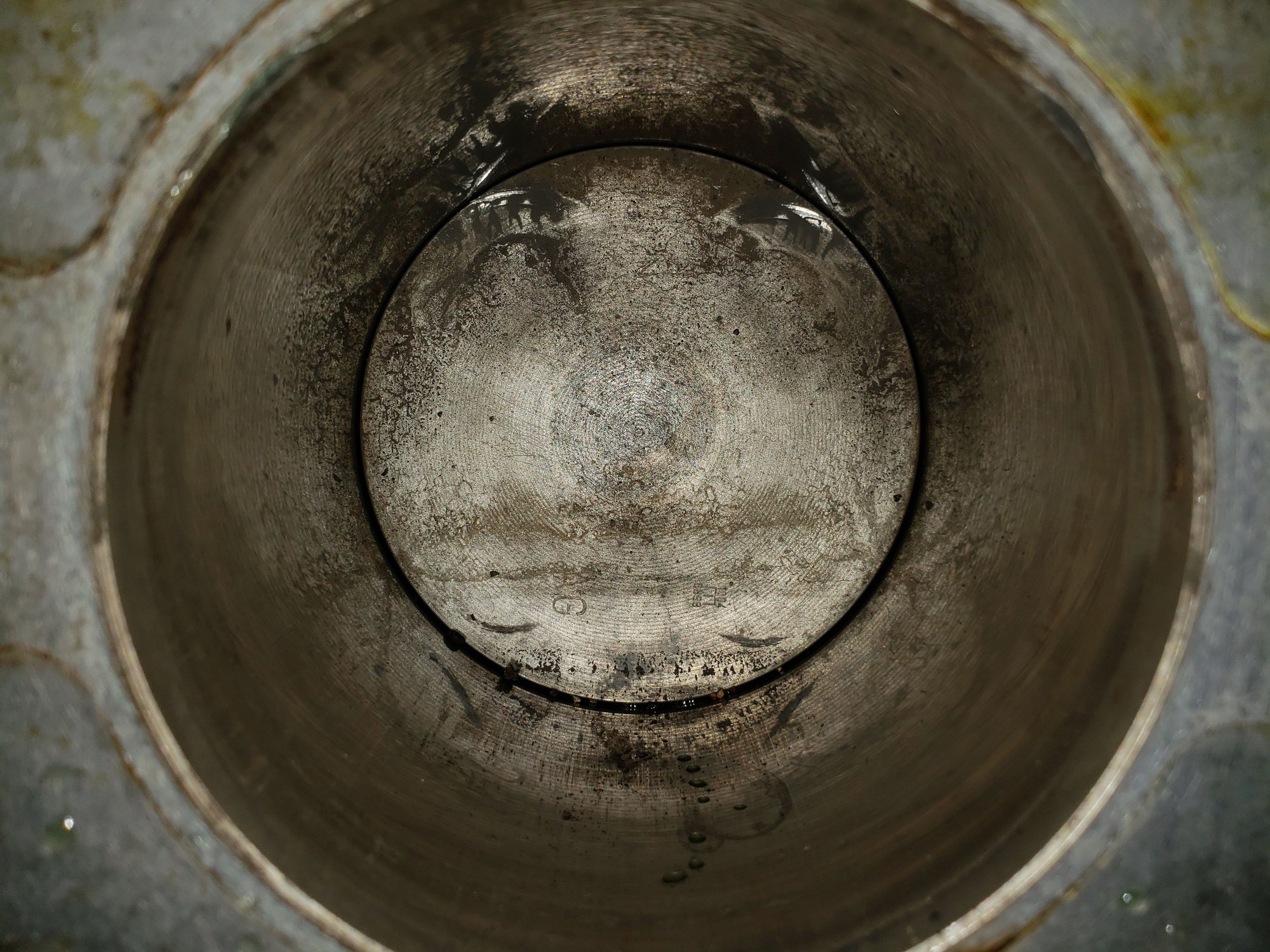

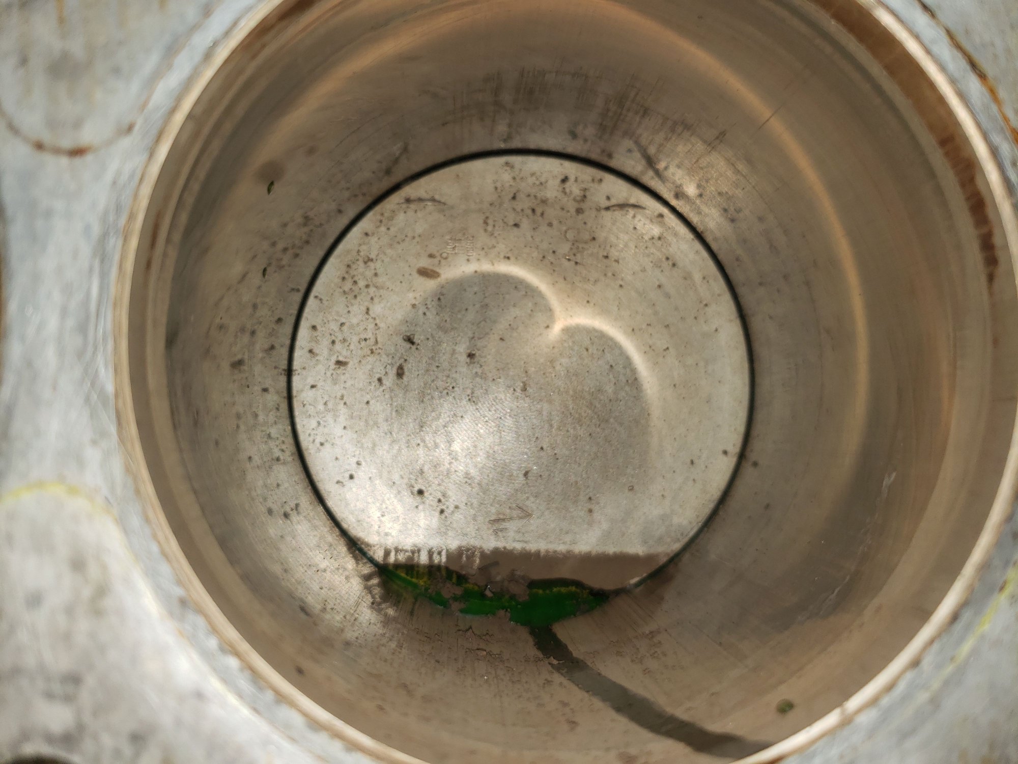

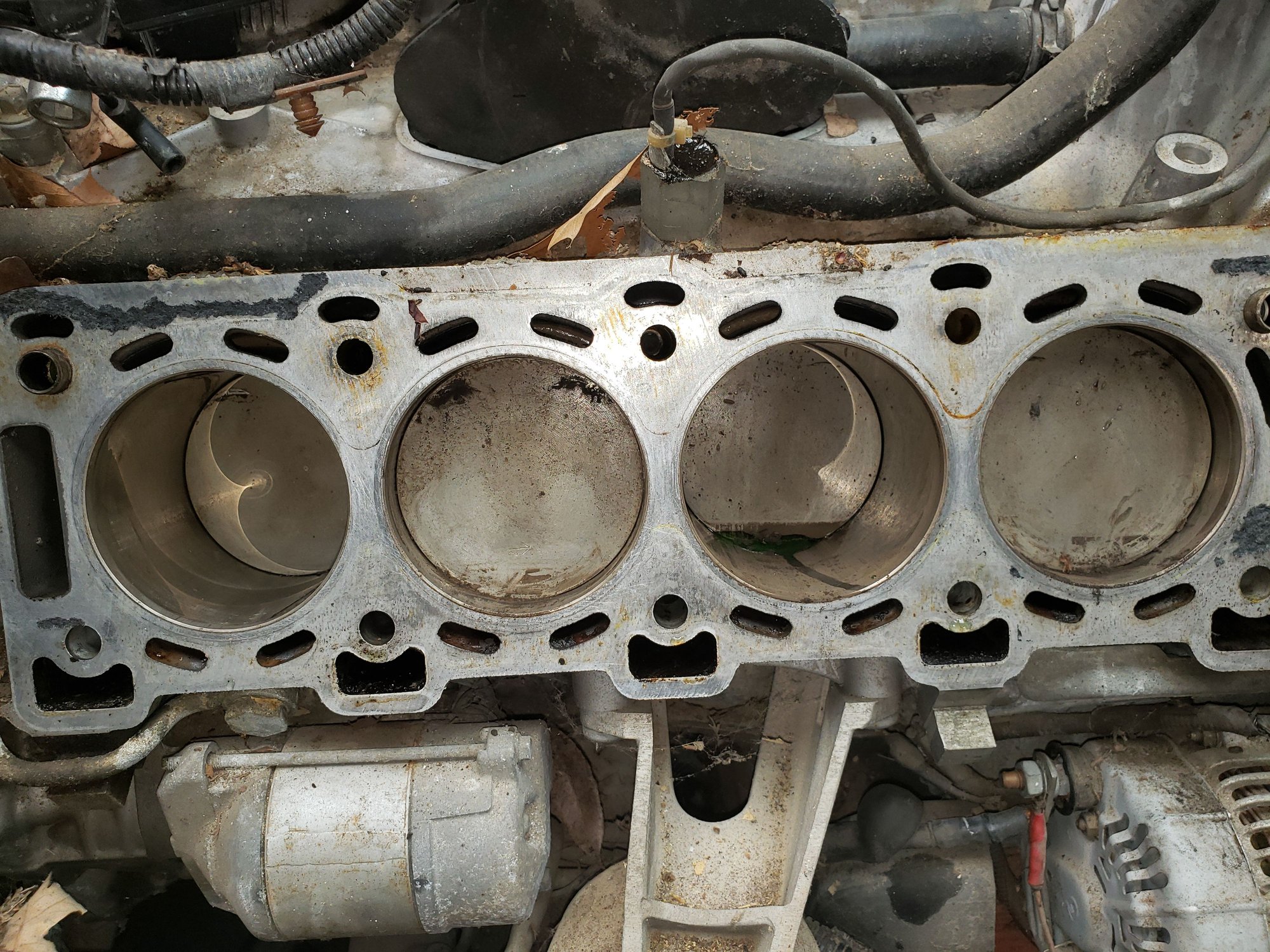

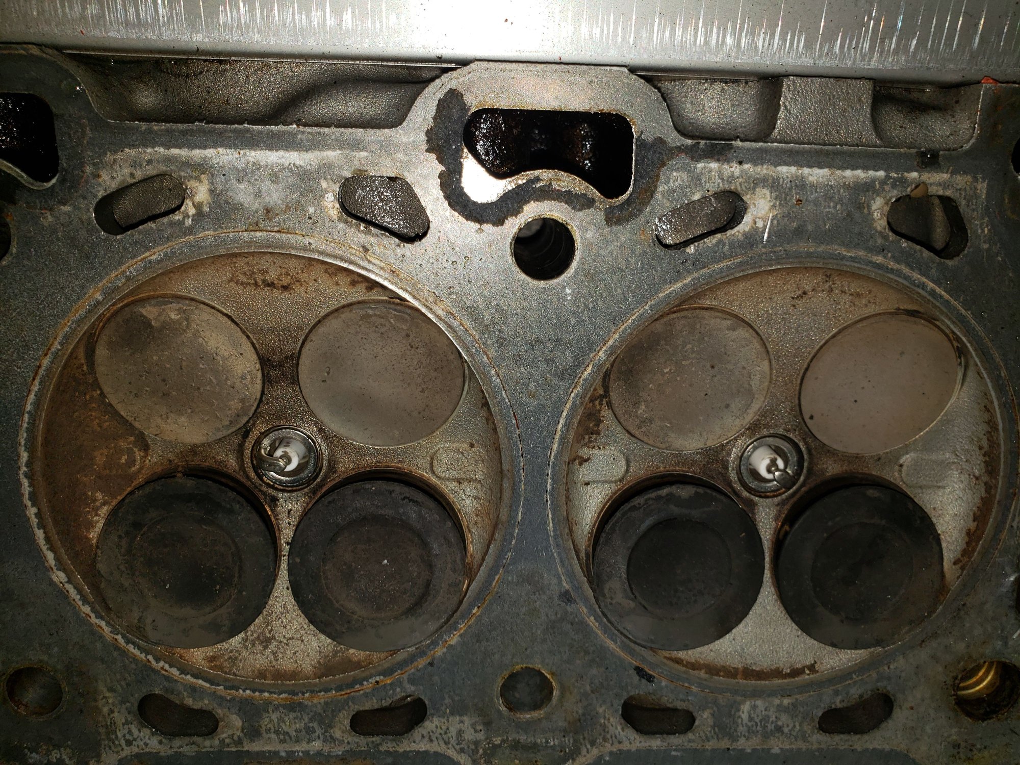

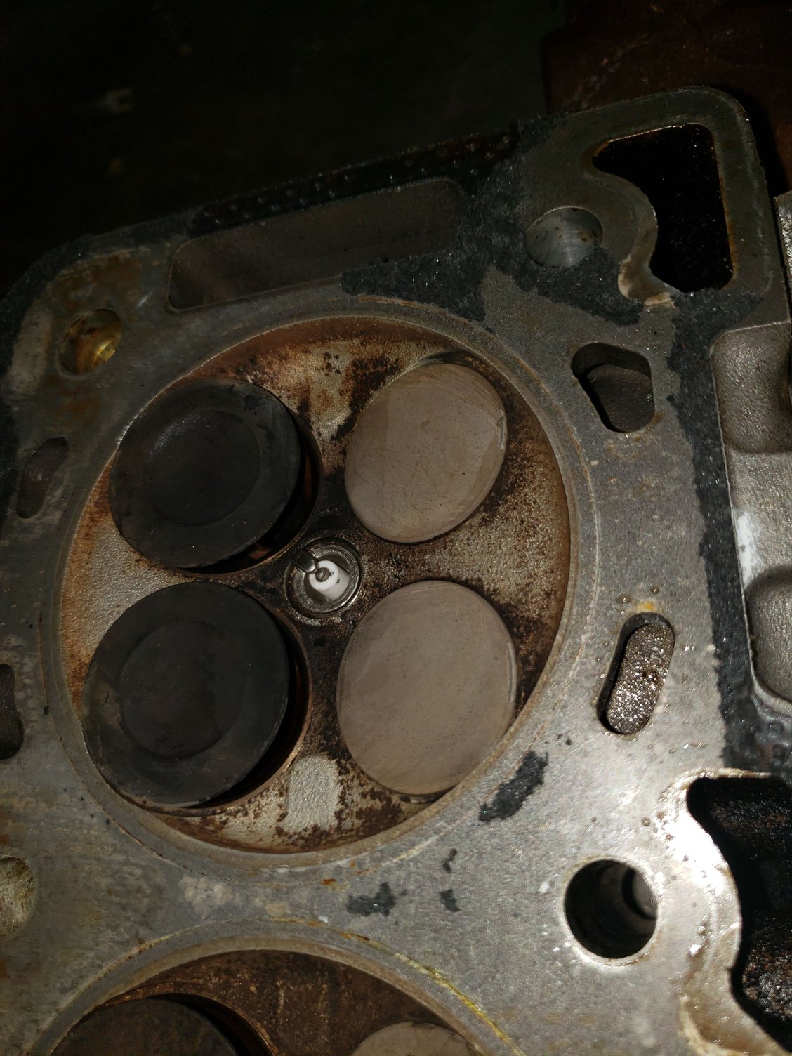

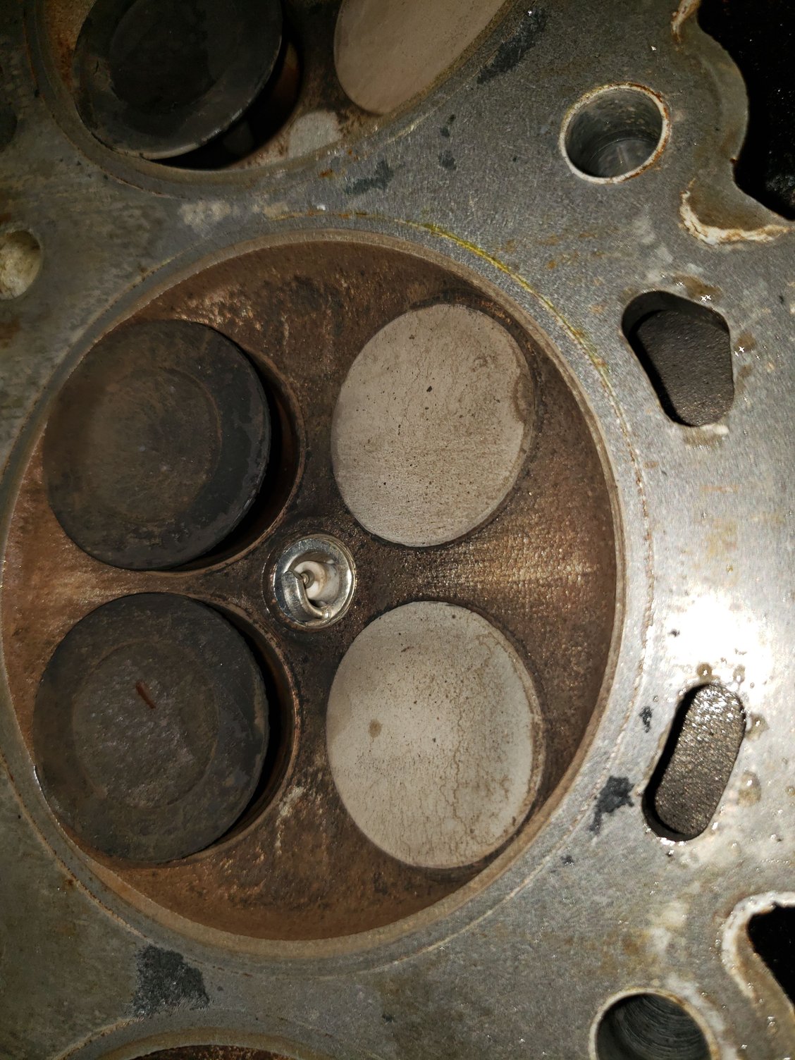

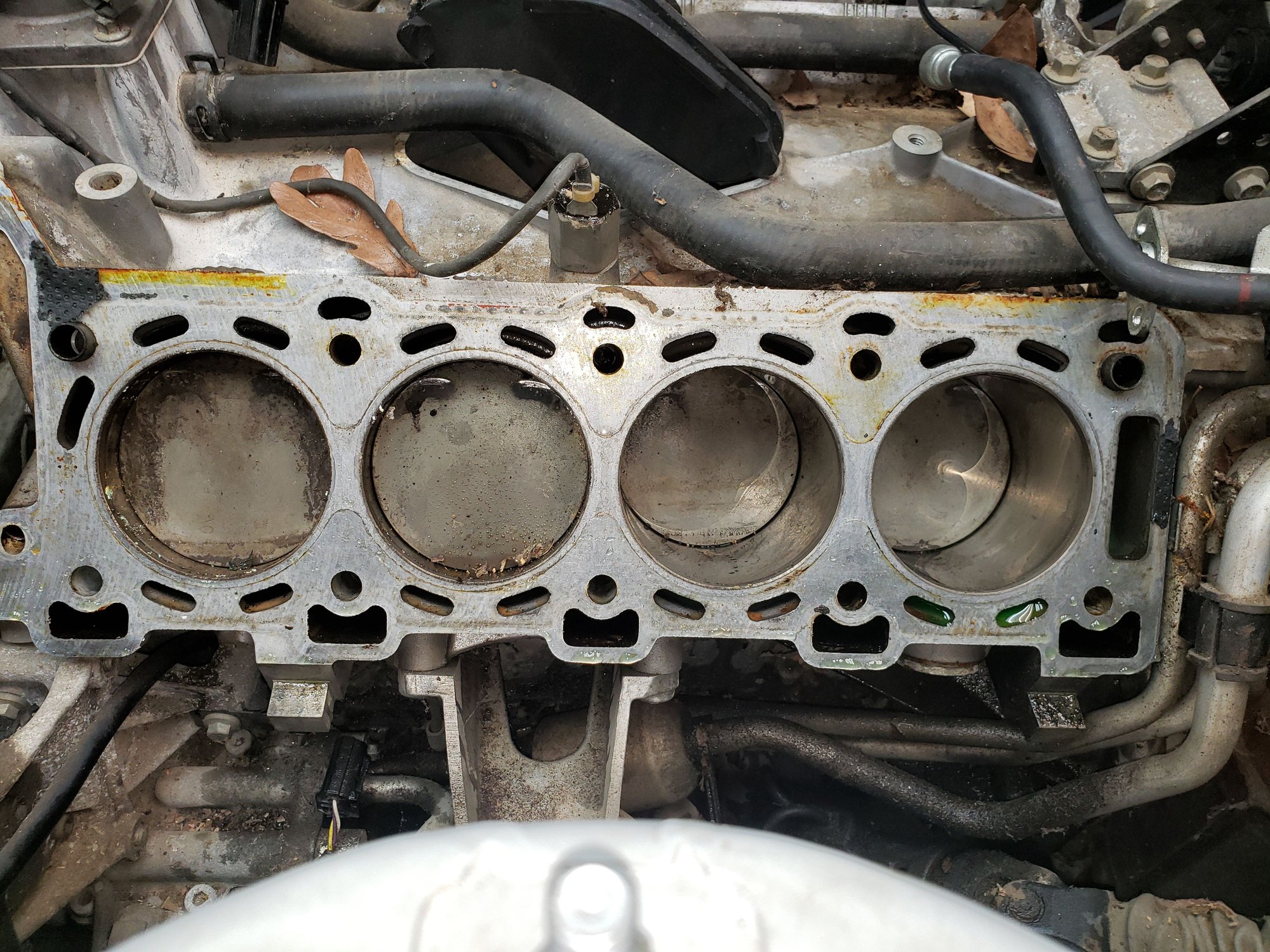

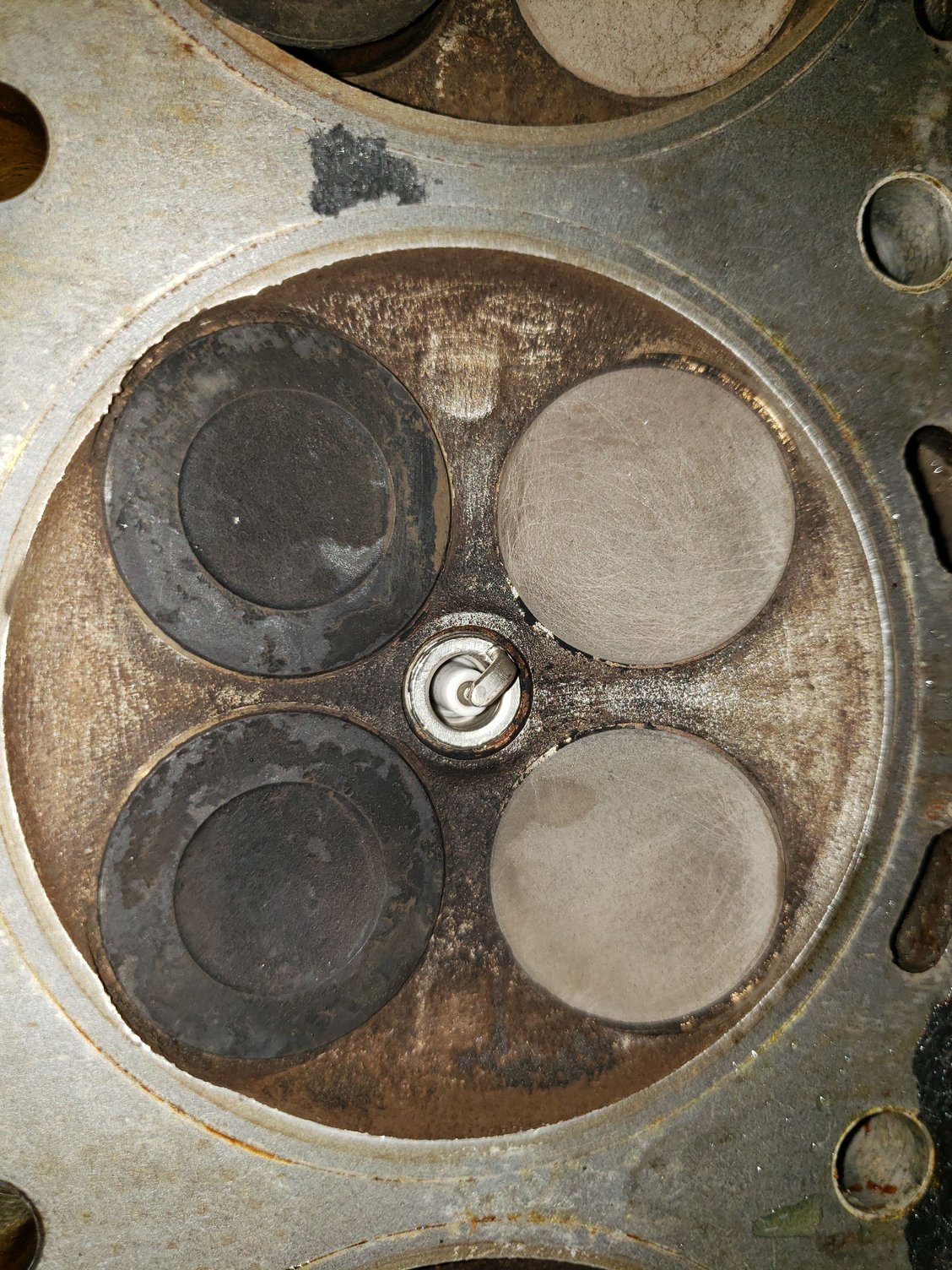

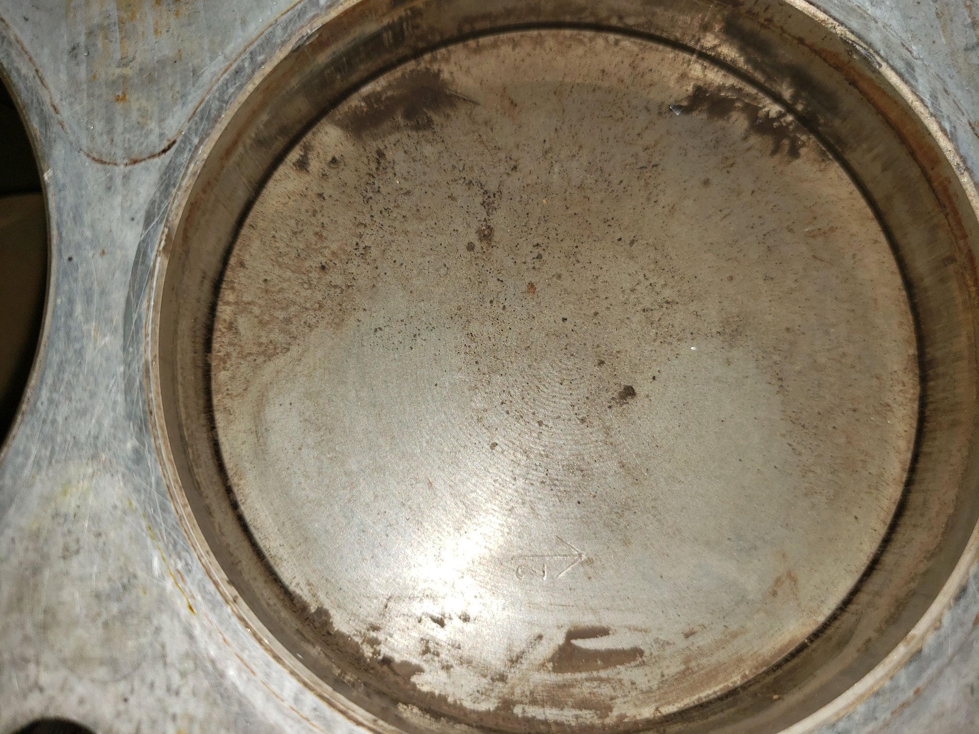

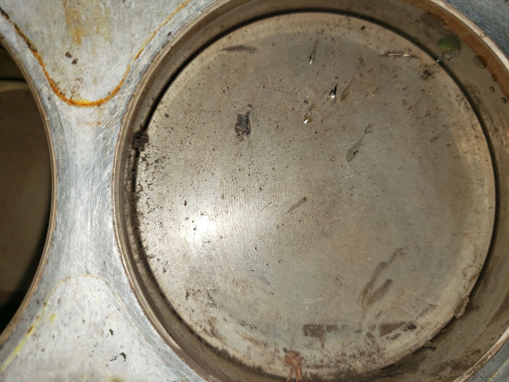

Aug 11, 2019 | 11:53 AM
Update!!

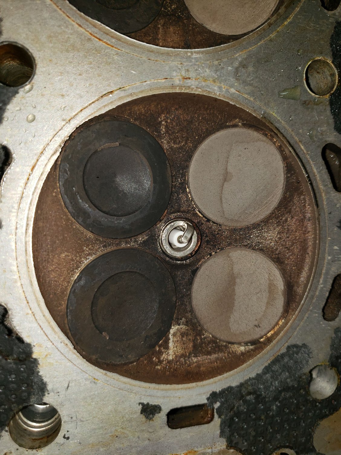

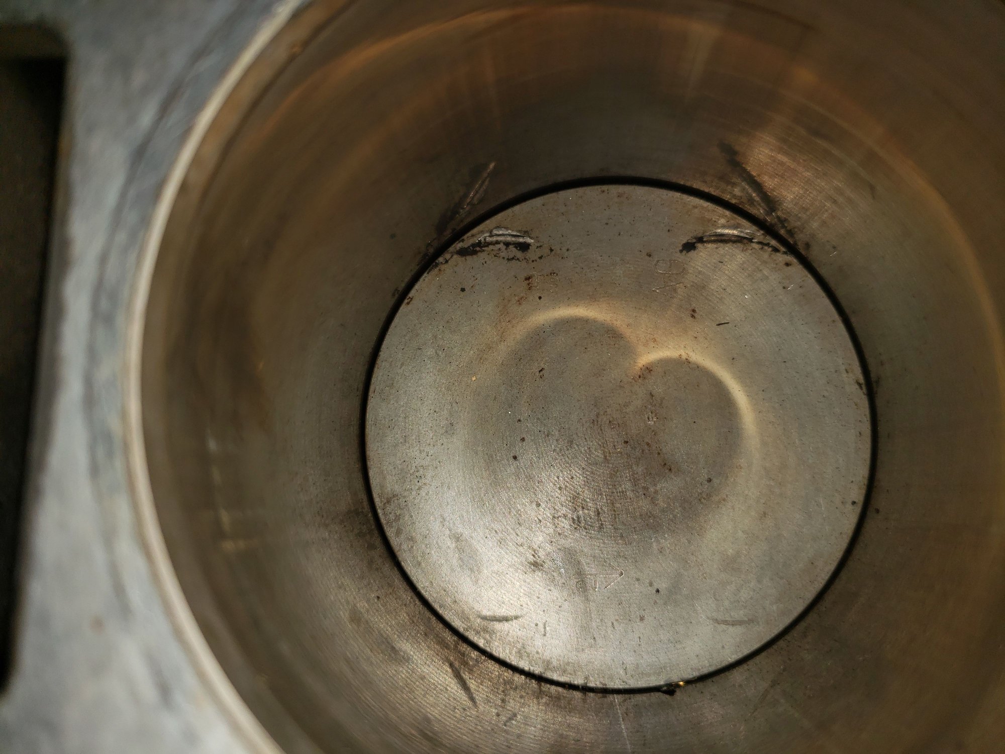

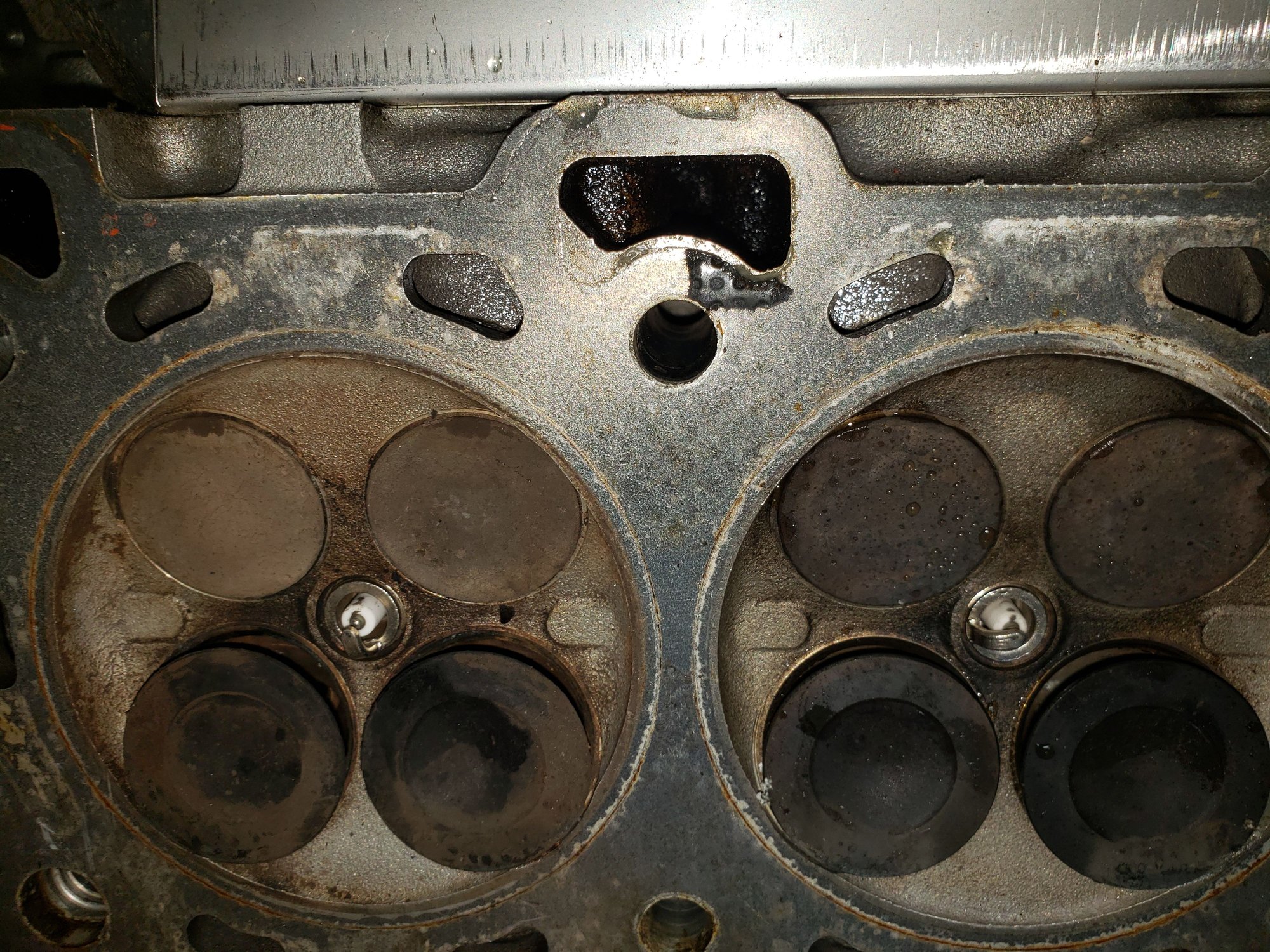

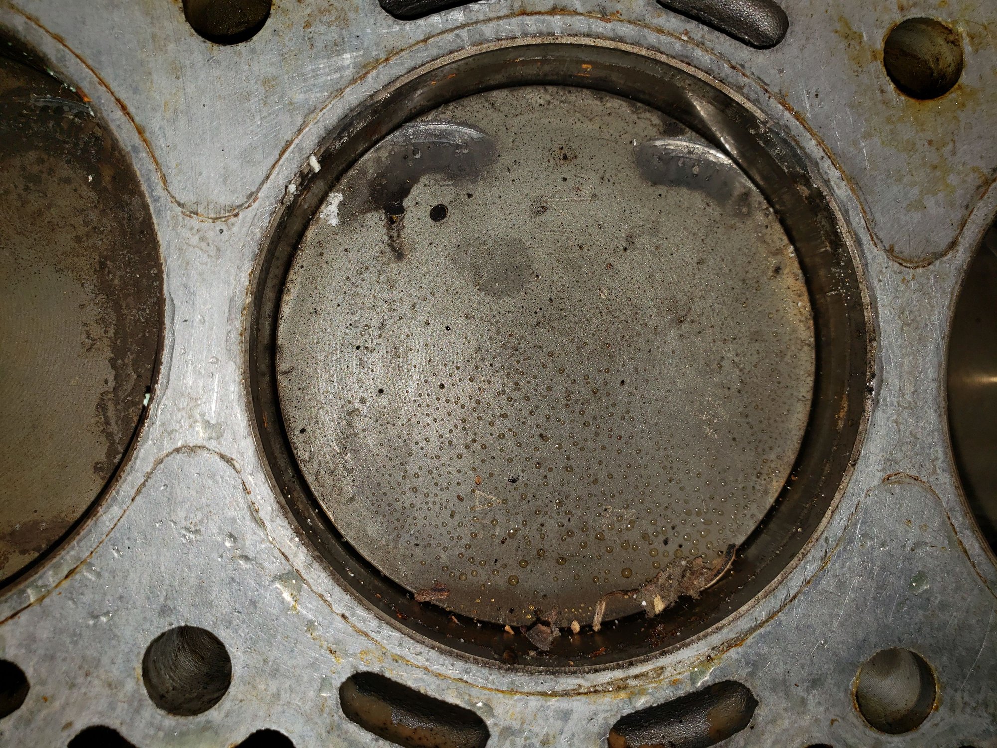

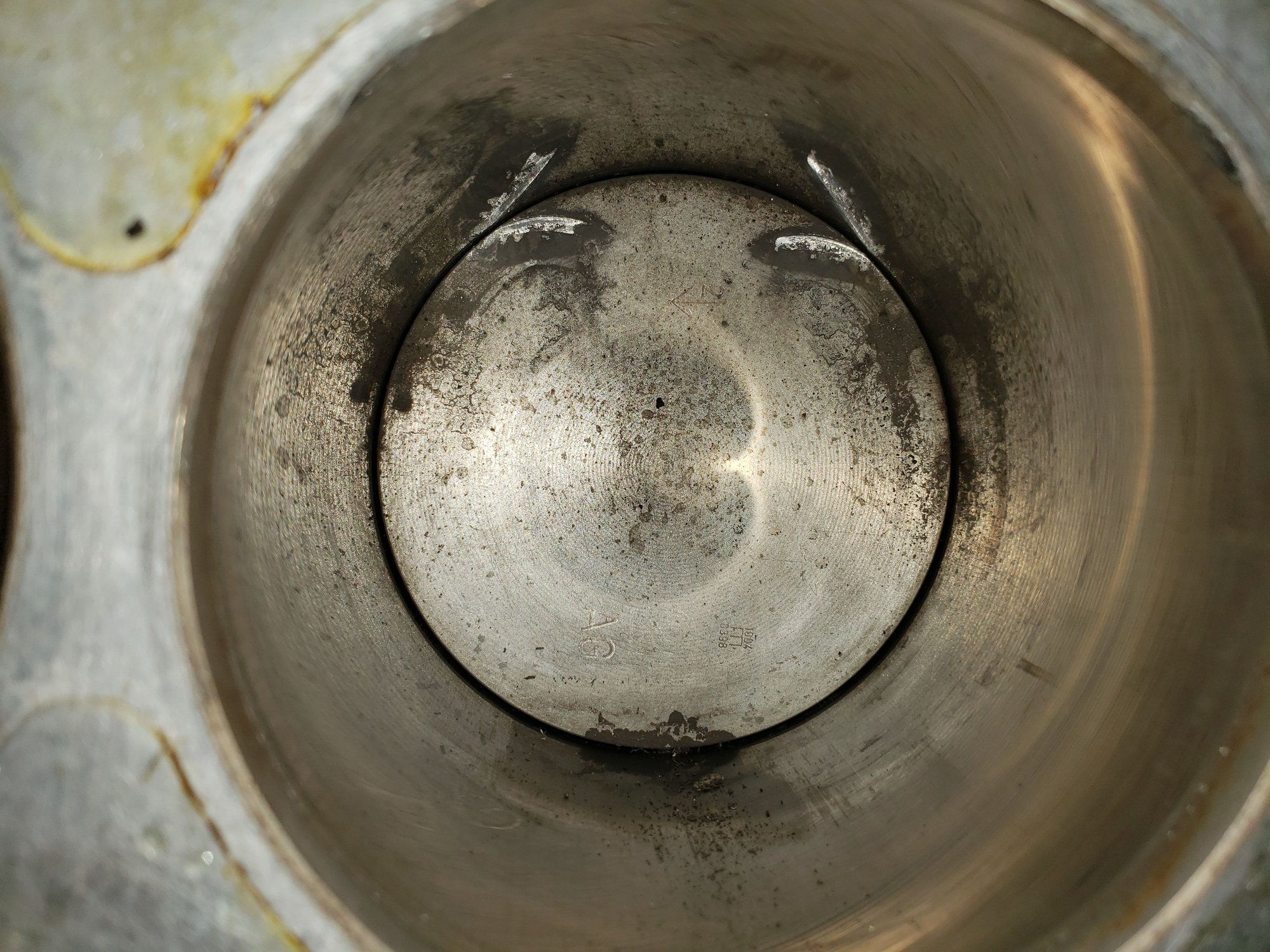

So I went ahead and pulled the cylinder heads. Looks like I've got some bad damage on the pistons and valves... already looking online for another engine. I'll keep this one for a living room table like top gear 😁.

Aug 11, 2019 | 10:54 PM
OkieJagDad quote "Looks like I've got some bad damage on the pistons and valves... already looking online for another engine"
Yeah +1 on that, getting a new coffee table (glass topped of course) would be cool. But drain the oil first. LOL.
As the British would say "That engine's buggered!" Definite evidence that the valves had impacted on the pistons.
If you carried on digging, you'll probably find bent valve stems, cylinder wall scoring, piston rod cracks and probably big end damage. Geez! Don't you just love interference engines! As your engine was run with the camshafts "backwards," it's worth checking the air intake route including throttle body and air tunnel, PCV pipes too before installing the new engine.
Let us know what/where/how much this costs for a reconditioned AJ26 engine.
My 1999 XK8 came with an AJ26, but somewhere back in time got switched to a AJ-27 (no idea how - maybe a Nikasil related issue) - sign is that VVTs are vertical in the AJ27. So it's definitely possible to put a later engine on but not sure what the other fit up differences will be - maybe other more learned Forum members can chirp up.

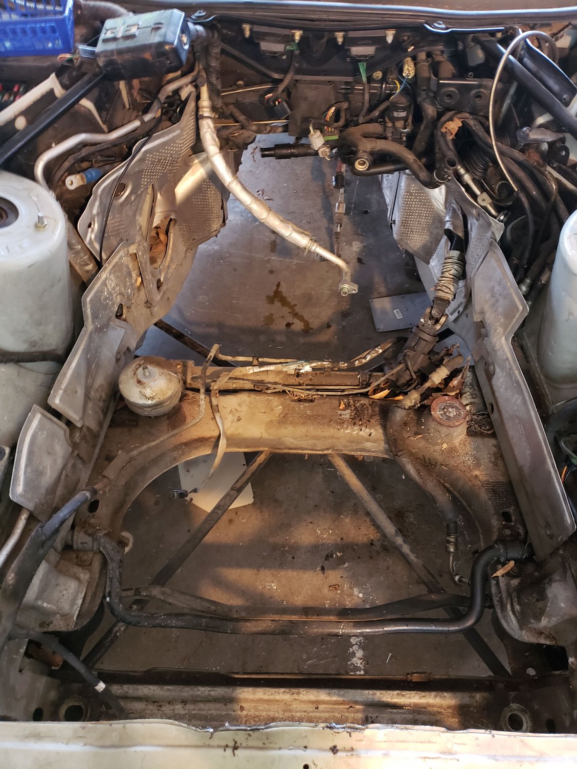

Aug 13, 2019 | 02:48 PM

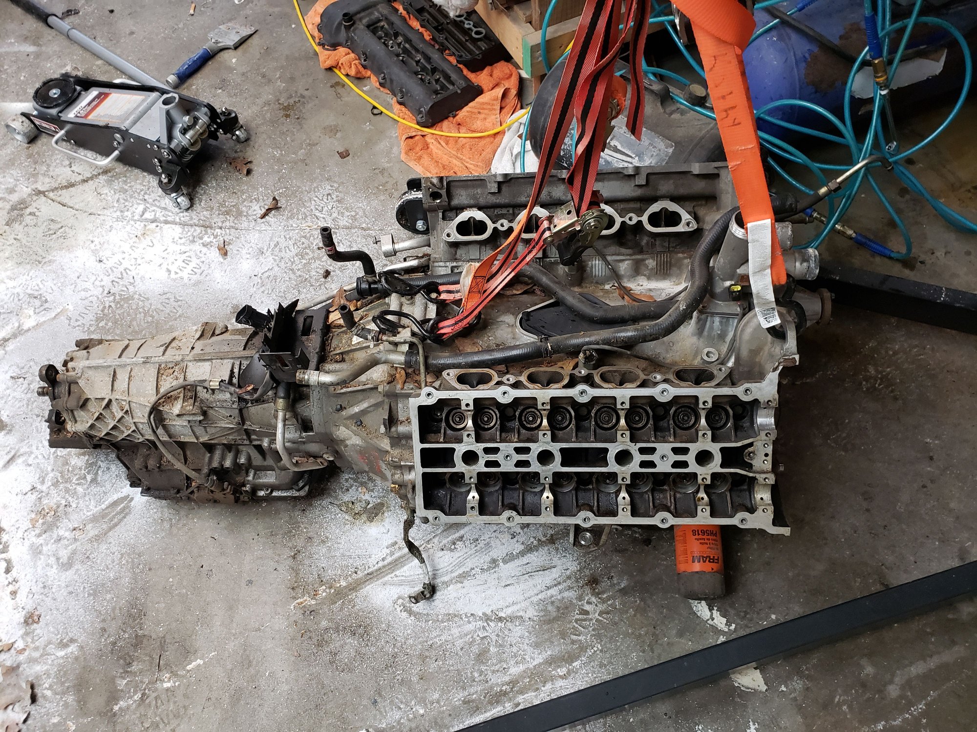

Pulled it!
Looks good! Just have to order the new engine and drop it in. Not sure if I want to go for a used or reconditioned engine.
Just used straps haha!
