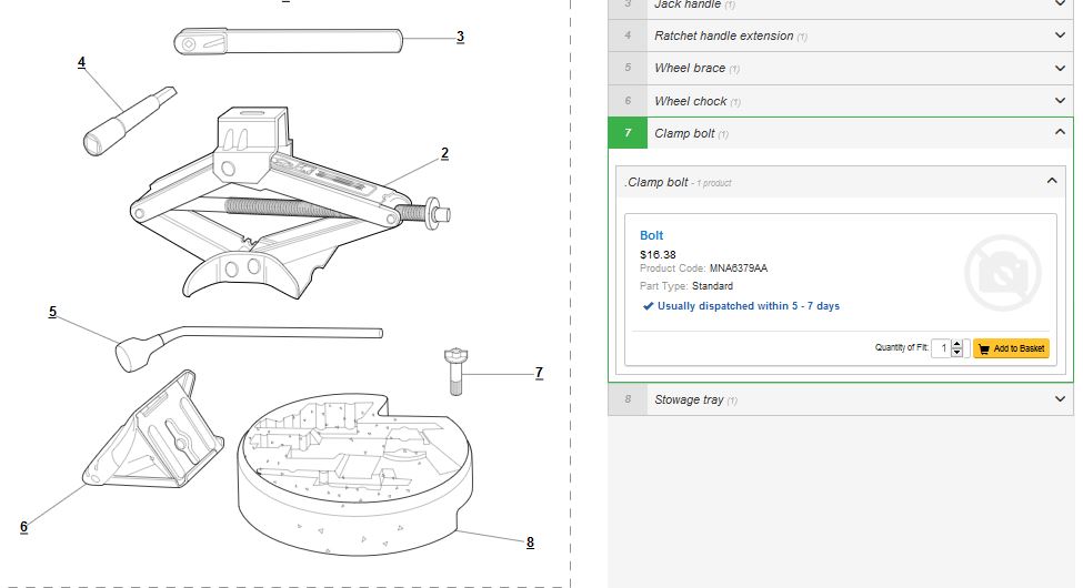

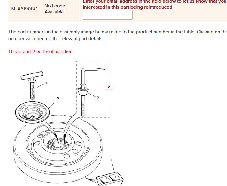

The 1997 - 2003 XK8 and the 1998 - 2003 XJ8 all use the same clamp bolt for the spare. Jagbits has a used one for $50.00 so I would start hitting wrecking yards. The clamp bolt threads into the tool kit clamp bolt. I have attached pics and part numbers for both.
The tire clamp bolt is listed as no longer available at the sites where I look for parts.
Attached Thumbnails 1999 XK8 Spare tire tie down bolt size-tire-clamp-bolt.jpg   1999 XK8 Spare tire tie down bolt size-tool-clamp-bolt.jpg
