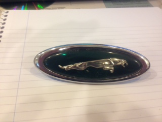

My emblem lost its leaper insert. I have acquired a replacement and wonder how the piece is attached to the passenger side fender? The chrome bezel is still there just missing the green insert. I guess there is access to the mount if I remove the inner fender cover? Or would the better method be to remove the insert from the replacement and silicone it in? If that is the case will heat release the adhesive? Thanks in advance for any comments or suggestions.

The one on the side of the car does have double face tape on it so the use of a hot air gun should help in the removal.

I found it on this site in the classifieds. autobohn kid has a couple of cars he is parting out. The heat gun approach did not yield the result I wanted. got it pretty hot but the emblem stayed put. I guess I will pull out the wheel liner and see if I can find the attachment point. good luck in your search

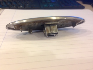

The emblem I have received has the chrome bezel. It appears that the whole thing would be secured by a clip on the inside. I have not had the chance to remove the wheel and liner to see if I can see it.

Could you post a picture of the backside ?

Here are a couple of pictures

If the one on the car is the same as the replacement you will need to push on the front of the emblem pushing to the rear of the vehicle and lifting the front at the same time.
A plastic putty knife should work well prying off the old one while pushing it to the rear.

Thanks. I can only guess that the one on the car is the same as the one on my desk. I hate to start prying not knowing for sure. Thanks

You can remove the wheel well liner and just about push it out from inside. The one I have has double face tape on it so the dental floss on the outside of the emblem will help.

Just Push the entire emblem toward the Rear of the Car and it will come out....

Sorry!!!...I went into my old supply of Jaguar Stuff and found (2) Red Leapers that came from my 1998 XK8.....I replaced them with Clear Lensed Repeater Lights....The Coupe had the Turn Signal wiring in the Fender-Well....So, I put in some Clear Lens Turn Signals on instead of the Leapers.....which have to be pushed toward the Front/Back to install or uninstall. The answer to your question about the removal/replacement of the Leapers is:
"They have sticky Tape on the back that holds them on ...Just replace the Two-Sided "Sticky Tape" and stick them back on"....Or..."Use some Clear Silicone or any color for that matter!" The Photo shows where the Tape should be placed (See Photo) You can see where the Tape was on your Photo but someone has removed it! ...
