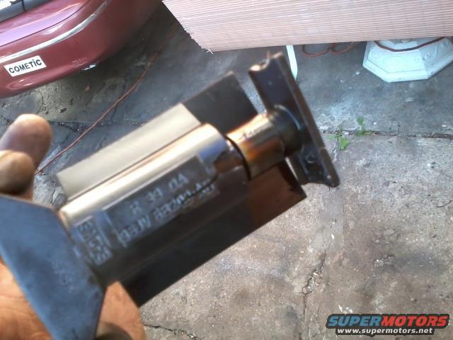

Originally Posted by Andymac
the dealer "couldn't find" reciepts of any work, I'm nervous about tensioners etc,
apart from taking off the cam covers is there any other way to find out if I need to change them
no, my engine was silent with a heavily cracked unit.
A valve cover gasket change revealed its failure.
