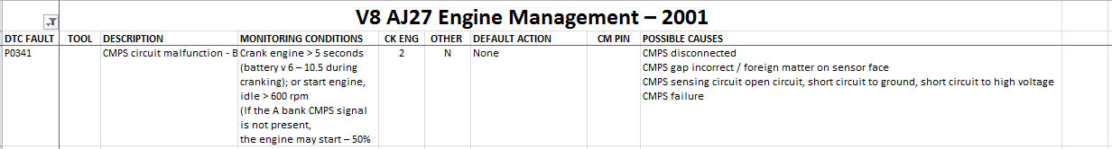

Here's the DTC text:
It's worth double-checking all the various loom connections you've had to undo.
