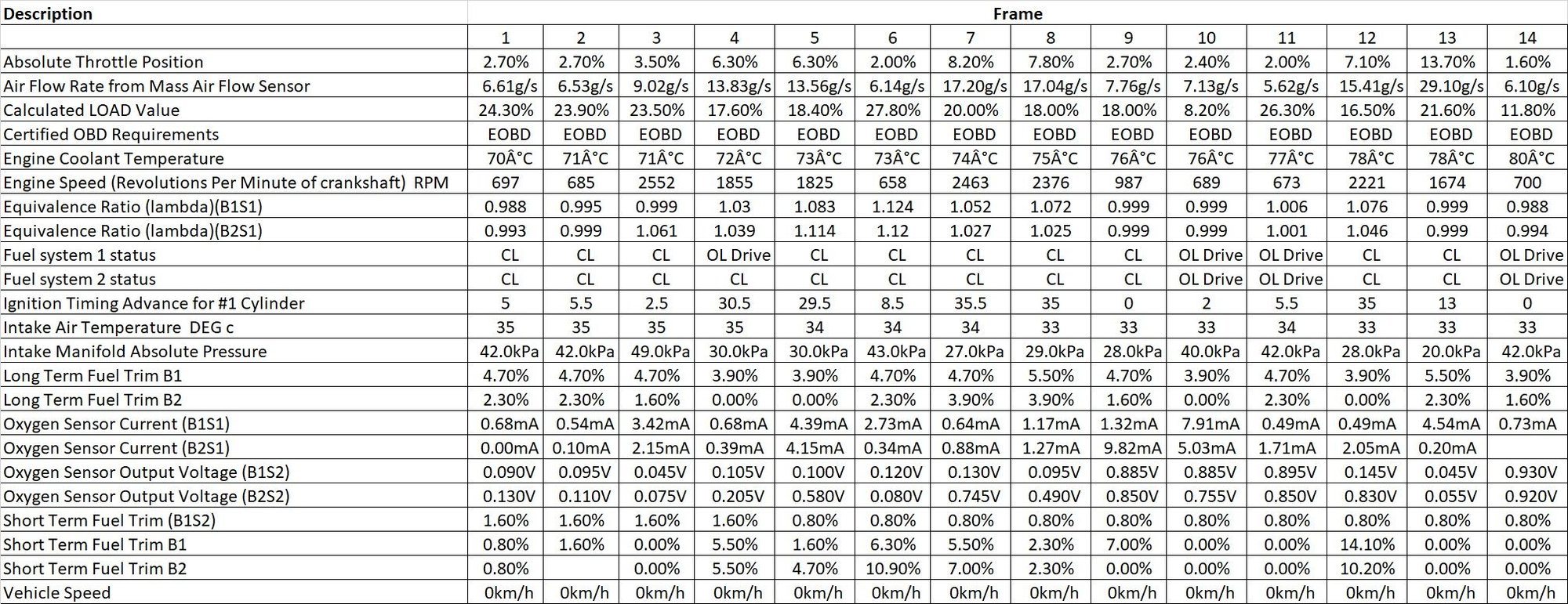

I went out armed with my laptop yesterday and connected up to the XKR with the Mongoose and fired up SDD/IDS 130. This was a fairly recent install as my previous surface pro died a few months ago and I’d only installed the VMs a few weeks ago and tested SDD on my x350.
Anyway of course nothing worked as expected, SDD informs you the car is too old and tries to fire up legacy IDS which fails to work. The IDS 125 vm connects but is hugely unstable and hangs and crashes. I vaguely remember spending quite a lot of time getting IDS to work acceptably with my mongoose so I will have to try to remember what I did!
So I grabbed my iCarsoft and gave that a go At capturing some info- I spent more time formatting it in excel than capturing it! (Must write some macros for next time) I thought I’d share the data…bearing mind it’s taken on the drive in park with mainly at idle with a few throttle changes.
sadly nothing labelled as MAF data
any comments?

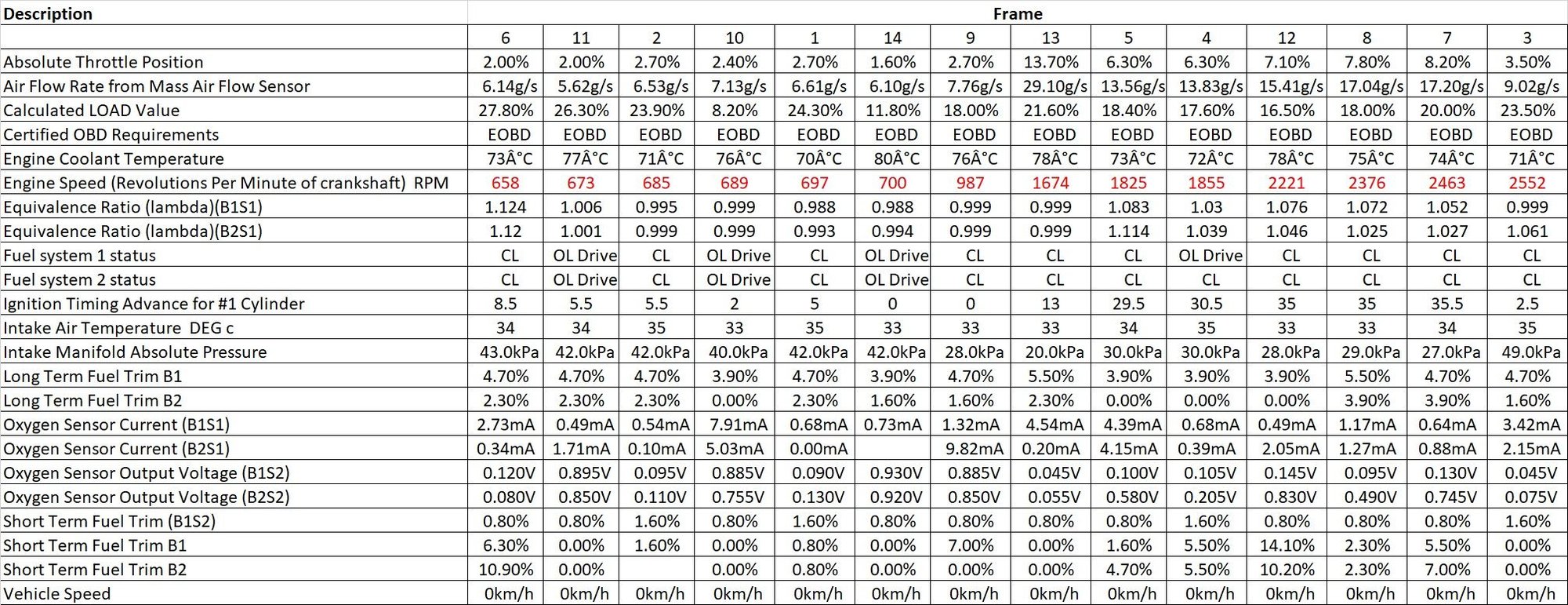

..and with the data sorted by RPM which may help more

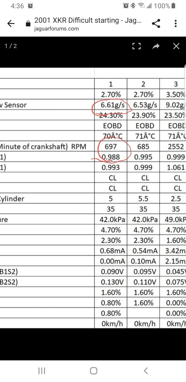

I think your MAF is reading high for this RPM...?
But at the same time I don't think the car was up ta temp...?
Looking again at 2500+ RPMs (without load I presume) the MAF is reading just 9g...
I want to hear what other folks think...
My car was warmer/hotter with these numbers (just read).
No load - in P foot on gas.
2000rmps
MAF just under 13g (yours is 2500rmps - 9g)
I think you might clean the MAF or replace
