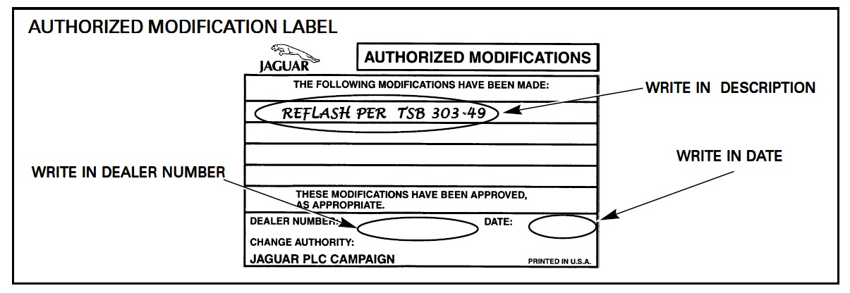

Can't help with the TSB - but if it has been done there should be a label
Enter your dealer number and the date on the Authorized Modification Label as shown
Write in “Reflash per TSB 303-49.” Apply the label to the driver side B-post below the door striker plate on XK8 vehicles, and next to the left hood hinge on V8 XJ Series. Be sure to apply the clear protective sheet over the label.

As Steve says, if it has been reflashed, there should be a confirmation label attached.

And thanks steveinfrance and GGG for the info on TSB 303-49. I did not find the confirmation label. I also called the Jag dealer where I know the vehicle has had service, and many TSB’s were listed, but TSB 303-49 was not listed as being done. The TSB information is very general though, it doesn’t mention exactly what the calibration is which would tell us for sure, but there is the connection between the Engine Control Module (ECM) and Transmission Control Module (TCM) in the TSB. I asked the service manager about more details, and he said that he believed it has something to do with the calibration of the sensor or slider locations and which gear the ECM thought it was supposed to be in. Other than that, he said he knows as much as we do from the limited details in the TSB.
