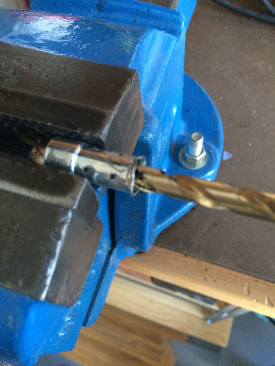

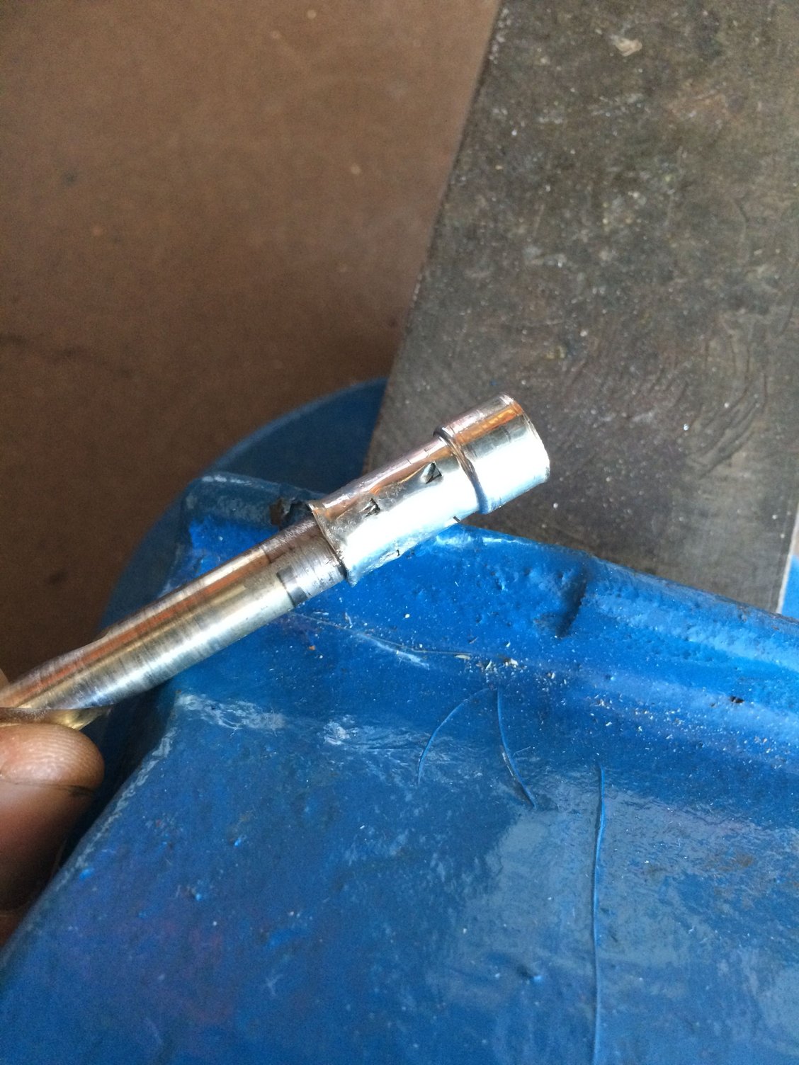

This is a great way to do it. I took the other route and shortened the cable jacket by removing the end cap. I measured off 14mm from the end cap, cut very close to the end cap, dug out the old jacket material and shoved the cap back on up to my 14mm marking.
Once you cut the end cap off, it takes some doing to clean out the old plastic jacketing. There are multiple retention tabs pierced into the cap that grab the jacket. I used a drill, awl, hammer, and needle-nose pliers to dig the black plastic out of there.
Just thought it would be good to tap down those triangular retention tabs so I put a drill bit into the cap and lightly tapped them flat
After tapping them flat, insert the now shortened cable into the end cap
Tap the retention tabs in using a sharp instrument such as an awl
Reinsert the drive cable with the longer crimped end toward the electric motor
